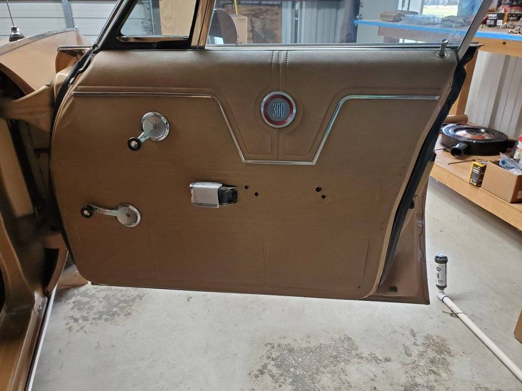

Passenger door lock will not work. Need to remove interior door panel. How is that done? Besides removing the window cranks and door pull, what type of clips, etc. are used? Any photos of the backside to see what I'm working with?
Thx

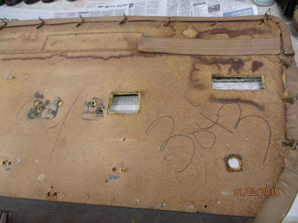

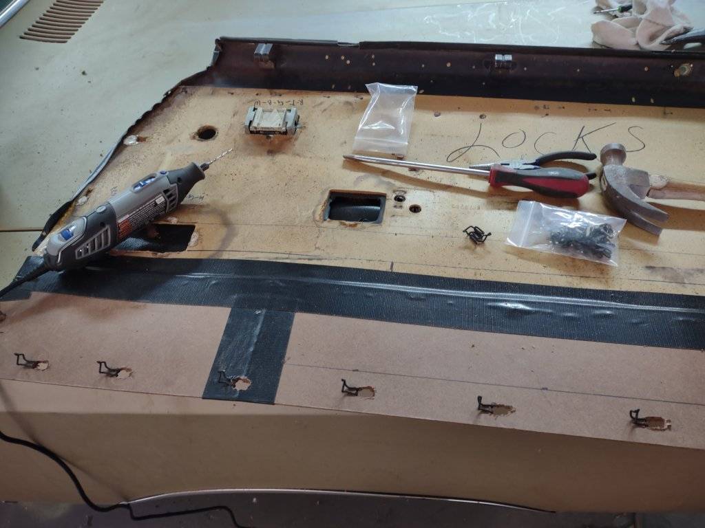

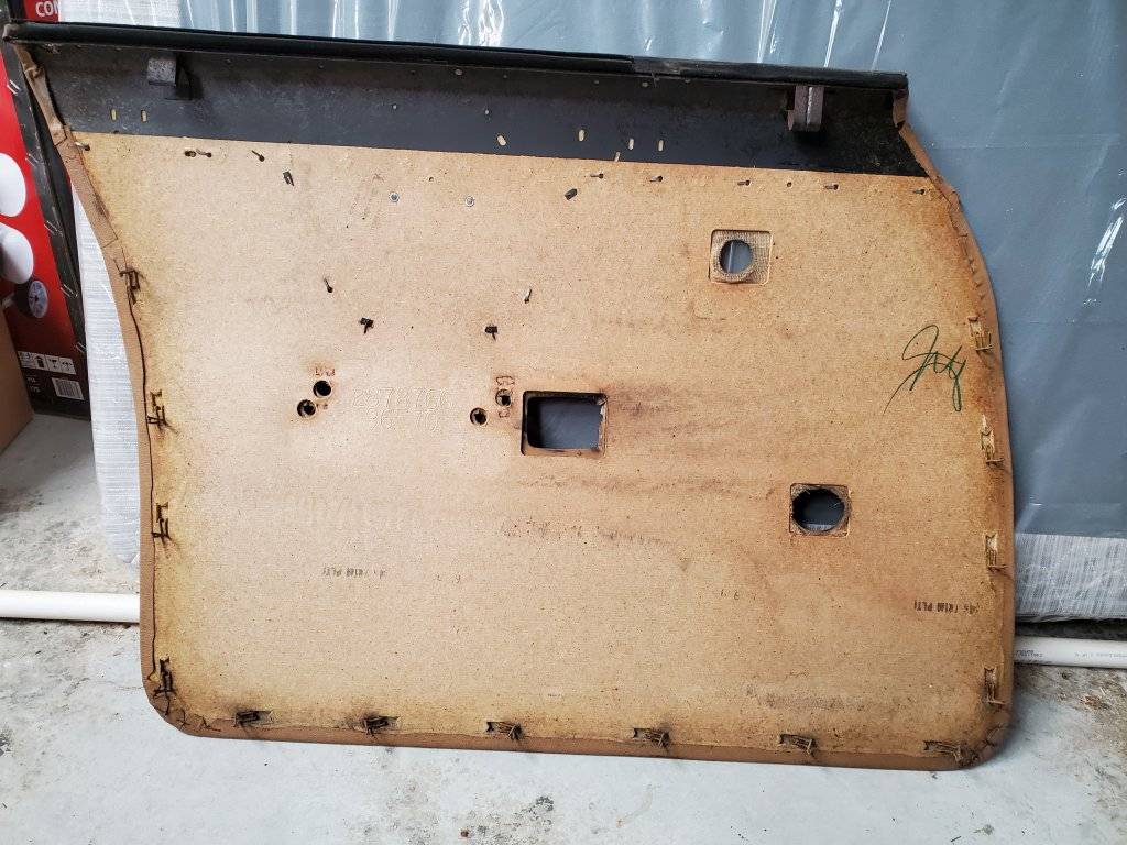

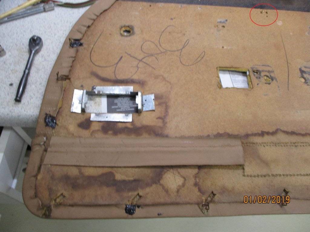

You're working with crappy cardboard and spring clips that fit into it. Starting at the bottom, use a plastic trim removal tool (or a dreadful putty knife) placed as close to a clip as you can get it (so as not to tear the crappy carboard, which you WILL do) and simply pry it out. Then work up each side.
When the clips inevitably come out of the crappy cardboard, use JB Weld to cement them back in place EXACTLY how it was.

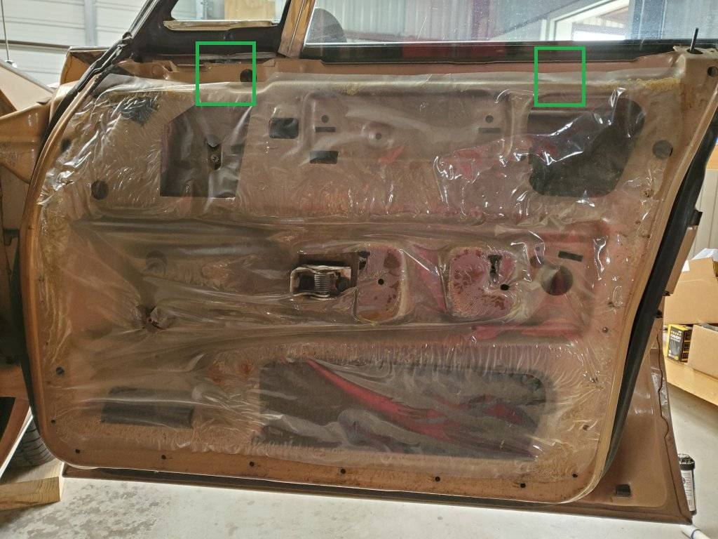

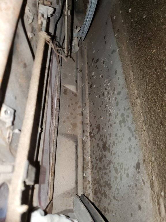

And when you replace or refit the plastic sheet, make sure you tuck the bottom edge of it INTO the slot on the door - this allows any water that hits the side of the plastic to drain properly into the bottom of the door and out the drain holes in the door, rather than onto the interior carpet and rust out the floor.

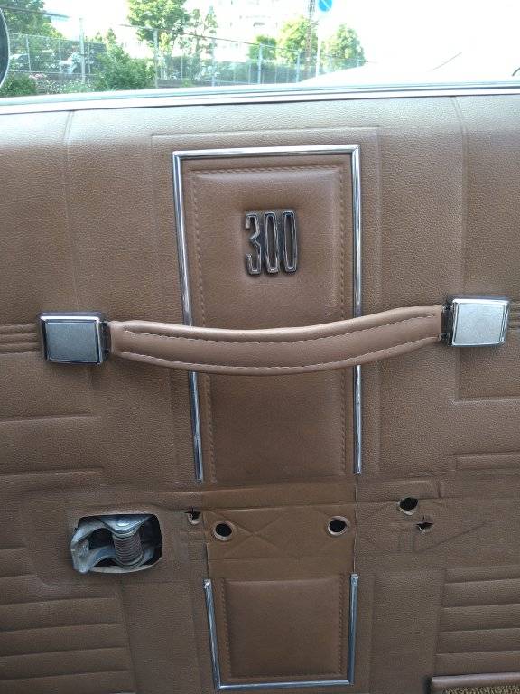

Hello.
Please teach me how to remove thus parts.
My hurst don't works passenger side's power window smooth.
Try to 70 300 hurst door panel, so I removed around clips.
But, don't panel off.
I think the parts fix door frame, but don't find clip or bolts.
Could you teach something?
(I'm Japanese, so cannnot speak English. Sorry for my Bad English...)

Hello.

Your English is better than our Japanese, so we're good!

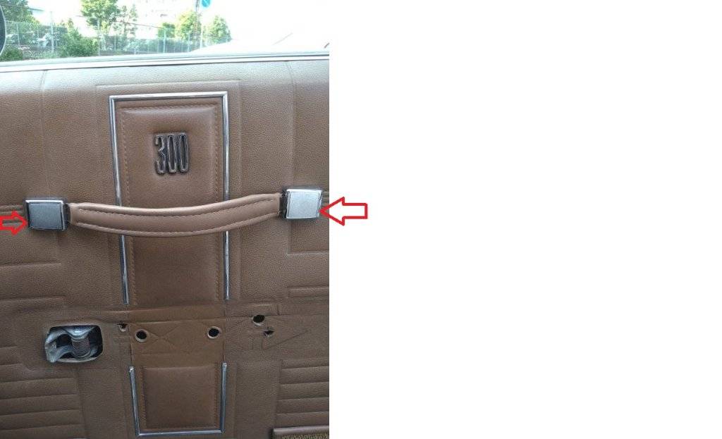

To take these off, gently pry on the outside, where the red arrows are in this picture. Once those are off, you'll see how it unscrews.

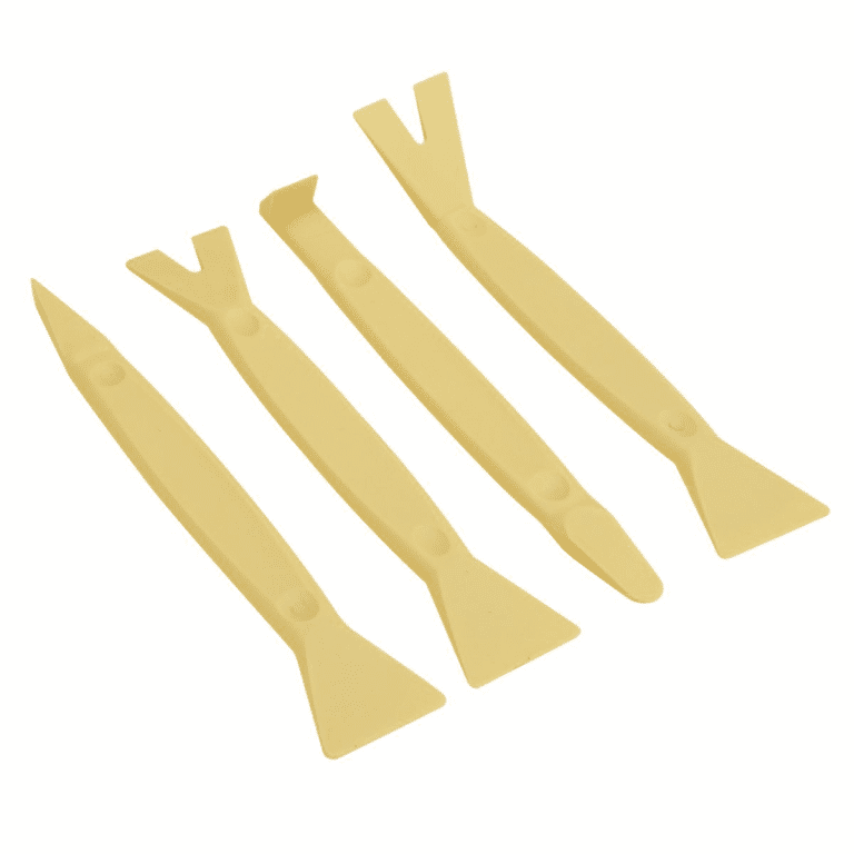

Use something like this to pry the chrome parts off.

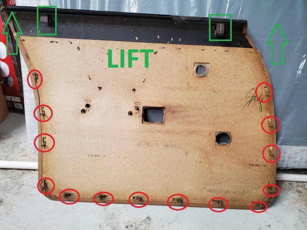

When all of the clips are loose you must lift the panel straight up.
