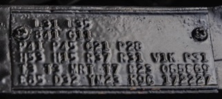

looks like it was T3 Bronze mist originally with MRT dark saddle interior and V1K Walnut vinyl roof

YM23K9C172227 looks great. Would have wanted it in the original T3.

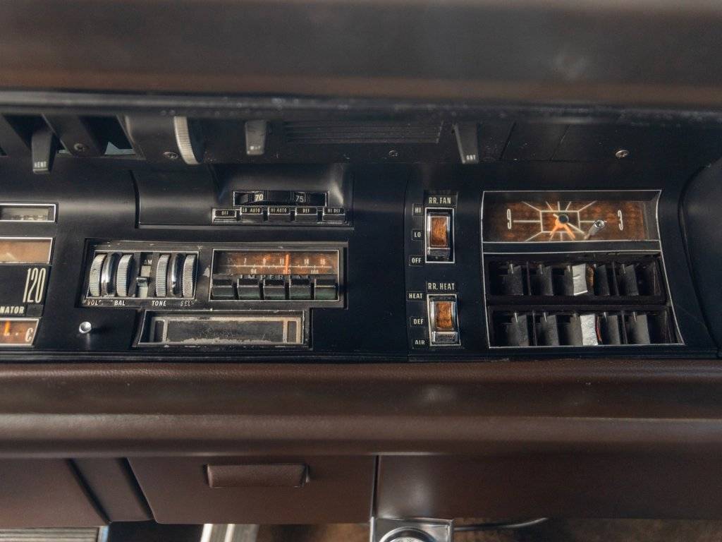

Actually one other item does the ‘Sentinel’ light dash surround look crooked to anyone? They may have been this way, but again, if it came off and someone put it back on, take time and do it correctly.

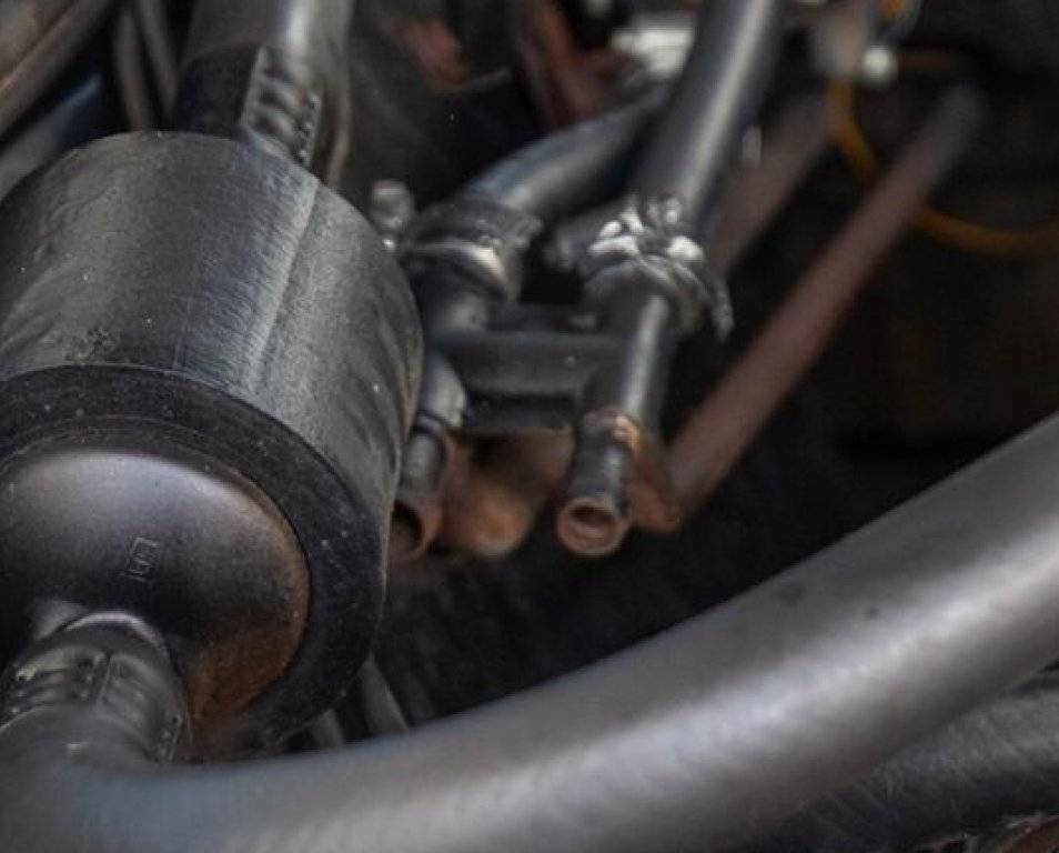

Didn't anyone notice this as not right? Isn't the heater an integral part of the Auto Temp?
Good eye, there are no heater hoses connected! The hose(s) that can be seen in another image emanating from the water pump probably just form a loop. So most likely the heater core is leaking?
The part seen in tet picture above is the tapping where coolant is routed to the (optional) rear heater unit. The 1969 Auto Temp I heater valve can be seen in the background.
