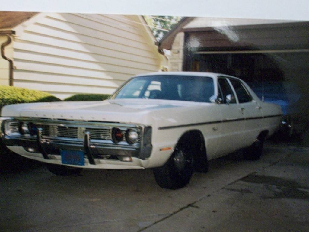

What is your timetable? are you going to drive the '70 before the transplant? If so Quaden Mopar show in Ocauchee June 4 then take the same day to the Graduation Car Show in Jefferson. My '70 Fury III ex-squad is below not to far away from you. Good Luck.
Really cool! It should be one of the fastest C-bodies around when completed. You may want to consider the Firm Feel Suspension and Steering Kit $4K. I have a 1972 with a 560 HP Stroked 440 and new suspension that is dangerously close to becoming road reading after 20 months of revitalization - good luck with your project!! It should be a fun ride
What is your timetable? are you going to drive the '70 before the transplant? If so Quaden Mopar show in Ocauchee June 4 then take the same day to the Graduation Car Show in Jefferson. My '70 Fury III ex-squad is below not to far away from you. Good Luck.View attachment 124348
