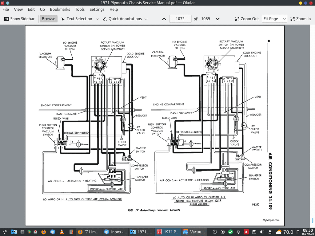

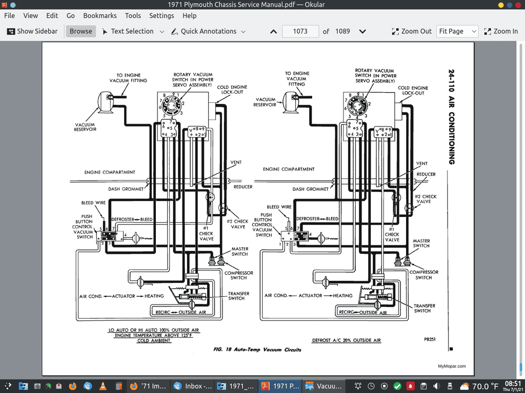

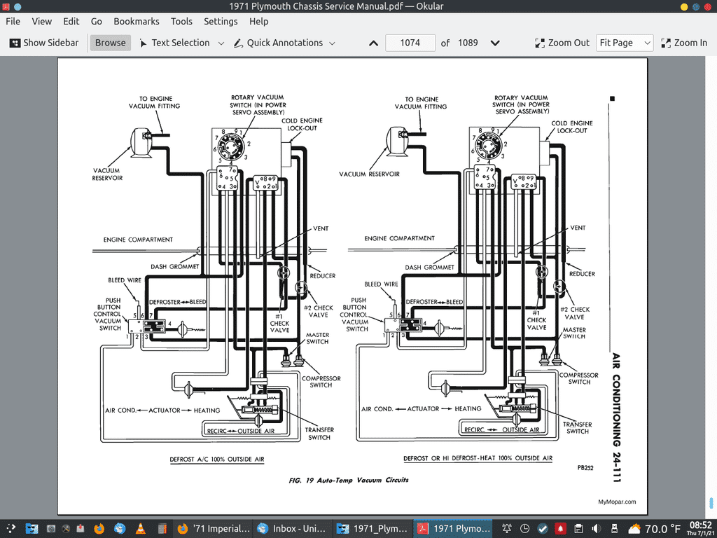

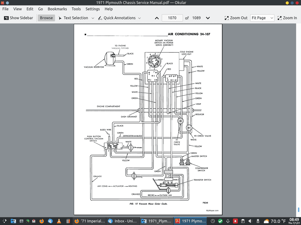

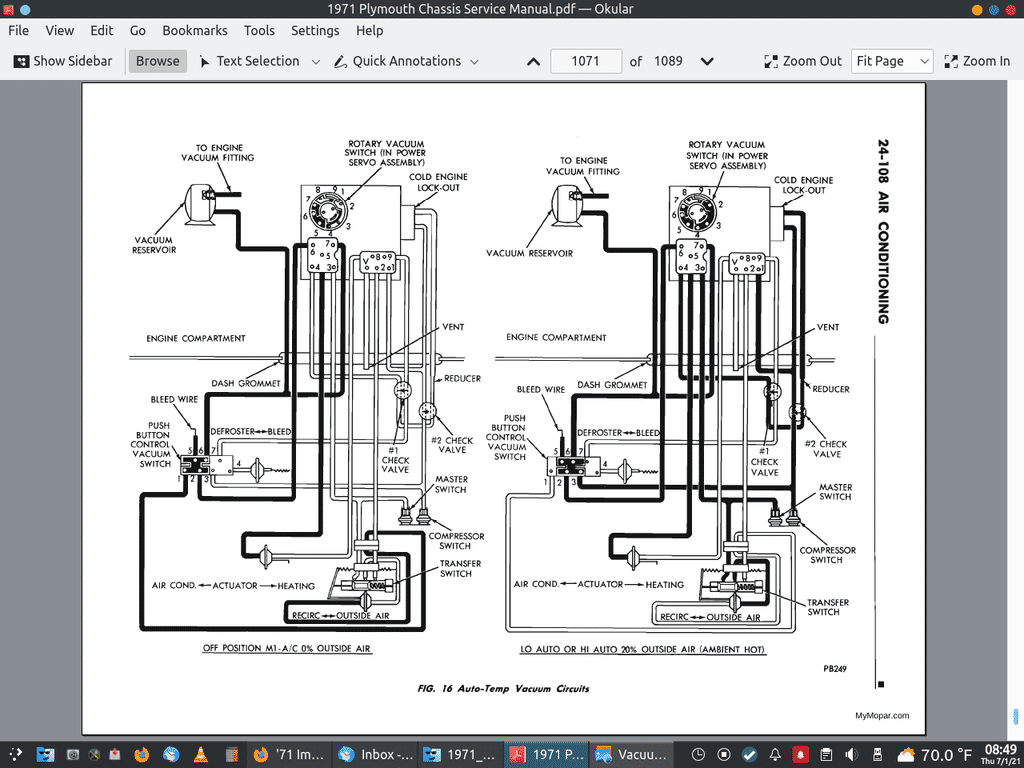

Good day fine Folks!
I'm helping a friend with 'un-repair' his 71 Imperial. It was a one elderly owner car until about 3 years ago, and apparently had only been serviced by someone qualified to work on Lawn Equipment or GM products. We are ALMOST finished with the poor thing!
Current issue is trying to replace all the Vacuum Hoses under the Hood. Does anyone have the under hood Vacuum Hose Routing Diagram? We would be so very thankful if someone can share that.
Thanks, Bruce
Thanks, Bruce
Pics please
Wow... That's awesome in there! Now I've got to wait until tomorrow morning while I'm all 'chipper' and study it with lots of coffee!
Thank you SO much!
Bruce
