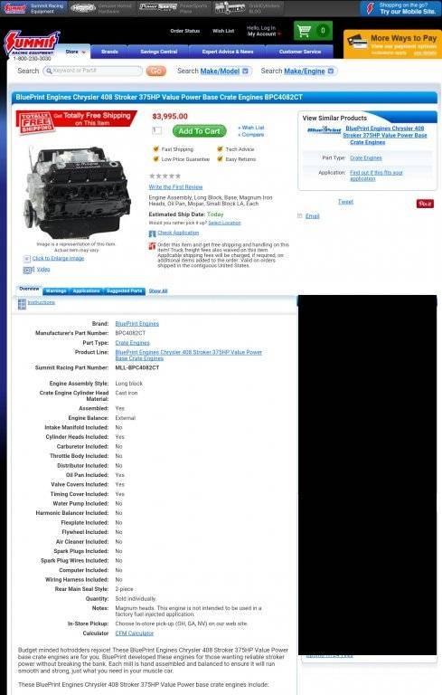

Thanks guys, I've thought it over and I'm leaning more towards BluePrint Engines Chrysler 408 Stroker 375HP Value Power Base Crate Engines BPC4082CT the 408 stroker is just really tempting for the money. It'll probably take me most of the summer to save up for the engine and still have a decent number in my savings account though. The magnum engine is nice, But I have a feeling it may end up costing more and not necessarily yielding the same results. I'd like to hear if anyone has any experience with these engines. The reviews seem somewhat positive, some people say the mopar performance engines are better but they are really expensive.

Thanks Commando, I was thinking the same thing. I'll probably order through summit for the free shipping. I wonder if I'll have to change the rear end on my car. Will the 8 1/4 be up to handling 375 horsepower? Also is that gross or net?
I also took a look at these, These are just a little more for a stroker 408 and seem to be held in a higher regard. They've been dyno'd and have a warrenty. Any thoughts? Chrysler Performance Crate Engines

Run the stock 8¼. Should be fine if you drive it with common sense. Should the day come that it does explode, deal with it then.
That 375 hp is at the flywheel on a test stand. Tweeked and tuned to the max under optimal conditions. 350hp at the flywheel can be expected with 290 of it making it to the rear wheels. That's why I'm thinking the 8¼ should be OK.

Thanks for the info, I haven't heard much about CME other than a recommendation on a B or A body forum where someone was telling this guy to steer clear of the Blueprint engines because they are hit or miss and the company has a bad record of customer service. That was almost 4 years ago though and the company is still around so many blueprint stepped it up in terms of quality and customer service. But then again CME is still around too and their website seems pretty impressive. Along with their warranty. I should ask CME if their horsepower rating is at the wheels or on a stand though, Thanks for bringing that up. Thats still quite a bit more than my old 360 is making at the wheel either way though. I'd be surprised if it was making 230 at the wheels, before the engine knock.
I like to imagine it makes more though lol.
Anyhow you think the warranty (12k miles or one year) and the dyno sheet is worth the extra money? They have a good rating with the BBB and even apologized to one dissatisfied customer who was only upset because it took a little too long for his tastes.
To be 100% honest, I haven't a clue on whether Jegs, Summit, CME, Pedro's, or the guy next door is the best source for a stroker SB.
You research as best as you can and roll the dice.
Google the crate motors and research them. Read the reviews. They will be mixed. And base your decision on what you feel comfortable with. I would go crate motor over the local machine shop. We built 2 360's in the late 90's and if I had it to over again I would have just went with the 360/380 horse Mopar Performance crate motors(no longer made).
Also keep in mind the Magnum is good way to go if your on a budget. Your looking at $4000-$5000 for the crate motor. You should be able to pick up a running 5.9 Mag for around $300-$500. The computer controlled fuel injection keeps the cylinders in very good shape. Cross hatch lines are still visible after 100,000 miles most of the time. Then you would just basically tear it down to a long block- remove all the fuel injection, intake manifold etc... Now the old 360/300 horse crate motors were the same as this 5.9 you will have. Only difference is a dual plane intake with a carb. Same cam, pistons etc... Need more power- the 380 horse version came with a different cam and a single plane intake. Heads were the same except for the springs and retainers. Intake will cost you around $250. And you have options for the cam, Bullet Cams can regrind the cam you have for around $150, or you can go with a new cam say from Hughes and your talking around $370. You can put the springs and retainers on there yourself and save a lot of money (could also have this done) Or go with a set of new heads that already have them installed. These heads will make more power than the stock heads. Your looking at around $1100-$1500 for the new heads depending on what you go with. Go to forabodiesonly and they have a section specifically for the Magnums and do some reading.
