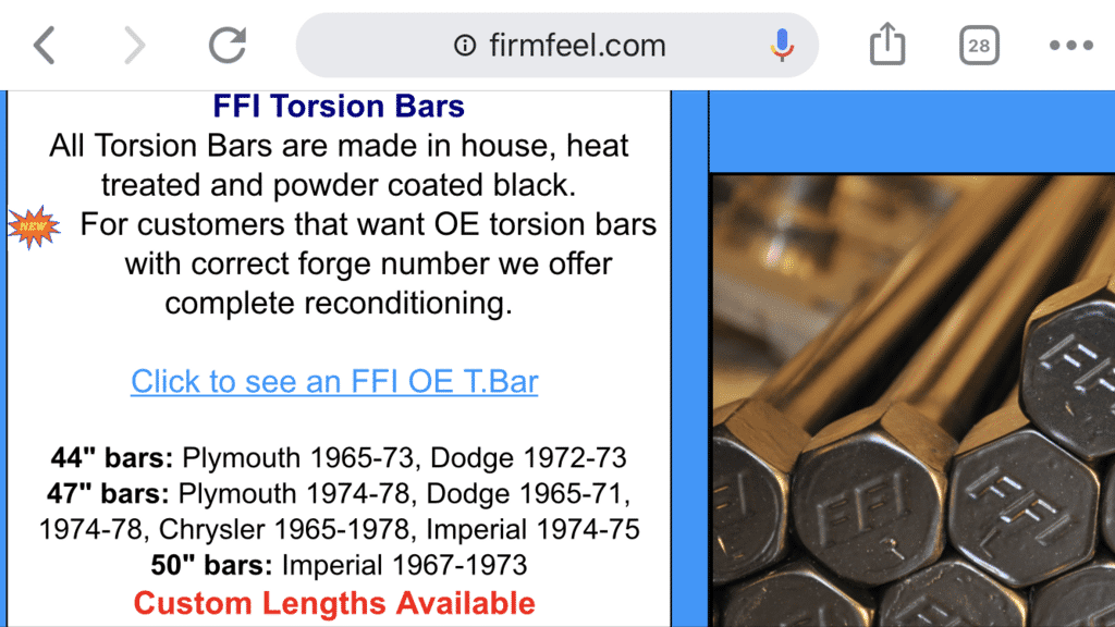

    A screenshot from Firm Feel web-page: 7DB61FC6-1F12-452F-B211-61040E5C00E6.png

    Firm feel told me there c body stuff wouldn’t work on an imperial.
    But I thought an imperial was just a stretched out C

    Pre-74 Imperials are pretty much their own from the firewall to the front bumper.

    I would assume that the 50” Torsion Bars would fit. The rest of their stuff propably don’t fit, as the front end parts of an Imperial are just slightly different.
