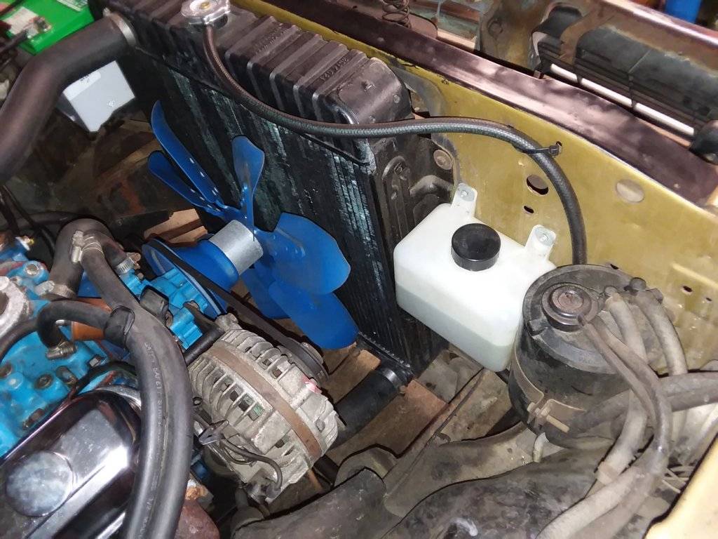

It looks like my 72 Fury III (no AC) came stock without a fan shroud. At least, I don't see any shroud mounts. Odd that it has a working coolant reservoir system and no fan shroud. When did the fan shroud become standard equipment for non-AC cars?

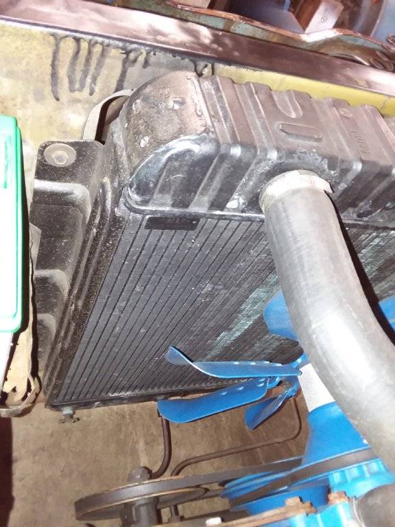

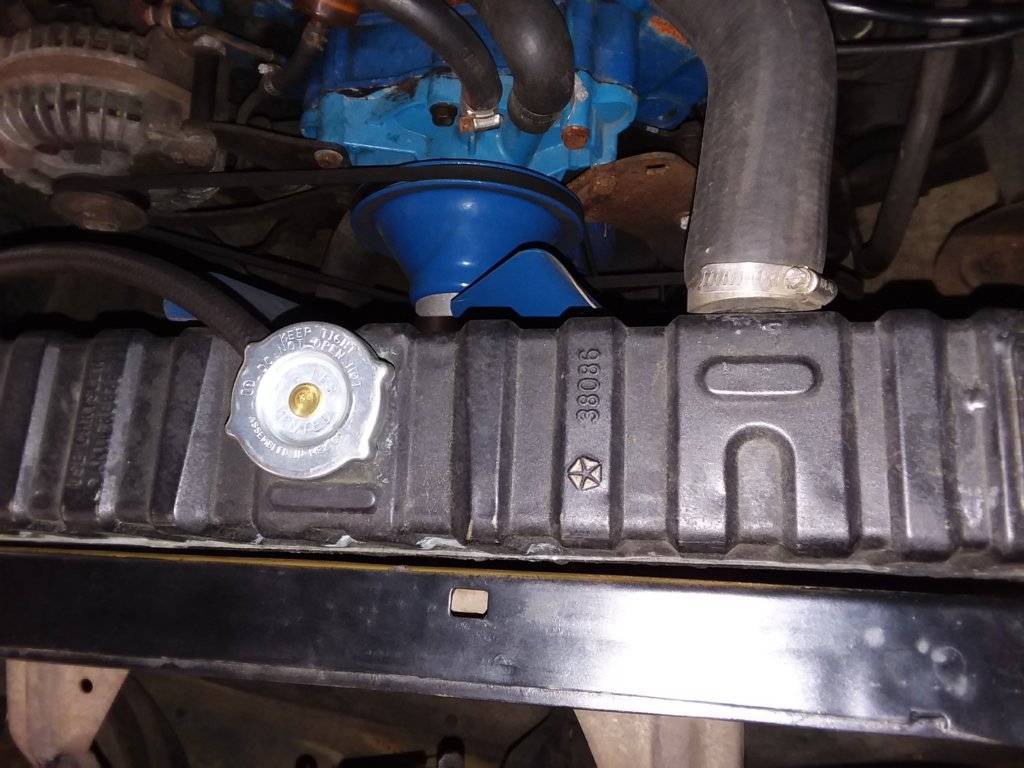

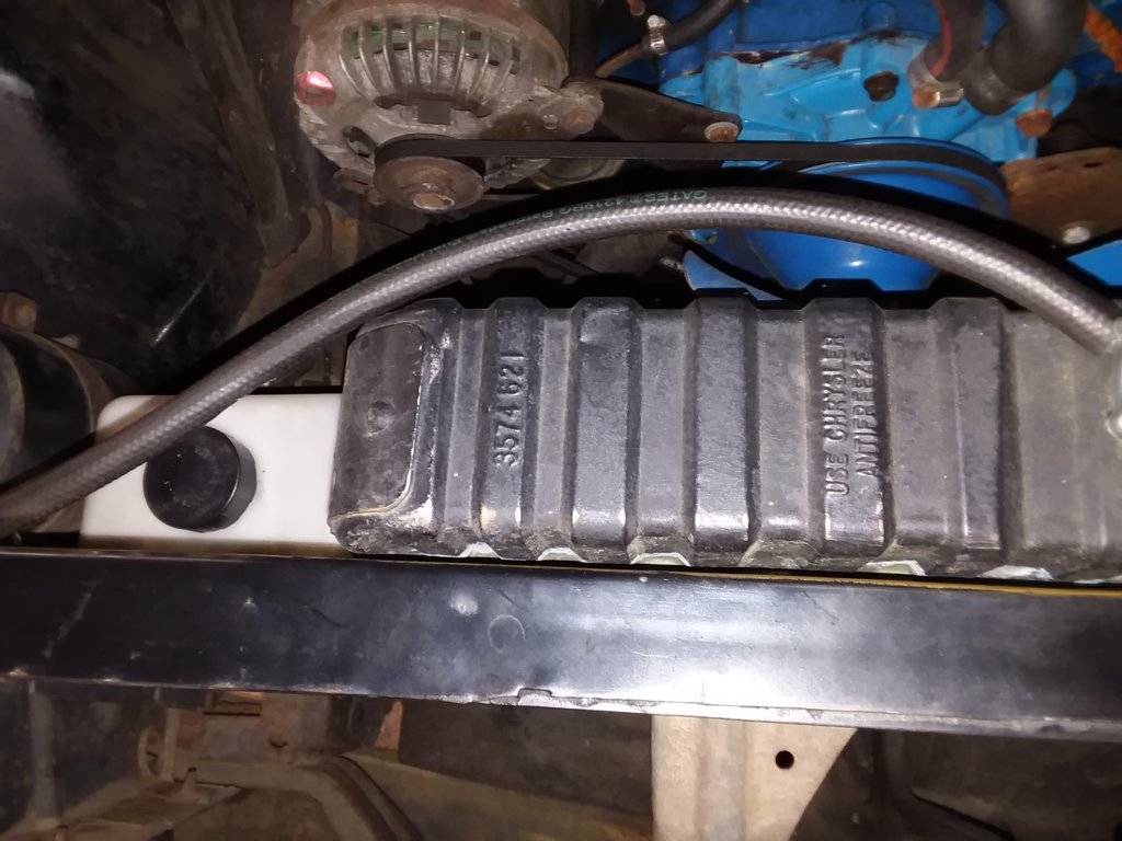

Hi CCAS, I've never seen a Chrysler radiator with no brackets for mounting a fan shroud. I was about to buy a shroud on ebay, checking my car to see if it matched, ... and no shroud mounts. Car is from Oregon, but manufactured Belvidere IL.

No. 12-4-18 Installed Champion EC2374 Aluminum Radiator, no shroud and no cooling problems even during 30 mile drives in 95° summer heat
