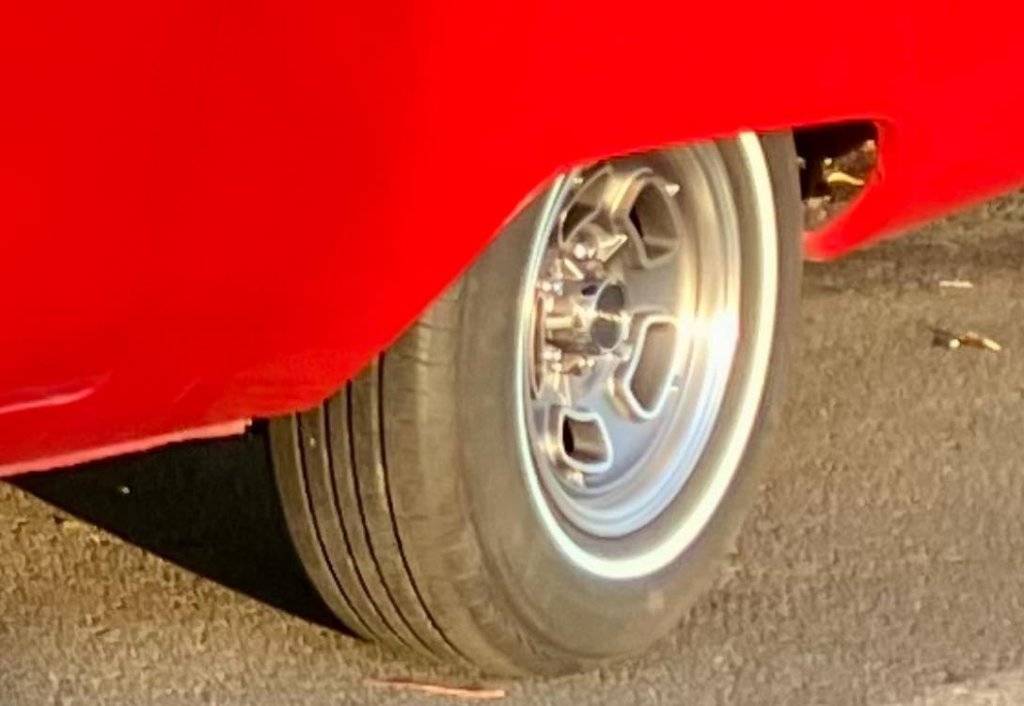

Recently installed 235/75/15 tires on my 72 Fury and had to unbolt shocks to drop axle down enough to fit wheel/tire. Lots of room in wheel well once installed. Removing previous 225/75/15 was tight too. Assuming this is not normal. What is correct compressed / extended length of the 72 Fury rear shocks? Compressed / extended 14" X 22.6" to 15.25" X 25" range is what Rock Auto shows. Mine has Bilstein and I forgot to measure when changing rubber.

I had a problem similar to this when putting 275's under the rear of mine. I used KYB KG5413 shocks for Dodge trucks. Extended is 24.45 and I have no problems removing the wheels now and it still rides nicely.
