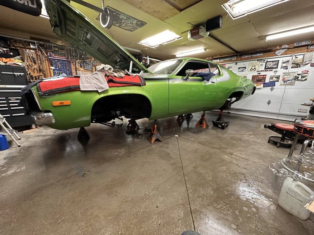

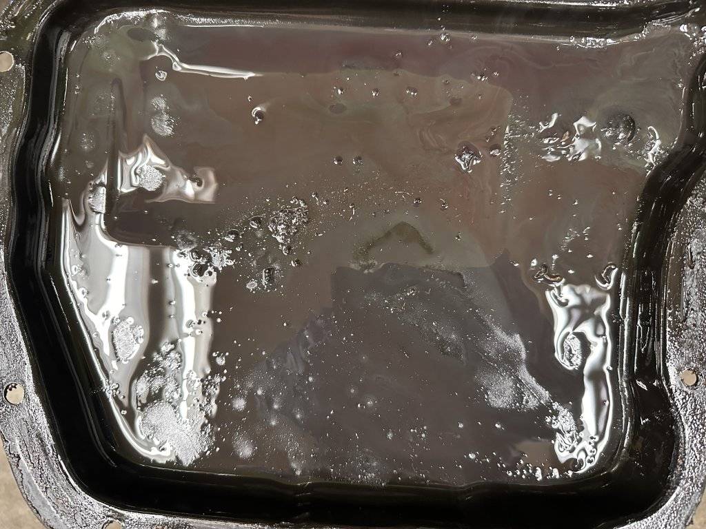

So I have a friend that bought a nice looking but in terrible mechanical condition Roadrunner. The transmission is shot, mud and flakes of glitter fill the pan. On top of, it would not move the car.
When it arrived it had no transmission fluid, all wheels seized, kick down/pressure linkage not connected, just a mess.

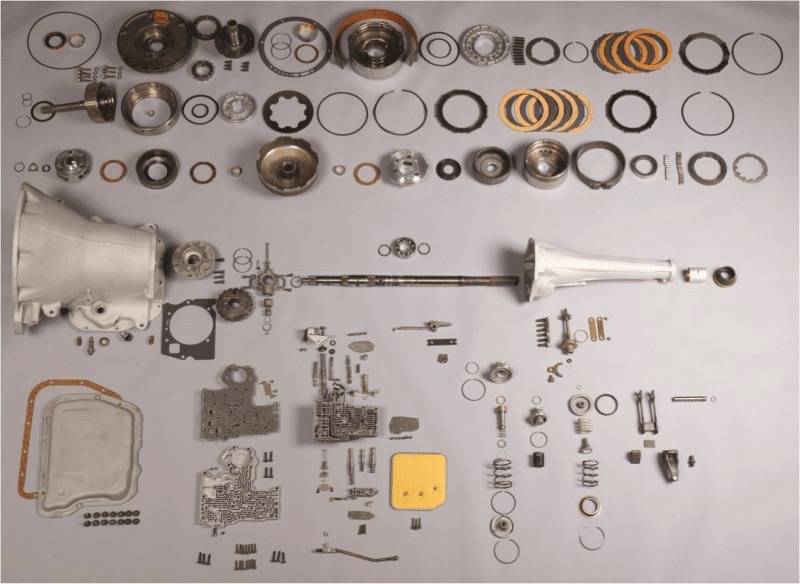

Now for a kit. I gave my parts guy a couple of numbers for rebuild kits, one of them a Raybestos master kit, he can't get any kits for 727.
My quickest shipping kit would be this Parts authority kit from rock auto. Looks like it has all the needed parts, packaged well. Any thoughts? I understand there are better trans shops available south of the border, but cross border shipping with smaller business can lead to long delays in arrival. Rock auto has pre-clearance and will be here in a couple of days.
