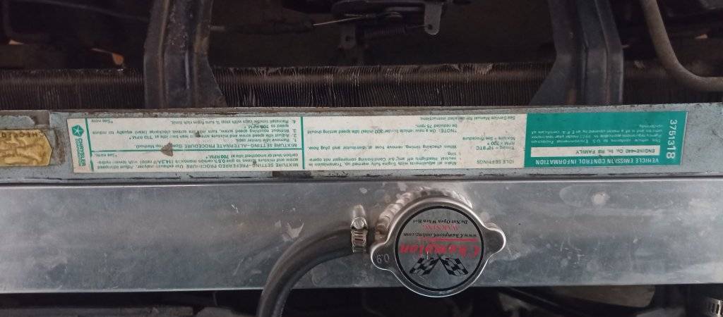

Seems like the idle speed is supposed to be closer to 700 rpm hot. Should be a decal near the radiator with tune-up specs on it (hot base idle speed, ignition timing, spark plug gap), if it is still there.

The decal is there.

The decal is a good baseline to start..but it is not the bible.
With today's ethanol fuels and octane levels being very different compared to 50 years ago, the engine may want more timing or fuel or both.
