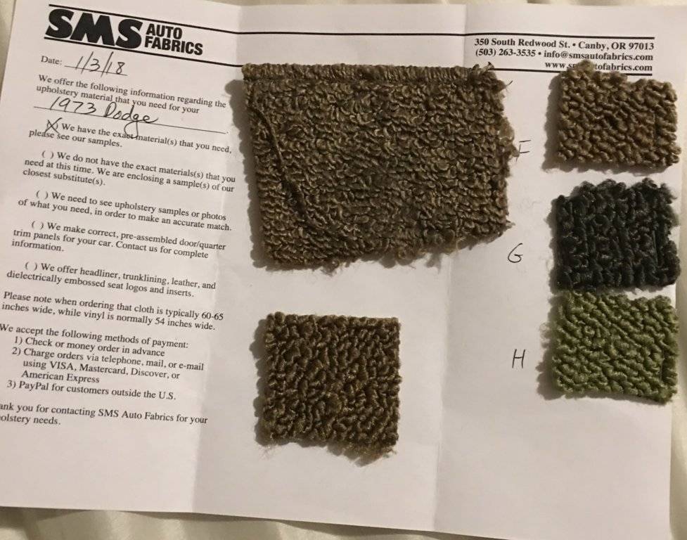

What I got from SMS. I like it better than what Stock Interiors offered. Hoping they can dial in colors. In this photo it looks close to the brown swatch, but it is actually a pea soup green. I washed my old carpet piece and it's a bit wet still.
I would bet the original is the brown. It looks like a typical fading of the color. I feel the SMS colors are dead on to the original colors.

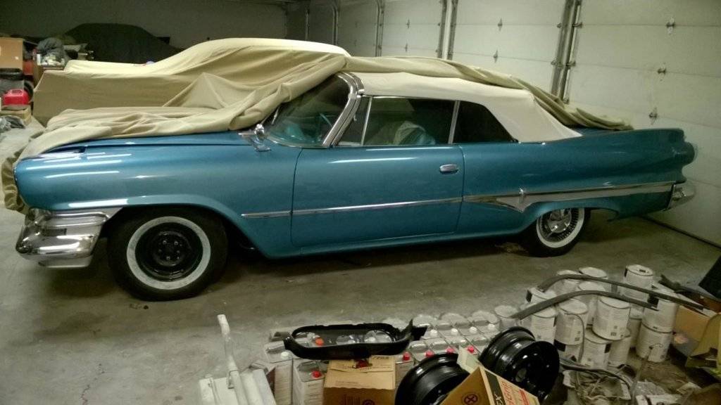

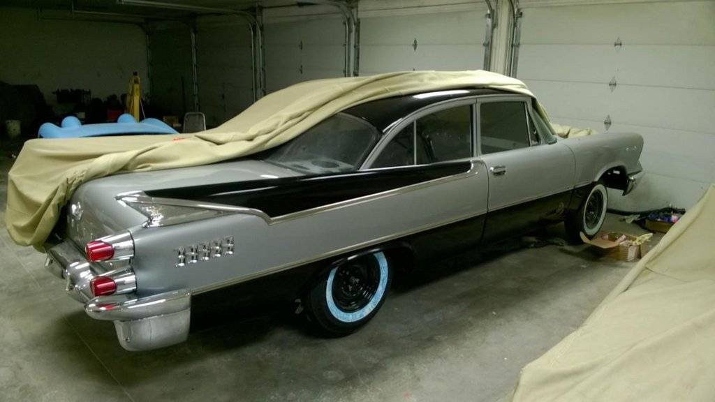

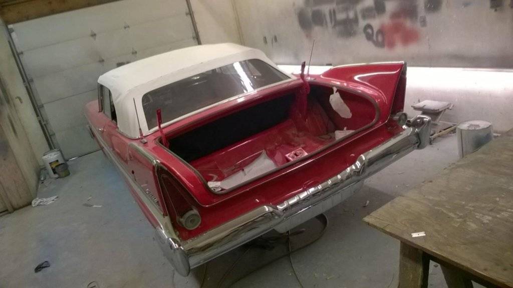

As an aside, I went to Benny Buckner's Friday. Very briefly. I haven't done much posting here lately and I know it's off topic, but I think folks might like to see some classic Mopar color...

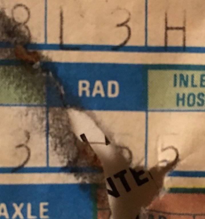

Ugh. Radiator needs replaced. Where is a good place (online) to get a three row radiator for a wagon with a '73 400 2bbl? Has transmission cooler connections. Would that be a 26" radiator? Sorry it may sound stupid for me to ask but my car is at the shop so I can't measure it quickly plus I don't want to get messed over with low quality aftermarket radiator...prefer US or Canadian made. Shop is ordering for me, if I don't give suggestions quick. Thanks in advance for speedy responses
If your wagon had a/c at least, it has a 26" radiator. All the regular aftermarket ones are junk. Get the one you have recored with a high efficiency (that means high fin density) core to keep it cool in the summer. Otherwise, it will run hot. If you don't spend $500 on it, it isn't any good. That is the short of it.
I looked through your whole thread looking for a engine compartment pic with your rad. If you could post one someone will be able to tell you what size radiator. Or the number on your broadcast sheet under rad, or the number on the top tank of your rad, maybe even the fender tag.

The 'incorrect' broadcast sheet (which is in better shape than the "correct" broadcast sheet that was stuck under the carpet at the factory) was tucked under the back seat cushion and shows what appears to be "5 5" for the RAD code.

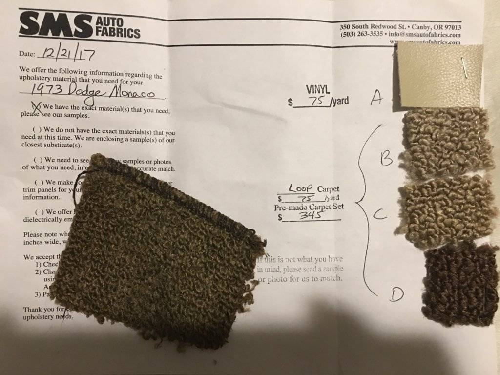

Got a 2nd sample set from SMS.
SMS matched my carpet color. It is 'F', as identified on the right top corner in the photo. I have a scrap of the original, the big piece in the photo, which was protected from the sun. To be fair, Stock Interiors got the color too. Their swatch is at the bottom of the photo. The problem is the colors have lightened (to a 'more green' shade) on my seat back and door panels.

Regarding your carpet, Stock Interiors will be selling you an ACC carpet. From what I've read, all the auto carpets are coming from the same supplier so SMS and ACC are using the same materials. The question would be if SMS has the molds to form the carpet or if they are just selling formed carpet made by ACC.
IMHO, not to run down SMS, but Stock Interiors is probably going to be cheaper and faster. If it's likely the same product, sold by different vendors, the choice might be obvious.
There will always be a little variance in color from batch to batch, just as when the cars were new. Order extra yardage for your seat backs and doors at the same time.

Had to get a new radiator. Drove it last night. Cooling seemed fine, we'll see what it does in the heat of summer. I think it was from either US Radiator or Classic Industries. Got a B-body Radiator. Had to make very slight mods to get it to fit. Kept my old radiator for 'someday'.
