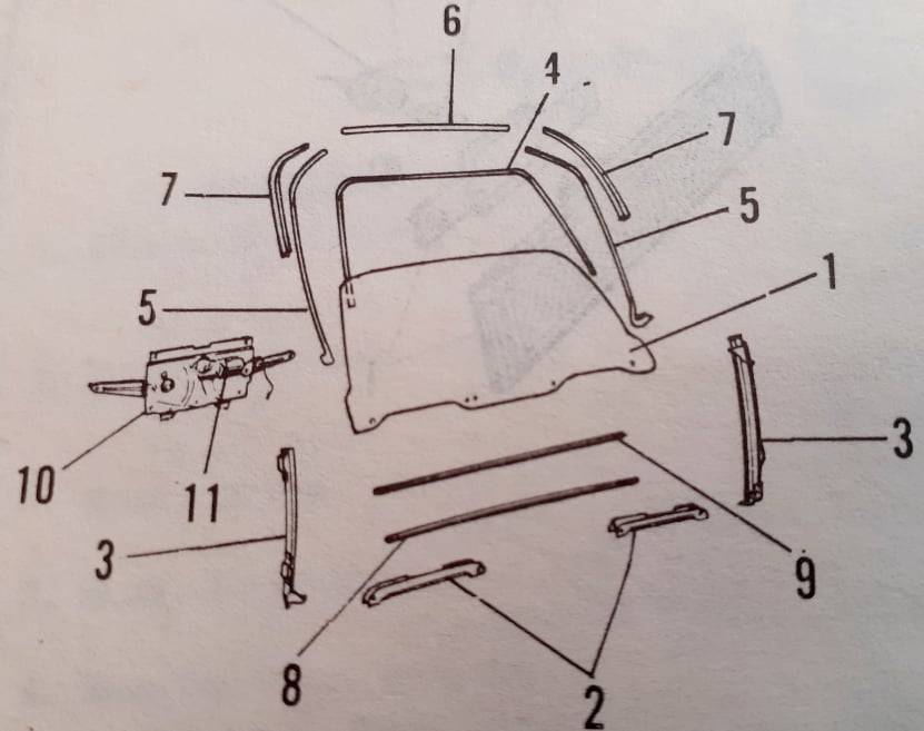

Like I wrote you, here the pics with the weatherstripe part numbers:

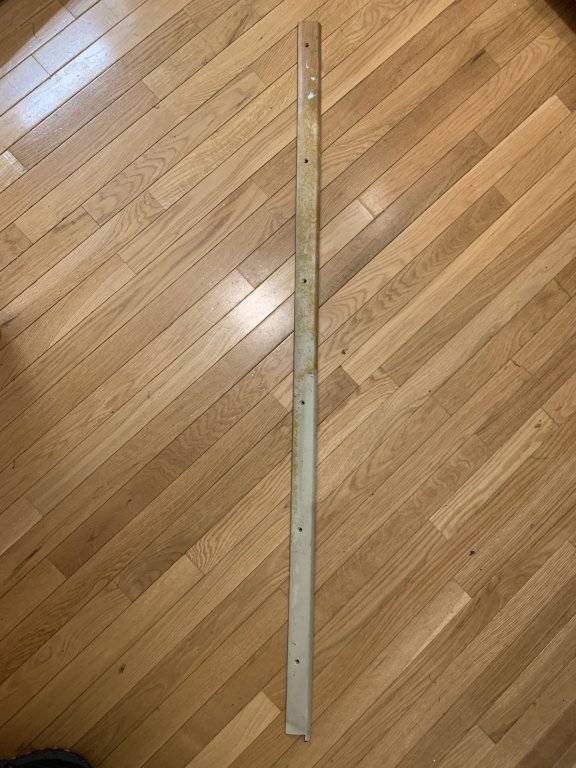

Re-finishing rear quarter window upper trim. It’s got some unsightly surface rust. I’ll try toothpaste.
Naval jelly and steel wool, then spray with baking soda and water to neutralize acid. Now I’ll primer and paint.
Got it painted and reinstalled. Ran out of time to take a pic before installation. The paint is a bit more “white” than “tan”, but it looks fine. Looks ok against the color of the 2nd row overhead AC unit. The main thing is I stopped the rust and it looks much better, reinstalled.

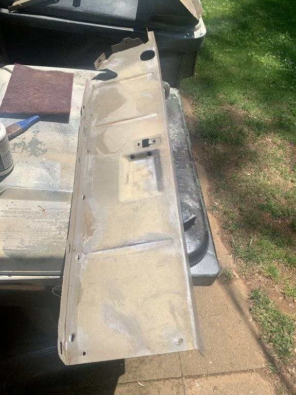

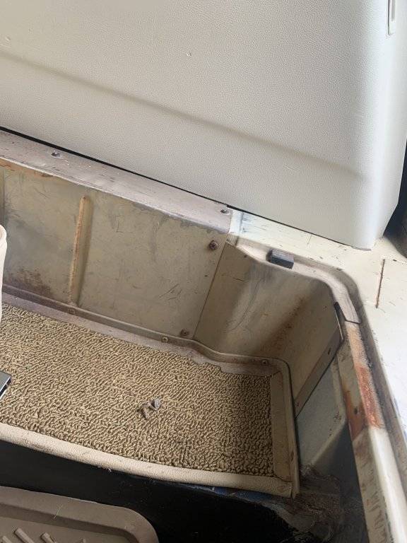

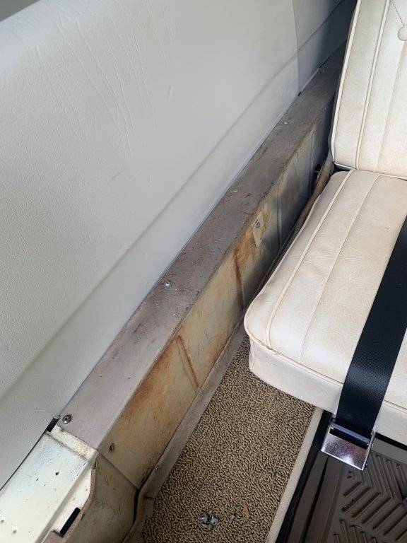

Tedious work project. Removed tan metal panels around cargo area. Cleaning and repainting. Screws were difficult but I got them out without destroying any.
Had to take the third row seat out. I’m tired!
When I had to do that to one of my wagons, I felt the same way - very tedious! That's one of the reasons I maintain that restoring one of those C body wagons, especially with the third seat, is very unlike restoring a 2 or 4 door hardtop or sedan.
Much more work and the tailgate has its own complexities as well.
Oh. One more thing. Trying to keep the factory original “paint run drips” intact! For authenticity!

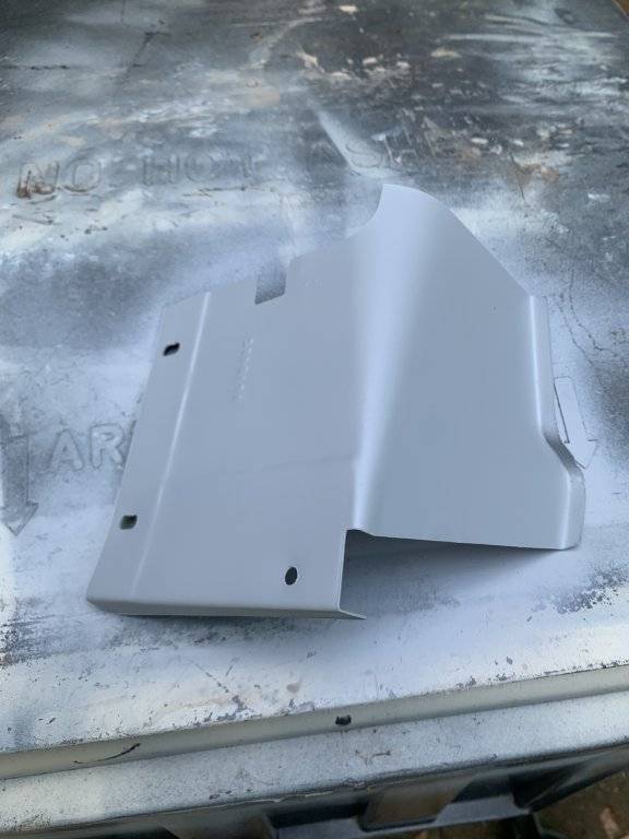

Naval jelly/wire brush…I’ll sand them and spray with primer and then spray the color…
