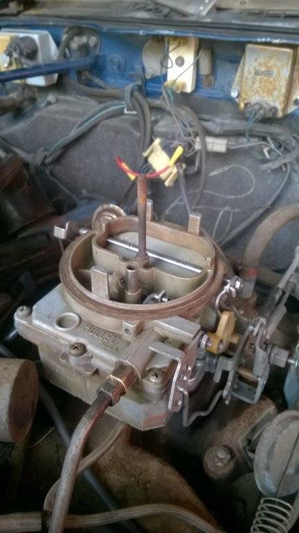

1. Sounds like a possibility, but how to verify? I am not exactly sure which component you are talking about. Is that the hanging triangle shaped part with a pointed end? I have a Holley 2 Barrel. I think it is a 2210. I rebuilt it and was disappointed by the limited selection of parts in the rebuild kit. Another poster says it may be the air horn (air cleaner housing?), which I would also consider a possibility because the threaded hold down/wing nut assy is not threaded to the carb anymore? When the car was delivered I found that threaded rod on the floor by the front seat. Any easy check on that as a potential root cause would be set a little stabilizing weight on top of the housing assembly and see if it keeps a good enough seal to keep it idling ok. I should also check for unevenness in the seal between cleaner housing and carb.

The Holley 2 bbs. develop warped air horns because the air cleaner hold down rod doesn't fasten into the base, but rather just fastens into the air horn. So when folks tighten the air cleaners down and go through heat cycles the air horns slowly but surely warp, and then the vacuum is lost that pulls the fuel out of the metering nozzles. But Autoline rebuildiers that Rock Auto uses know about this and they have a technique to press the air horns flat again and surface them so the problem is fixed. I haven't had any problems with the Autoline rebuilds from Rock Auto and suggest you invest in one of them. Your problem is typical of that problem along with substantial stumbles and surging on light accels, if it even keeps running. When you put one on though, do not tighten the air cleaner down any more than absolutely necessary to prevent a recurrence.
This is a definite possibility. I will have to check it. I haven't figured out the threaded Hold down, it was laying in the floor by the front seat, it doesn't appear to thread into the carb? What does it do to keep from letting the air cleaner cover come off? Right now the wing nut goes on and it just spins the threaddd rod. Useless. Maybe what I found in the front seat was not the right item? Thank you for taking the time to share some knowledge, this may do the trick.

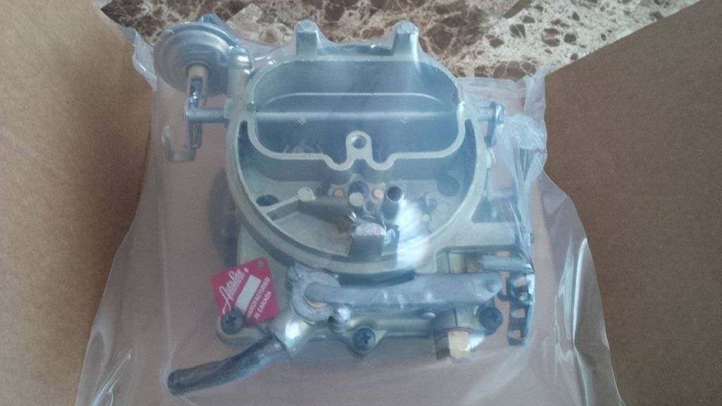

Looks like a Rochester and not a Holley, for sale on Autoline/Rock Auto for my 73. No fitment issues? No extra vacuum lines or linkages that didn't quite line up?

Your carb is obviously a Holly 2 bbl (2210). The air horn is the top piece of the carburetor that the hold down threaded rod for the air cleaner attaches to. So when the air cleaner is in place and you tighten down the wing nut on the top of the air cleaner housing, it pulls upward on the air horn (top piece of the carburetor). Over time and heat cycles, it just warps! You can fool around with that carburetor all you want, rebuild it 10 times, reset everything 10 times and so on. But it will not work right 9 times out of 10 for the reason I gave you. I have been through this countless times, but go ahead and pursue this other stuff. Or just go buy the rebuilt carb from Autoline that Rock Auto sells. Or ask Rock Auto tech assistance to give you the number to Autoline techs and they will explain this issue to you and then maybe you will believe me. Good luck.
By the way, those Holley 2210s and even the 4 bbl 4160s may not be very durable due to cheap castings that warp on both of them over time/heat cycles, but when new, they run generally significantly better than the Carter AVS 4 bbls at least. Holley's generally have accelerator pump systems that deliver off the line response that the Carter's don't match. The pump shot on the Holleys plus the seamless phase in of the off idle fuel metering is just much stronger with the Holleys. Those 2210s are also sweet when running right. Idle great, and perform really well - when they aren't warped. They are worth keeping. Just don't tighten down the air cleaner very much.

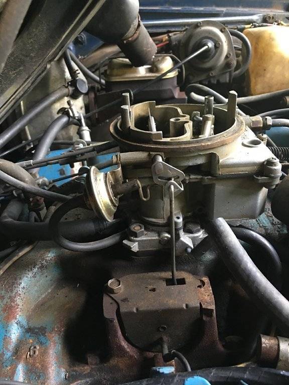

Here is the side view. The strange thing is that the hose from the carbon canister goes nowhere. Can't figure out where it was supposed to connect.
Hey. Not calling in to question your technical expertise. Yes, it certainly is a Holley. The fact that I went out and investigated/photo'd the air horn should be an indication that I took your guidance to heart. I just want to understand for myself the condition of my carburetor before I go buying parts. Part of the fun is gaining understanding - positively identifying problem conditions and fixing them. I appreciate your input and will probably end up buying a Rock Auto carb. I certainly want to learn from other people's experience. Thanks for the advice. There is a wealth of that on here and it has already saved me time and money.
The strange thing is that the threaded rod piece does not thread snugly into the carb, either way I flip it. Odd.

Thanks for the additional knowledge. The Autolines on Rock Auto's site appear to be Rochesters and have a large tube on the front that my Holley does not have. That may not be an issue at all if it goes to the carbon canister, because currently that line leads nowhere from the canister under the hood. My PVC valve hose (similar/large size) goes from the left bank to the back of the carb, btw, which you probably already know.
Is the Autoline air horn as equally susceptible to warping over time as the Holley, or is it superior? I expect you are sharing based on observation of warpage from cars that have experienced 10-40 years of useful life and thousands of thermal cycles (just like mine!), and therefore a new Autoline would probably be just fine for the next 10 years of hobbyist use on a car that would probably get started once per month, on average.

The Autoline carburetor uses the same air horn that is from whatever core that they used to rebuild. They just press the airhorn flat and maybe surface it a little as well. So the problem could recur if you tighten the air cleaner too much - only tighten it as little as you can get away with.
