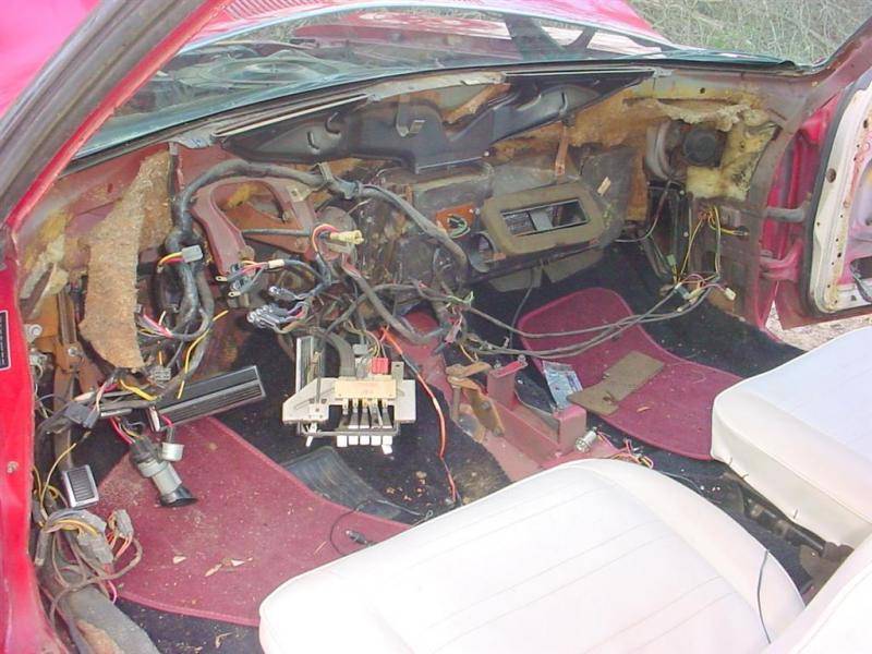

Allow yourself at least three days and a lot of patience. You'll need an extra set of hands to get it back in.

BTW: On the instrument cluster, I don't think just the R&R of the cluster and column took 3 days. However, tracking down the Neanderthal wiring issues took me a couple of weekends. Then I was able to reassemble.
