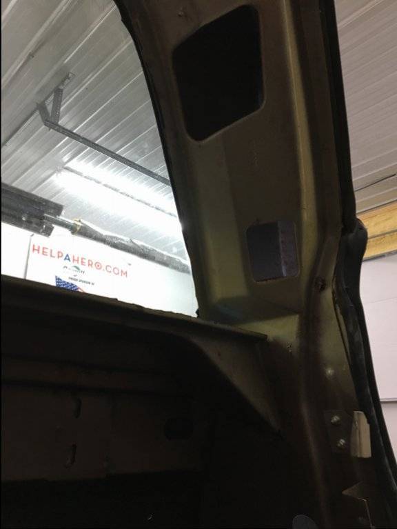

Looks like those grab handles would attach from the outside body from hardware from inside the car?
I can find a nut for the bottom of it from an access hole in the door jam, but I'll be damned if i have a tool to fit in there and even if you could somehow finagle a socket it on it, not sure how easy it would be to get back on. Then there is the top!
But clearly, it was installed, so it has to come off.
The grab handles come off...a nut at each end of the handle. You have to reach up to get the upper. I don`t remember what I used (box end wrench I think to get it started and then spun it off with my fingers.).

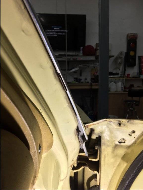

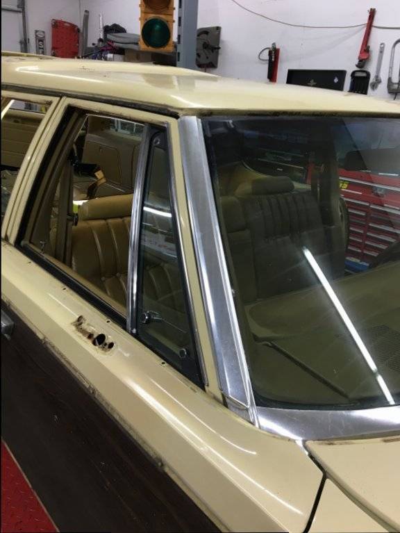

Now, does anyone know how to get this piece of windshield trim off? I don't want to go too far and break something. Can't see what the clip looks like

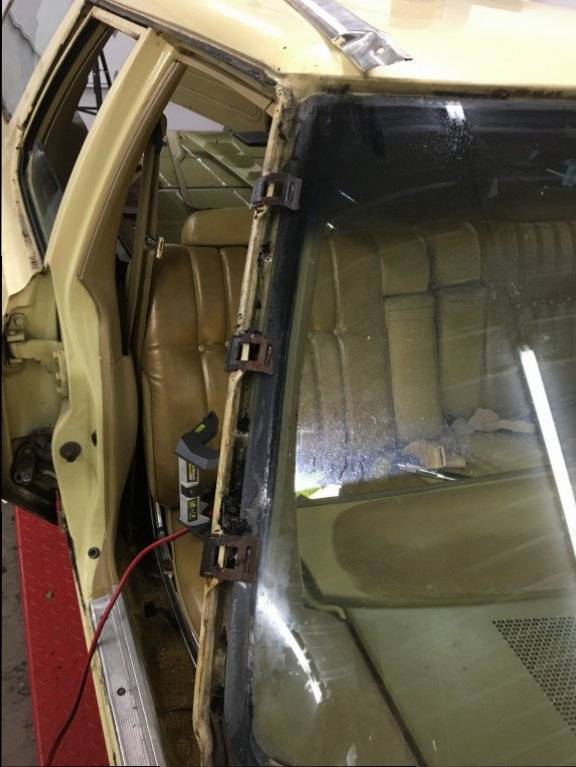

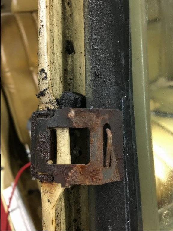

You gotta be careful or you can crack your windshield. There are 3 clips with a twisted tab that goes through slots in stampings on the pillar and a screw at the bottom.
Since you have the top piece off, I recommend that you remove the bottom screw and then slide the trim up and down as necessary to pop the trim off of the clips via the slot in the trim. Once the chrome is off. You'll better see the clips and how to access the tabs. You need to press the twisted tab with a screw driver to straighten it while pulling up on the clip to pop it out. Having the screw driver close to the windshield edge is the danger of cracking the windshield.
Once you've done it once, you'll be a pro at it.

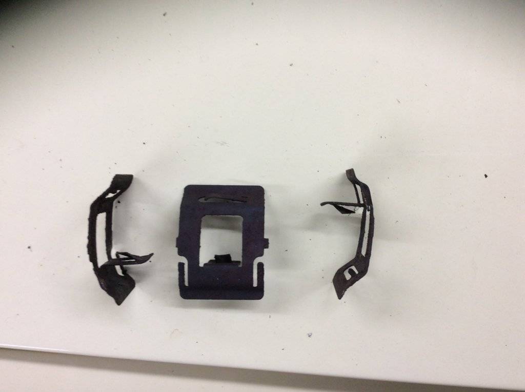

Fast Eddie: I'll appreciate your showing the clips that Mr C is referring to after you get the trim off so I can have a visualization.

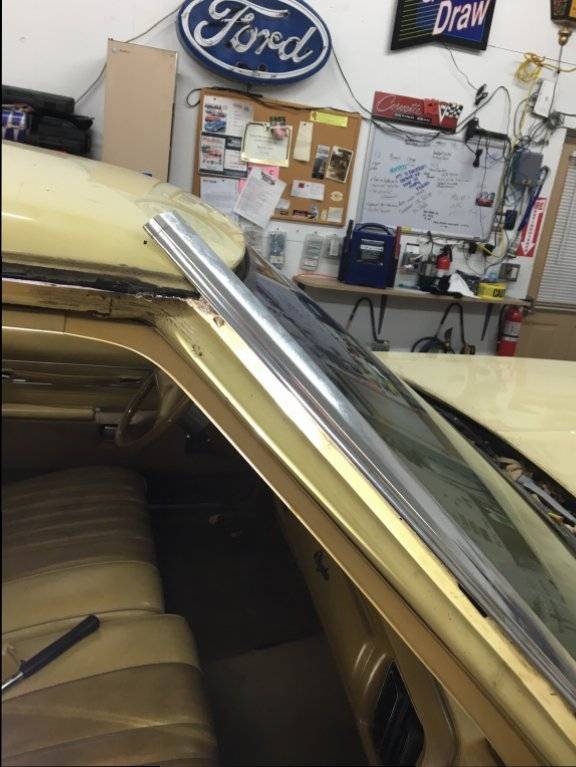

The key was the slot in the trim. I thought I looked for it and didnt see it. Hit it with some serious light and I found it. After that it was 'easy'. I tapped the slot down to the first clip and had to pretty much go right to the hinge but it popped out the slot. It was tough and rusty pushing it back up so I slathered it in PB Blaster. I pushed it up and the pressure alone popped it out of the middle clip. I could feel it wasn't completely free and know I could feel the inner edge holding on. A quick snap toward the middle of the car snapped the trim out of the inner ridge on both clips and after that it just slid right off the top clip. Never had to go near the windshield with a screwdriver.

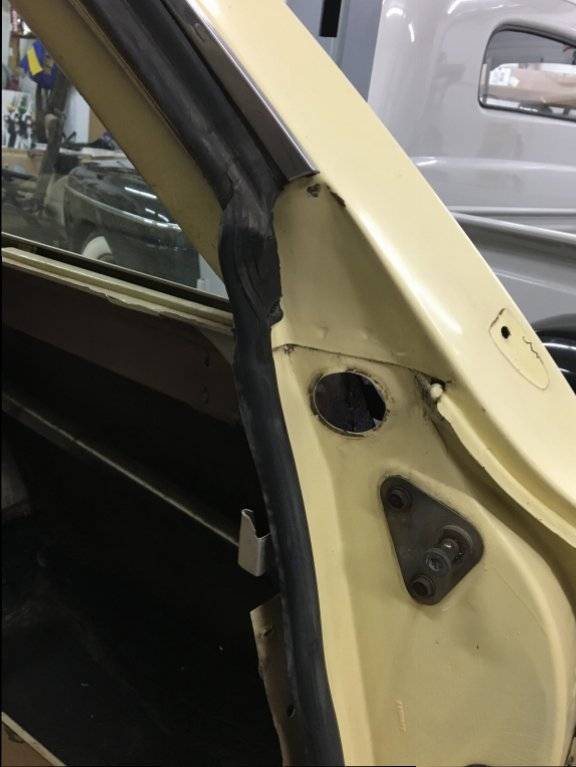

The clips, now that is where you have to slide the screwdriver in and depress the locking clip. I'm pretty sure you have to remove the trim first as I did. I don't think you could pop off trim and clip at once.
