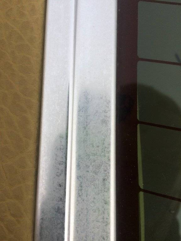

A question about the anodized? molding that is around the back window of my 78 .
I assume this molding is to have a matte type finish?
My molding has what looks to be water spots or stains on it though I don't think that is what it is.
Not the best picture showing the stains, but has anyone had success with cleaning these molding to look better?
It's supposed to be shiny. The anodizing on your trim is shot to hell. VERY common.
Solution?
Strip the anodizing chemically and clear coat it (cheapest)
Strip, polish, and re-anodize it (expensive)
Yes I've polished & wet sanded chrome just like this. Stainless I believe is what it is. I've just used chain store products. A few times I have bought some expensive stuff a vendor at a car show was selling. Only slightly better. I zip tie it to a thin board of wood & use a Harbor Freight buffing wheel kit for a drill & let her rip. You can sand some of the lighter scratches out
You can try "Brasso" if it bothers you. Every year I polish my copper fire extinguisher and home cabinet door pulls. Its been around decades and is cheap compared to the miracle stuff they sell at the car shows.

If you can take the trim off, you can strip the anodizing with Easy-Off oven cleaner. From there, you can buff the trim up to where it looks really nice. If you don't do anything with it, it will oxidize again, but if you keep it polished and waxed, it will still look great. I've done the aluminum wheel well and rocker trim for my car this way.
I use a buffer from Harbor Freight and I started out with a kit from Eastwood. Buff Kit Stainless Aluminum Brass Steel 6 Inch
