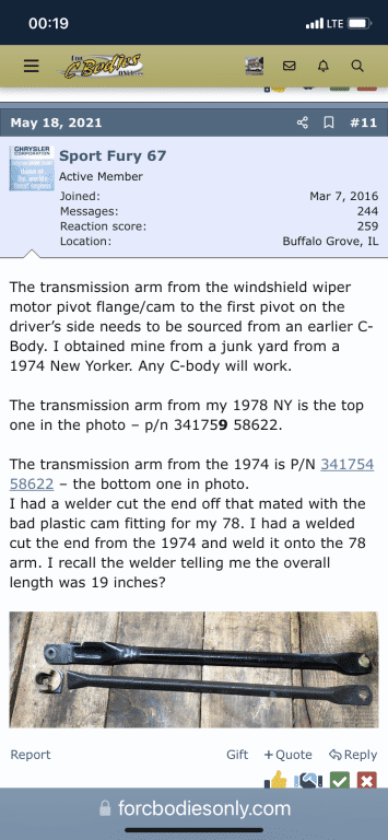

So you need the Cam that connects the linkage to the motor… search the forums here and you’ll find extensive info on the fix… Bob / 78NYB (RIP) wrote up a thread specifically for this.
Thanks! I should have searched before I posted (newbie failure on my part) but I did find the thread. I posted against that thread, hoping someone has a template/pattern that I can use to have a new bushing 3D printed (easiest fix from what I can deduce)

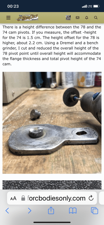

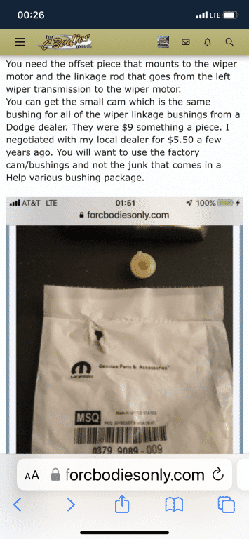

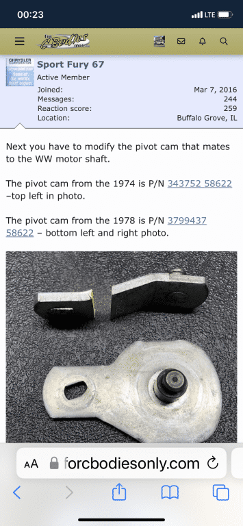

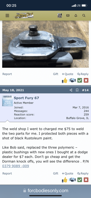

Here’s a screenshot for May 2021 thread.
Hope this helps get you a kickstart.
Thank you! I was hoping for a little bit easier fix (of course LOL) but if this is the way I need to go then I guess I just need to start collecting the necessary supplies and get on it.
Since this is a known issue and a significant "bug" I was hoping someone had come up with a solution to 3D print the faulty part. That would be the easiest solution and I have access to a 3D printer that can print "auto quality"

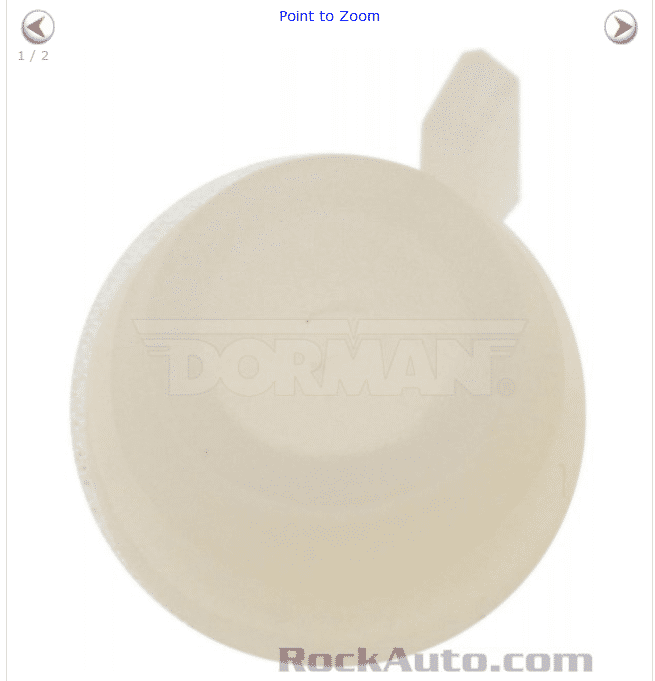

If your motor is good then its more likely the Linakge bushings. My 75 had the same issue and thats what it was, a relatively easy fix, just gotta dig in and do it. The linkage will all need to come through the Cowl vents for access. you can buy the bushings on FeeBay or your local dodge dealer will have them.
RockAuto also has those bushings, I ordered some last week, Dorman 118301:
