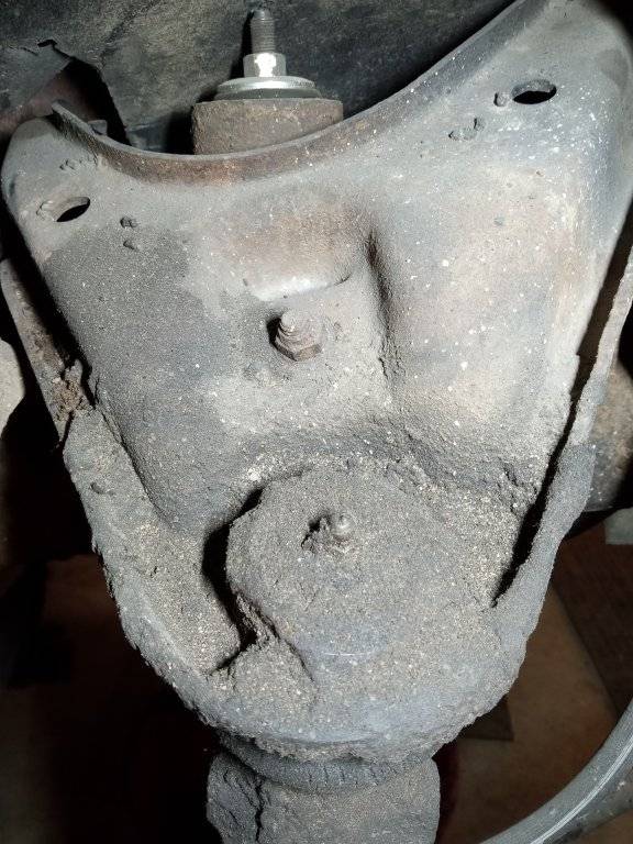

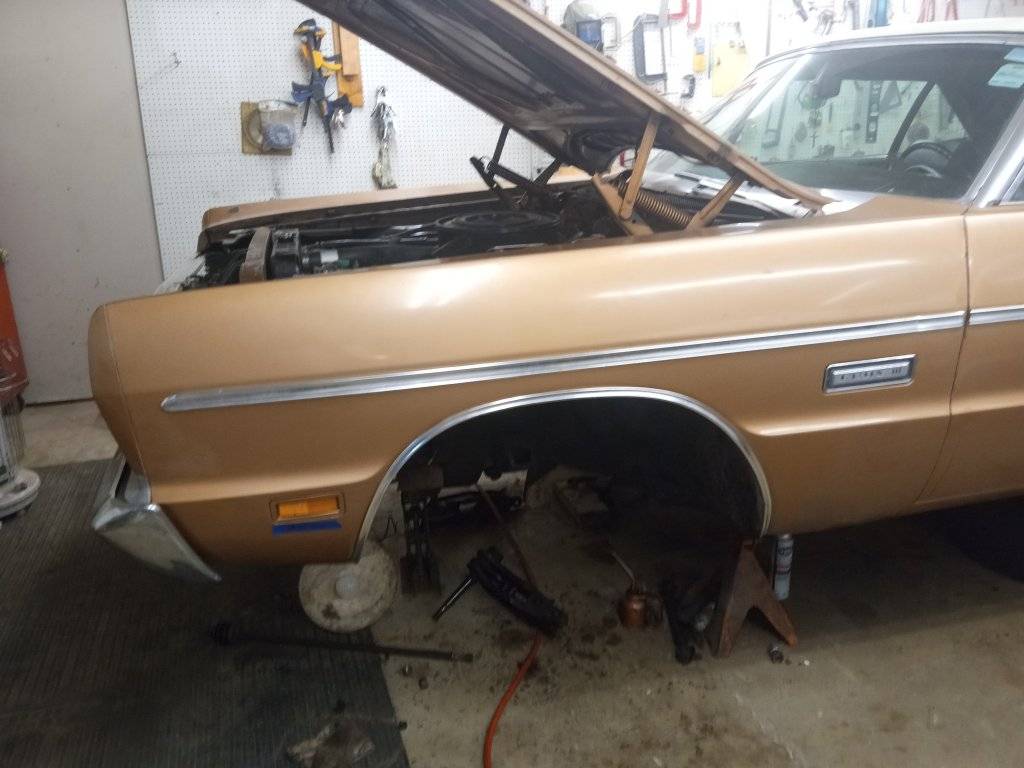

So I had a crummy day at work today. Therefore, I went out to the garage and began working. I bought a complete suspension kit from Craig at Mobile Parts. I got a complete disc brake setup kit from a 72 Newport that was in a junkyard. So today was a good day to start the process.
Cleaned all the crud off the upper ball joints, cleaned and oiled the torsion bar adjustment screws, and cleaned and lubed the rear spring bolts. I also squirted down every bolt and nut that I could see with transmission fluid and acetone.
I also happily said good riddance to that aftermarket SSBC and Leeds combination disc brake conversion kit that somebody else added to this car. The best place for that is the dumpster.

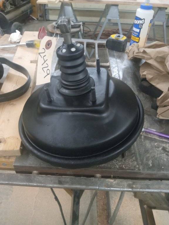

My 72 Newport brake booster came back from booster Dewey last week, so I'm ready to go. I
have an April 1st deadline, as that's when I
have the appointment at the old car alignment shop.
With a completely new front end, the addition of an anti-sway bar, and new six leaf rear leaf springs, and the correct disc brakes, this car should ride like a dream.

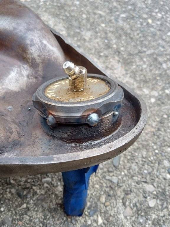

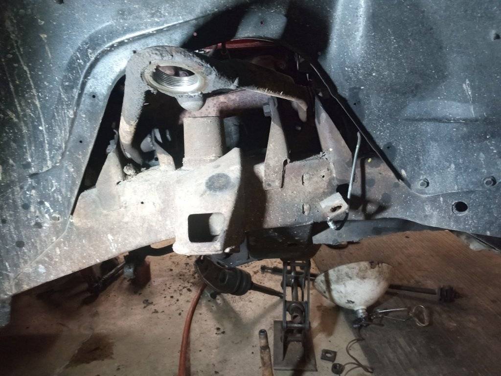

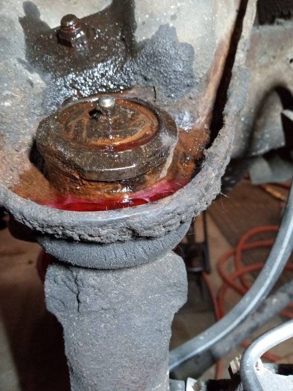

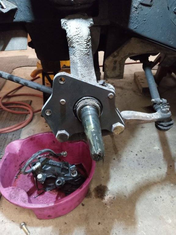

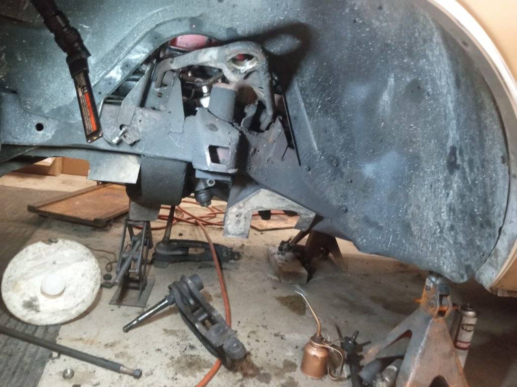

Here's some photos of today's funsies. Amazingly everything came off good. Being a native Detroiter, I just can't get used to not having a bust rusted stuff apart, or deal with seized bolts. Today was actually fun. Every pushing and ball joint and tie rod end is toast.

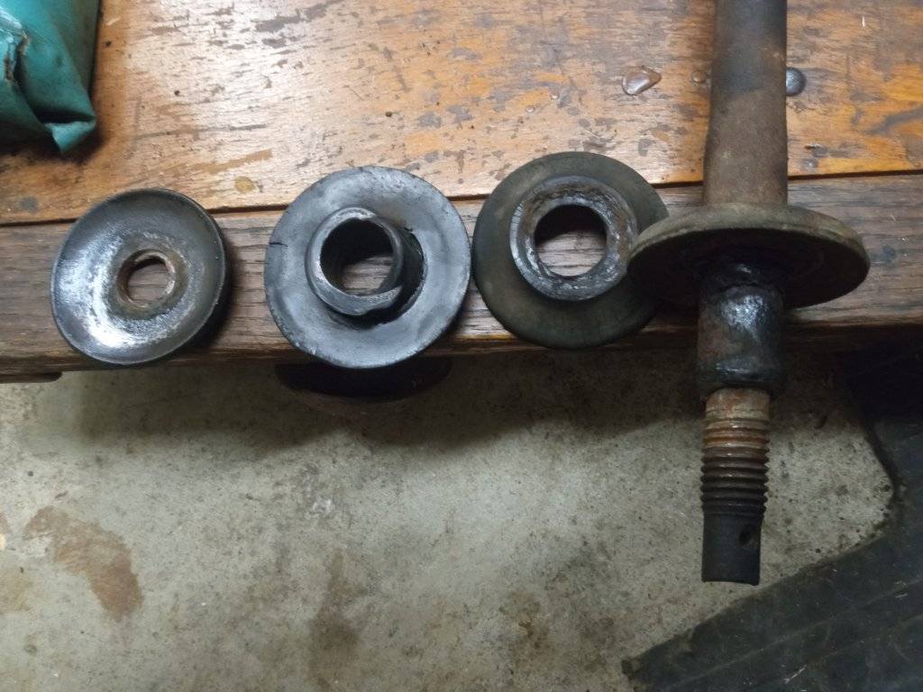

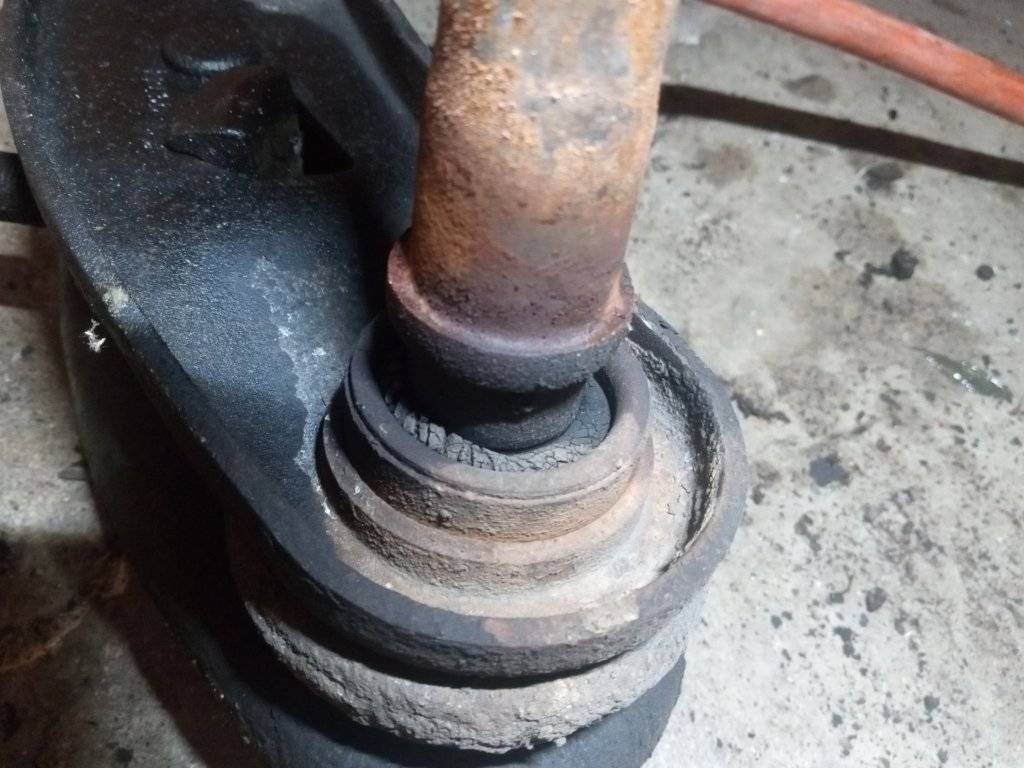

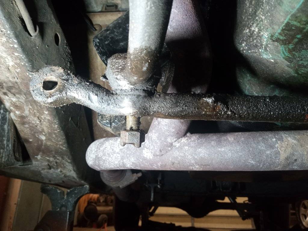

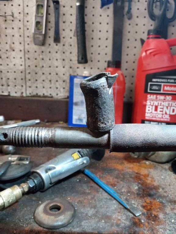

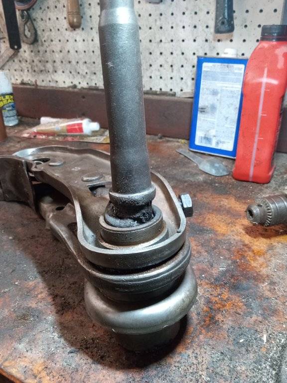

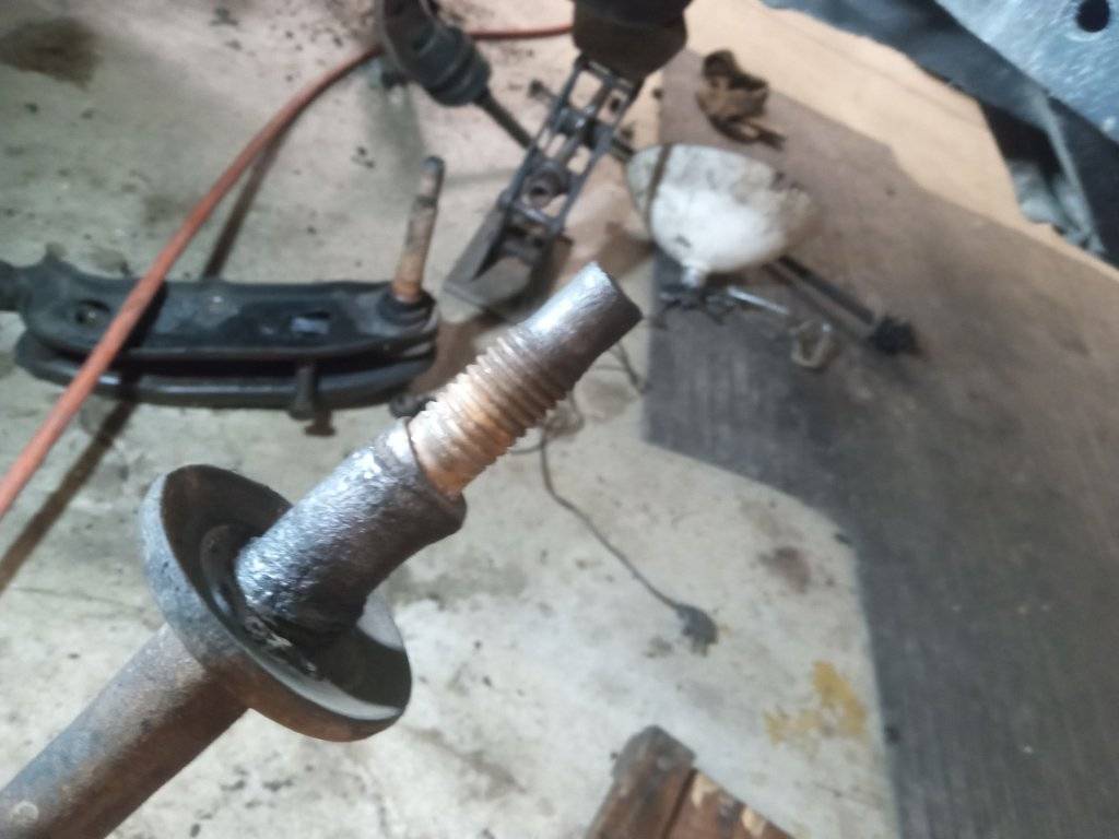

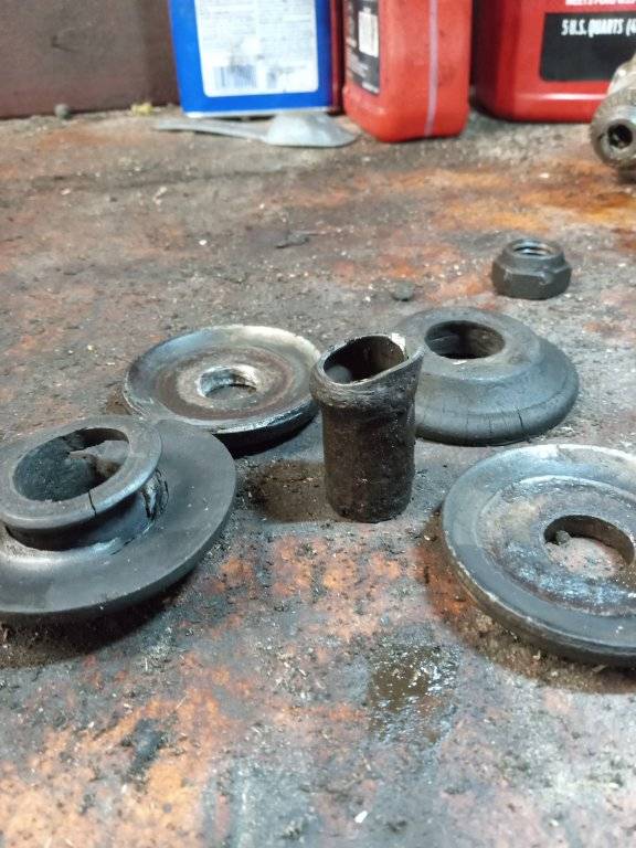

Here's today's funsies. You probably can't tell from the pictures, but the one lower control arm bushing is so wasted that the pin is actually pointing crooked. I don't know how this car drove as well as it did. I also successfully got the wasted strut rod sleeves off the strut rods. they were not the split type for some reason. thanks to a few other c body fellas though, my solution will be here tomorrow.

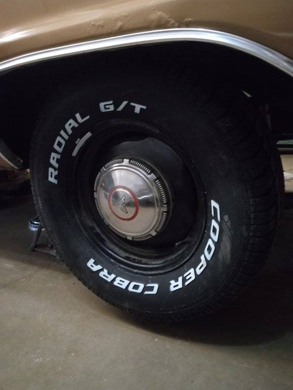

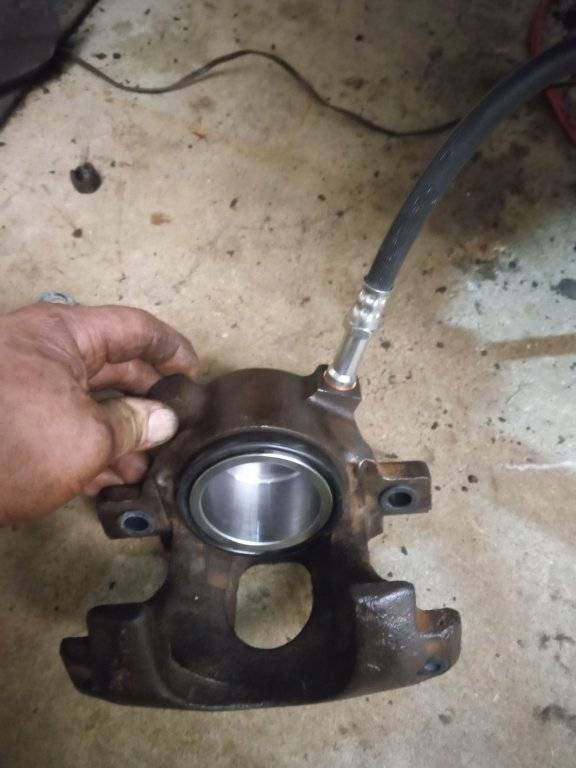

Sorry...yes. I will post photos tonight. Suspension is in place. Struggling with achieving rotors for the 1972 brake system. I got burned by the "the computer says these will fit" at the local auto parts store (they sold me 1973 rotors). However, I will be getting some Raybestos 7012 rotors from RockAuto today. I used all the new suspension parts supplied by Craig @ mobileparts. Awesome kit. I strongly suggest going with Craig for your suspension needs. I managed to find one rebuilt caliper, and the kit to rebuild the other one will be here tonight. New tires tonight also (cooper GT Radials P/235/70/R15).
I hope to have the old girl sitting on her feet this weekend.

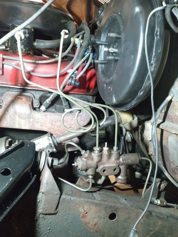

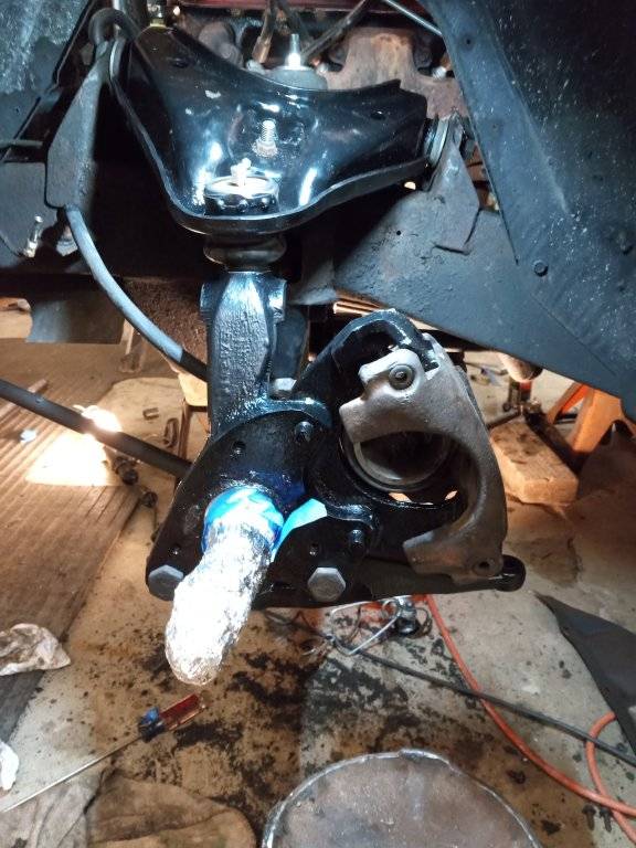

Here are a few photos of the last couple of days funsies. I wish I had a quality tubing Bender, but I did the best I could with what I had.
I'm glad I kept the pedal also out of the 72 New Yorker. I now have proper pedal for power brakes with the proper pivot point. between the new suspension and the new brakes this thing's going to drive wonderful. The new leaf spring should be here in a couple of weeks
Is that the original 1972 metering valve? If so was it rebuilt? My 73 is kinda rusty and im wondering if i should have it gone thru or buy an after market one.
