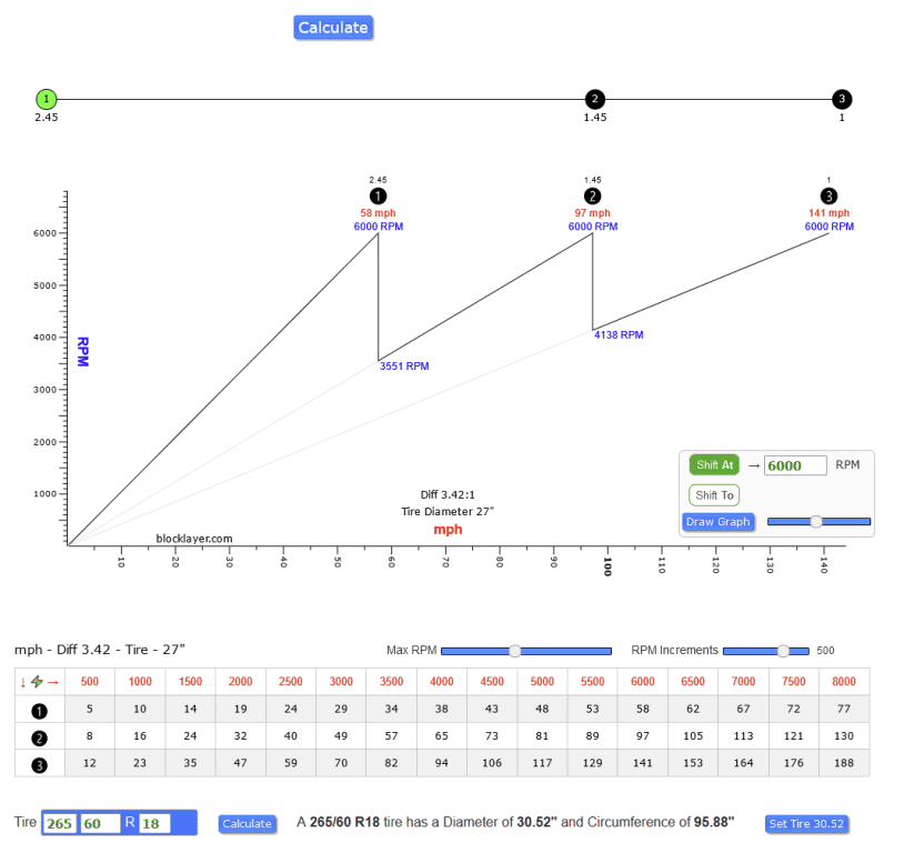

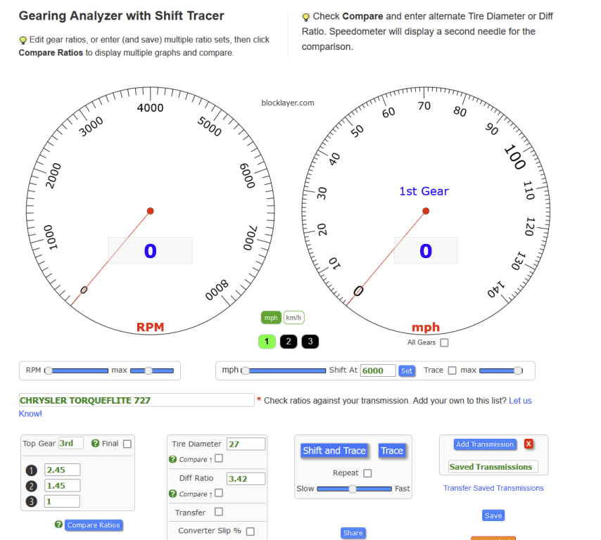

I don't mean to tread all over your efforts Gerald, but Blocklayer has a really nice gearing calculator. You can also input gear ratios individually, or select gearbox presets from the dropdown list (I asked the admin to add the 727 ratio although it was actually already there as 'Dodge TF727'). You can even input your tyre size and it'll tell you the diameter, either in metric or imperial units. If the preset list doesn't have a gearbox you're looking for, just let the admin know via the link on the same page.
