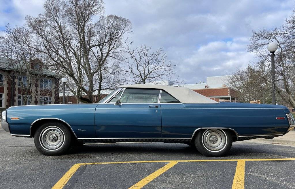

A 235/75-15 is going to be spec'd at 6.5" rim, with minimum 6" rim, and a ridiculous almost 29" diameter.
Like many other members’ cars, my 1970 300 TNT ´vert and 1972 NYB both sport Hankooks in that size. Do they look ridiculous to you? (Buttercup photo courtesy of @71Polara383)
