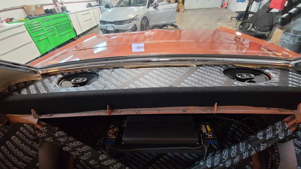

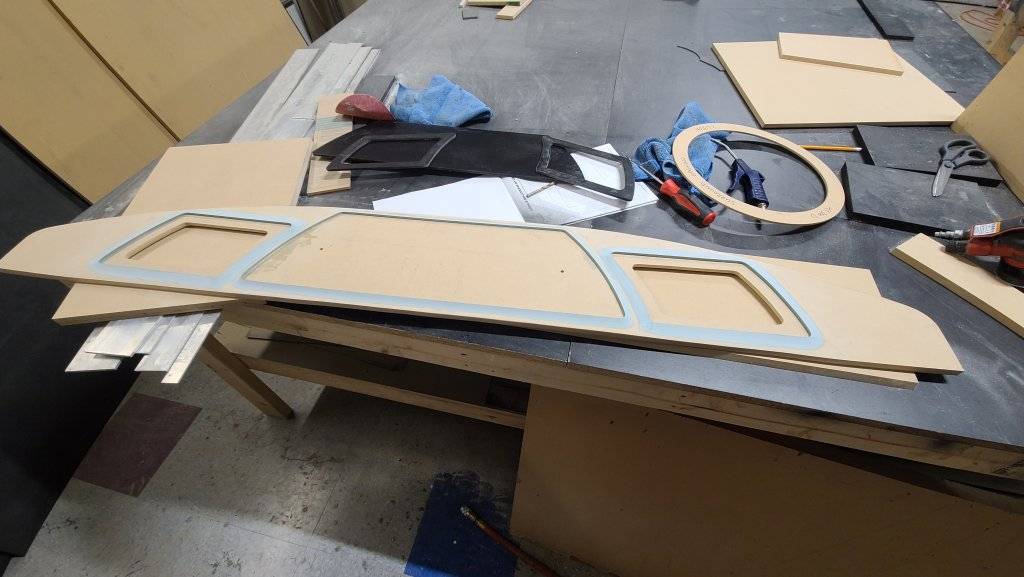

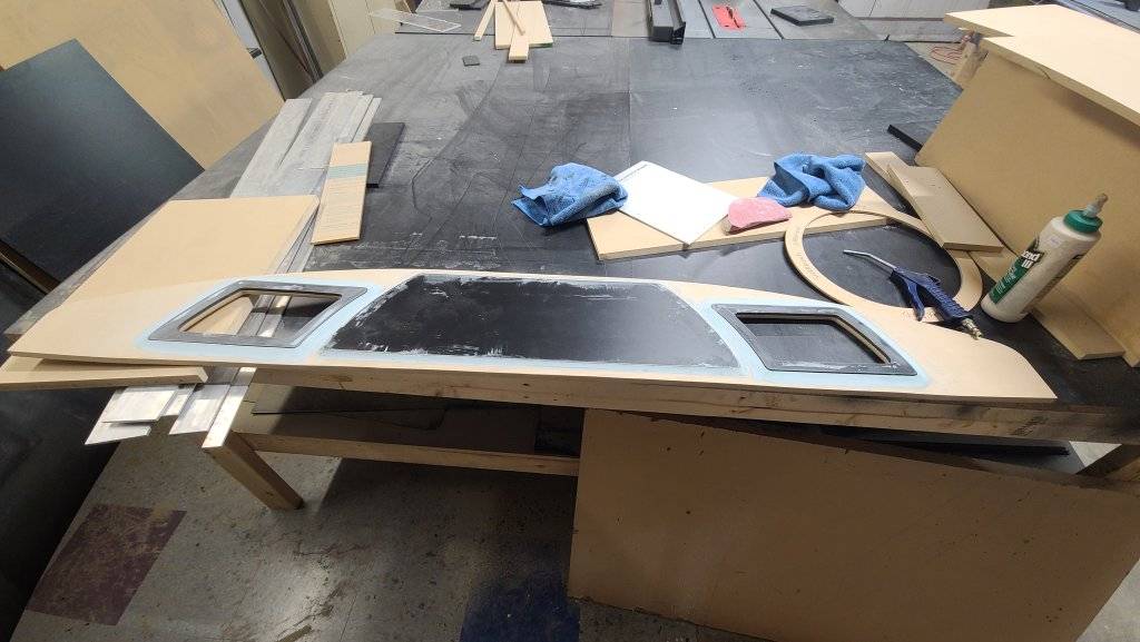

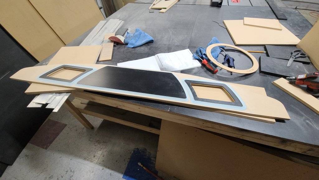

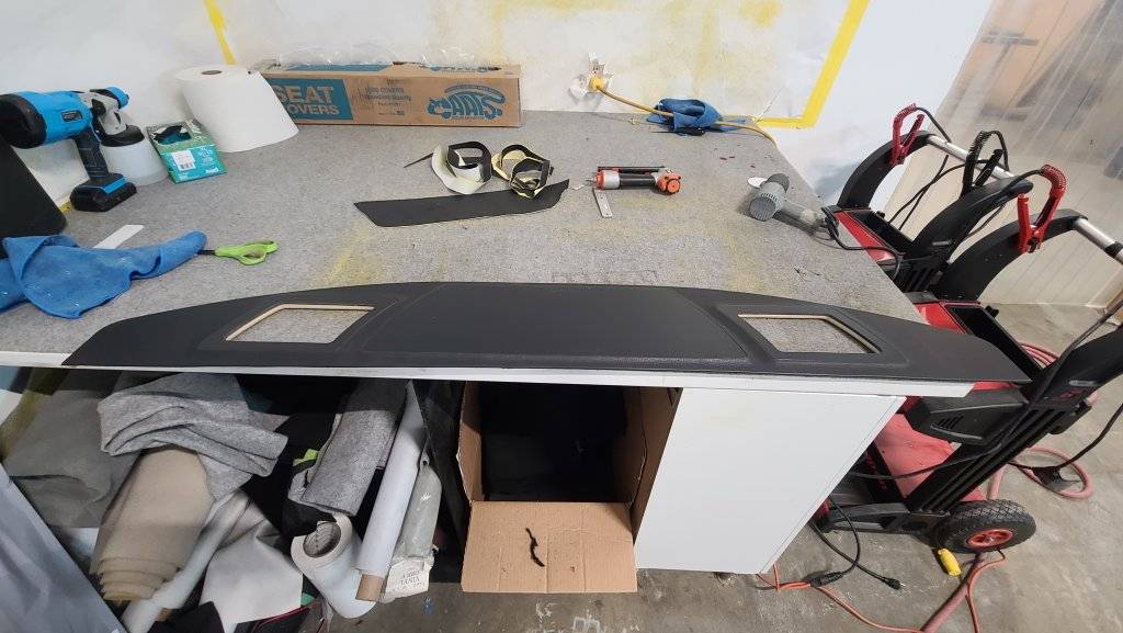

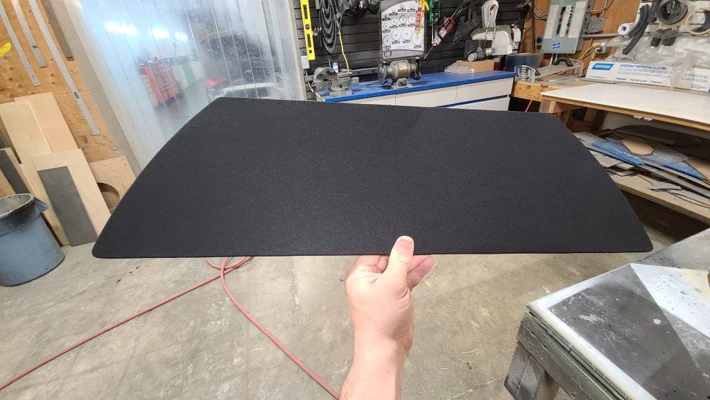

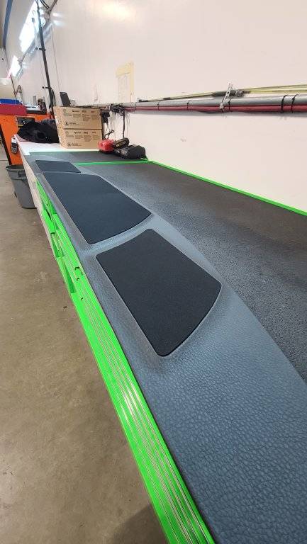

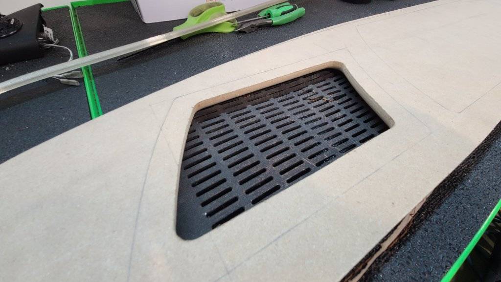

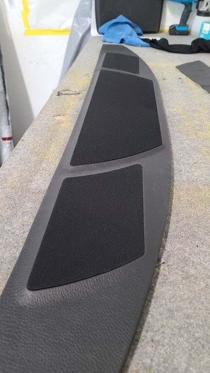

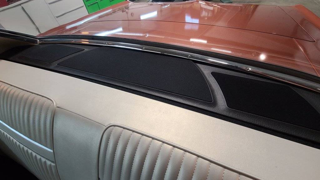

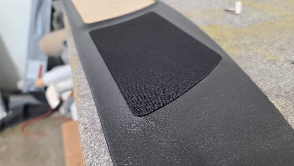

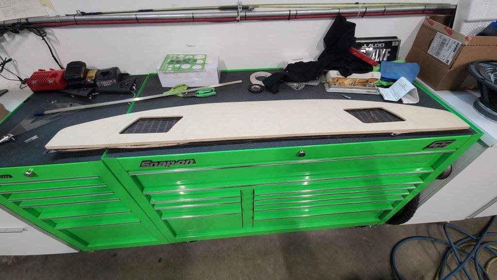

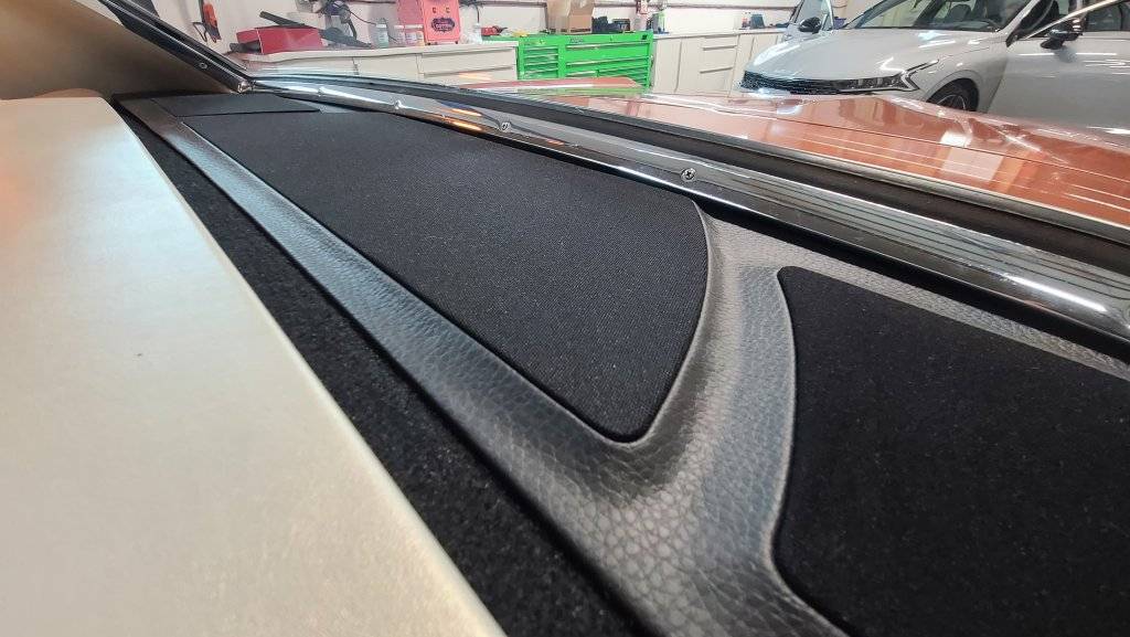

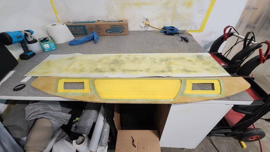

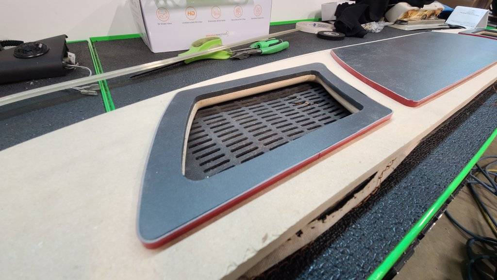

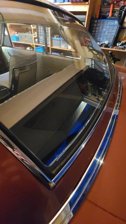

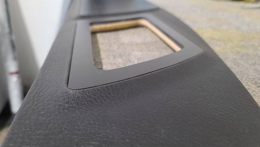

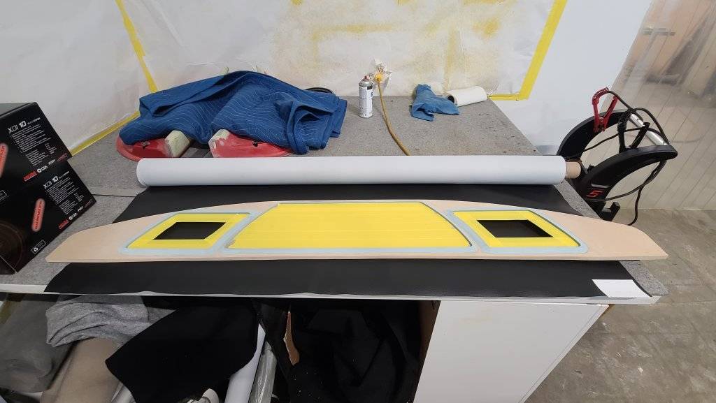

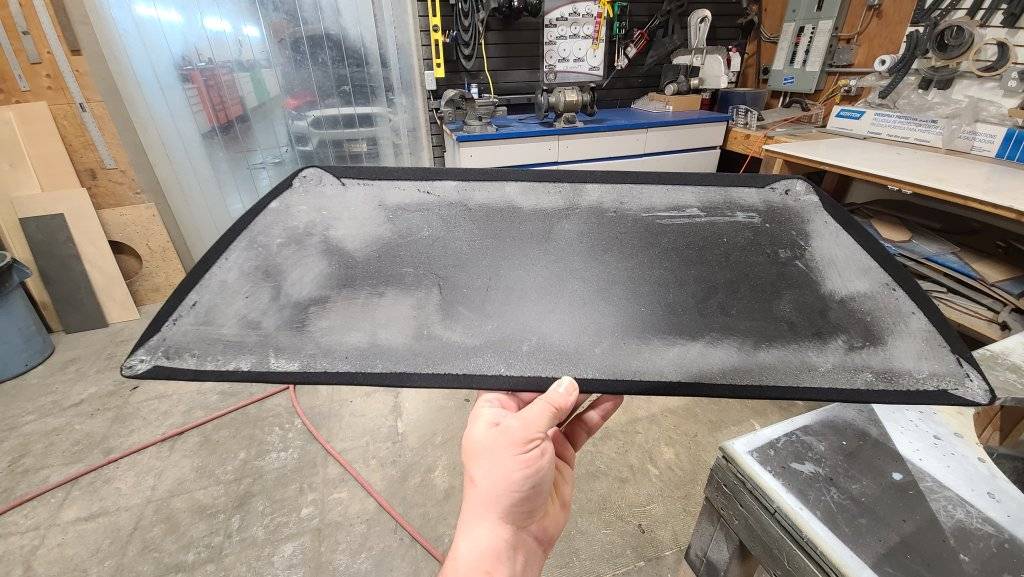

Hi folks! Been hanging out here for a couple of months and doing my best to fit in. Haha! Well, now I've got a little project to contribute! I am a car stereo fabricator so I wanted to make a nice new package tray for my '67 Sport Fury. I've got new speakers in there but I just don't want to see them. Here's my little project in pics!
It's pretty self-explanatory but if anybody has questions, please ask away!
Mike M
I like the fact you've used new products, new methods to upgrade an old car, not tacky but done in a tasteful way.
In my view it does not take away anything from the car, are you planning on doing the front dash pad to match?

Thank you for the feedback! It does look a little out of place I agree. I am hesitant to change anything else in the interior but it is a work in progress so I may go a different direction with it. I may make some trunk panels in the same theme to showcase what I do and show off some of the stereo products I am using.
The dash pad is perfect so I would likely leave that alone.
