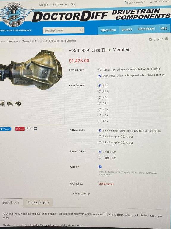

Guys, I've decided I need to lower the rear gear in the Newport. 2.76 rear gear in a 742 case I have now is rather long legged, but Id like more spirited acceleration than what it gives me. Attached are the pictures of what I'm looking at buying. Opinions on going from a 2.76 to 3.23? Tires are 235/70/15 that are 28" diameter. Most driving is in town with some freeway trips of a few hundred miles in mountain territory. Opinions?

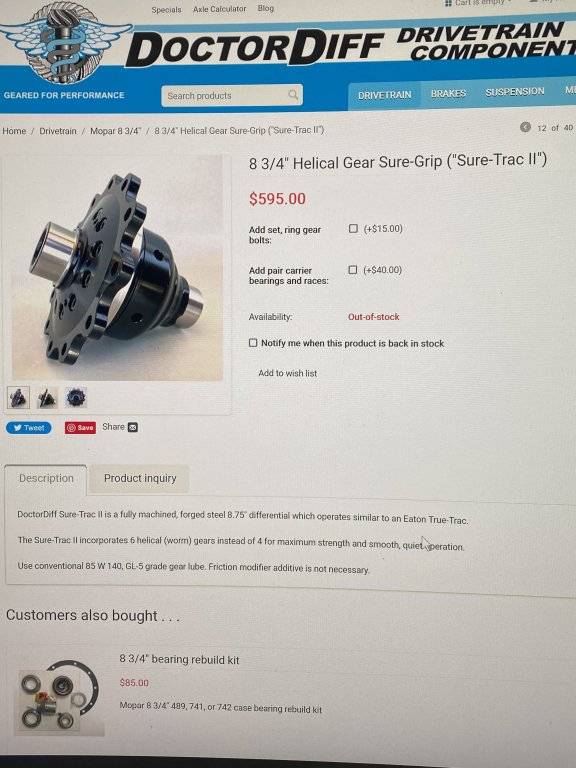

For the city, a 3.23 seems ideal. If I cruised the highway, I'd want a 2.94 or 2.76 even. My fuel economy was marginally better with the 2.XY rear end we ran on Mathilda, and I might deploy it short term again, while rebuilding the 3.23 I now run on Gertrude. IFF we do that job, I'll set some Sure Grip system up. I like the modern stuff I see at Dr. Diff.: Mopar 8 3/4" (8.75) Clutch Type Sure-Grip ("Powr-lok") If one is to rebuild the rear end nowadaze, I reckon this is the way to go.
