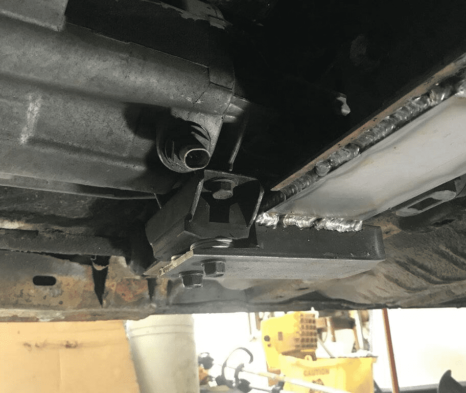

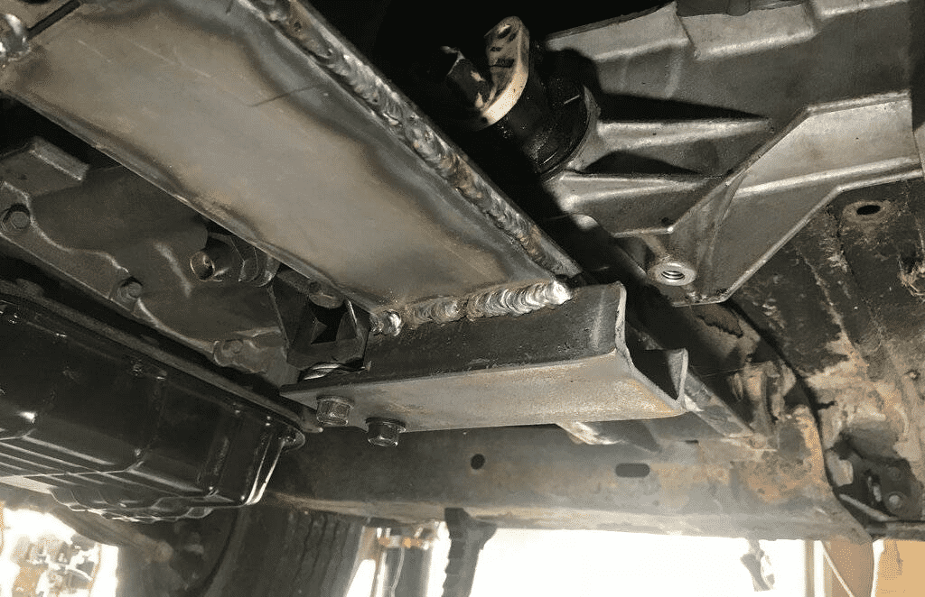

It can be done in a C body with minimal "adjustments" to the tunnel, cross member, and some trimming on the trans but you will have to know how to cut and weld. Having done the B and the C I think it was much easier in the C. The B you have to cut out part of the cross member. On the C you just need to modify your cross member or I think your Imp has a full frame so it may be easier to make a new cross member. You will need a ball peen hammer to make some dimples on the tunnel but it will not be noticeable inside the car.
To mount the big block to the 518 you will need an adapter or an Ultra Bell bell housing. I went the Ultra Bell in my 63 because it doubles as a scatter shield for racing and I didn't want the adapter because it moves the trans back into the firewall or you need to move your engine forward a bit. The only downfall is you have to cut the stock bell housing off the 518 and bolt the Ultra Bell on at the pump housing. Don't worry it isn't that bad and it is strong as the ultra bell was designed for drag racing. Link to the bell housing J.W. Performance Transmissions 92457 J.W. Performance Ultra-Bell Bellhousings | Summit Racing
I worked on trying to make a mechanism to use my push buttons in the 63 and I got it to work with the stock shift cable for 1st to R but I couldn't get the park cable figured out. In the end I gave up and put in a floor shifter and used 2 toggle switches for OD and Lockup. That project was 20 years ago but I can give you the basics of my modifications and maybe you could figure it out.

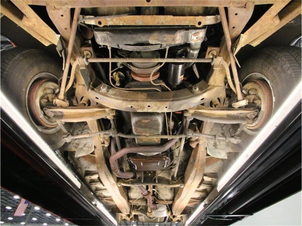

But I did find some photos on the internet of the underneath of my Imperial and I may be okay when it comes to the frame and the transmission!

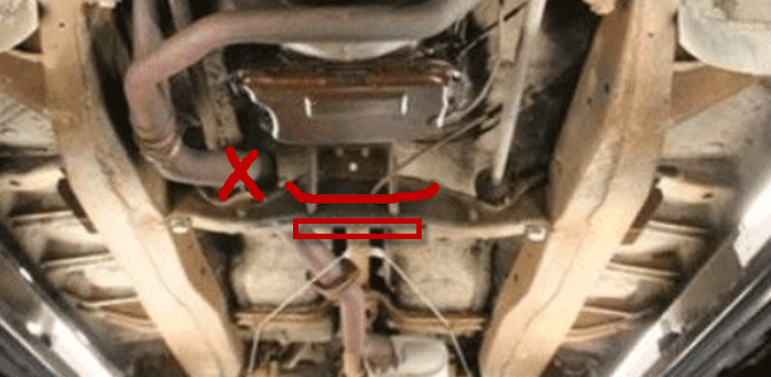

Looks like you got all kinds of room. Just off the top of my head you will probably need to move the exhaust pipe, cut a big portion of that cross member top to make room for the OD part of the trans. Where I put the box I would weld a 1/4 to 3/8 piece of flat stock to make it strong again. The 2 pics at the bottom are mine on my 70. I had to use a piece of channel under my cross member for the trans mount stand but it looks to me that your cross member is much bigger than mine so you shouldn't have to do that.
If you are planning on pulling the engine and trans for a rebuild anyway I would buy a junk or core 518, drop that cross member out and slide the 518 in its place as a mock up. If you don't like what you see or then stick to your stock set up. I suspect it will fit pretty nicely.

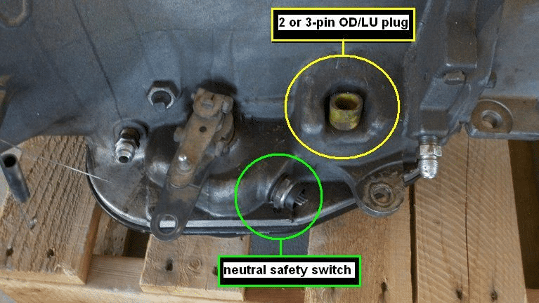

Oh one more thing before you buy the trans make sure you get a pre 1992 (I think) You want the one shown below with the 3 pin, not the bigger 5 pin. The newer trans has a electronically controlled governor and you need a computer for that. The 3 pin you just need switches for the OD and LU.
