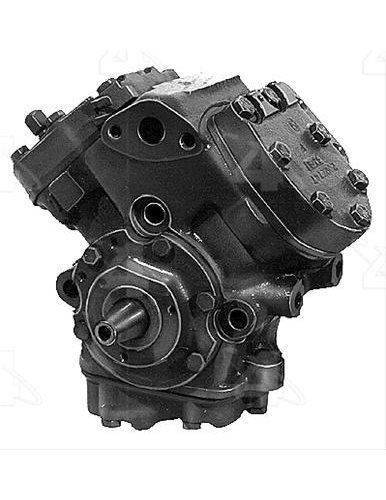

Unfortunately the compressor was removed last week because the shaft had sheared. Here are some pics of the remaining brackets. And the clutch off the compressor
OK - 66 Polara with 318 wideblock. That helps.
That clutch looks exactly like what are on my cars.
Remember that a pic on a parts store website may not look anything like the actual part - often they substitute a generic photo of a similar part.
You realize that if the shaft sheared you need a new compressor, right? You can buy a compressor and clutch as a unit.
