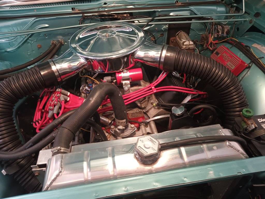

Hello all. I have a 1968 Sport Fury that was originally a 318 car but now has a 440 stroked to 496 by Hughes Engines. It stays cool with a 23" two row 1" each aluminum radiator. I plan to install vintage air but would like to have a 26" radiator. Does anyone know where I might find a 26" core support? Any help would be appreciated.
Thanks, Tim

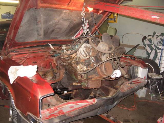

It can be swapped out without removing the fenders and bumper.

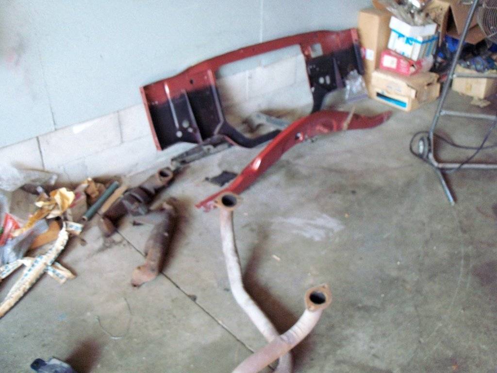

Been there, done that..

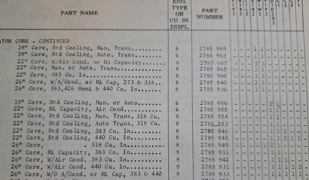

Based on my 1967 parts catalogue, the 26 in rad core is the same for Plymouth, Dodge and Chrysler.
2785 931 and 2785 933 are the most common ones that interchange.

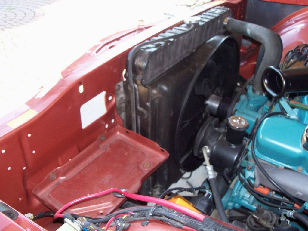

I used a 67 core in my 68, just for example.
