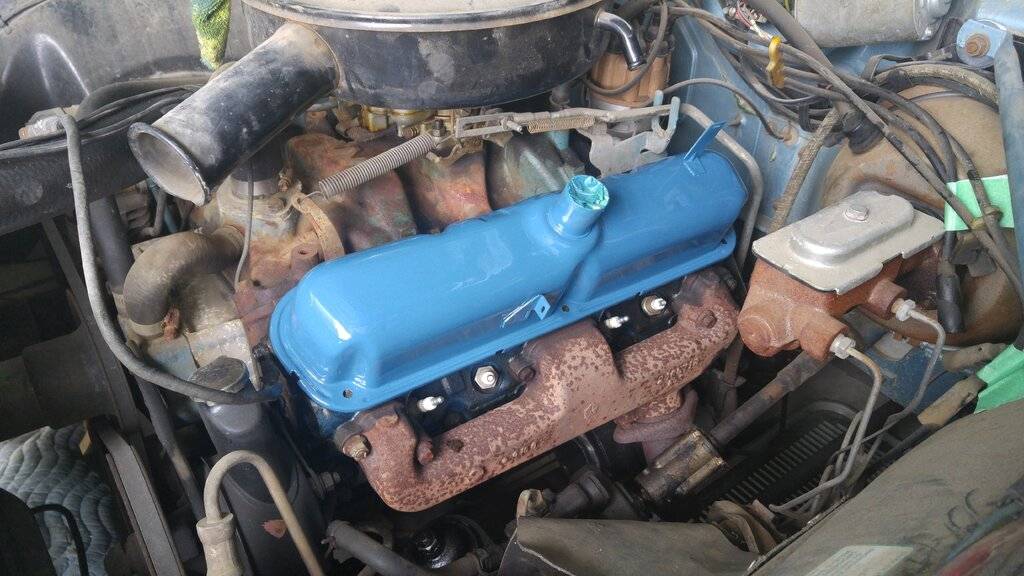

Well this gets better, I figure I would switch to something I can do and that is put on the mopar performance valve covers I got for Christmas a couple of years ago. I had the mechanic fit the PVC and breather for me. As I go to put the gasket on the valve cover I find out the valve cover only has 5 holes for mounting to the head, bottom line wrong valve cover. Right gasket for my car but wrong covers. Any idea what engine they might fit? Probably a small block since they appear to be smaller. Anybody in the market for valve covers?

Does the bolt hole layout look like this? This is from a 318, 5 holes...
looks like the bolt pattern. I was looking on line again and they look like they are for the small block. They are the black and silver die cast valve covers. Each cover has a oil fill and a knockout. I had both knock outs done with a pvc valve in the one valve cover and a breather in the other.
