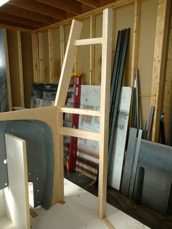

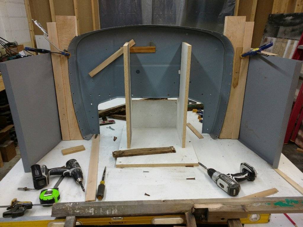

matt , just like a gm chassi and a fisher coach body , wound if it was a farmed out to a bodyworks . its a cool piece to do . maple for framing , a bud had a cabinet builder do his wood framing , 34 chevy was just a flat pile of tin when he started it , looked cool done . he did a 34 chev p/u next . all steel tube on that rod . would like more pics as you as it comes along . very cool project .

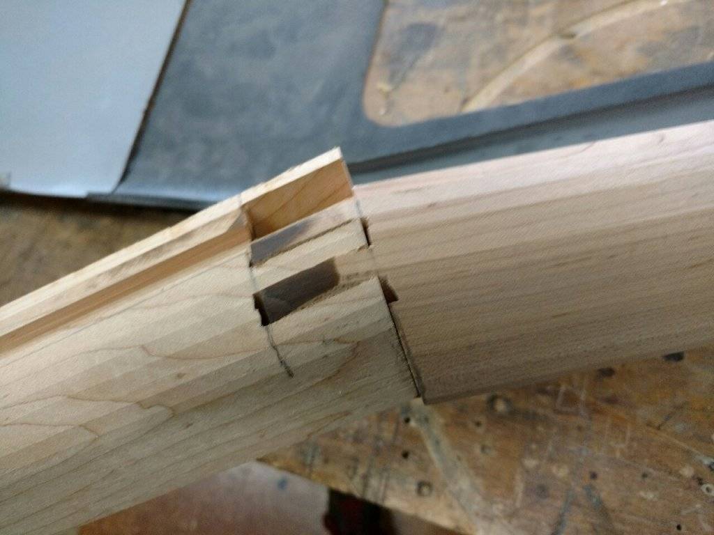

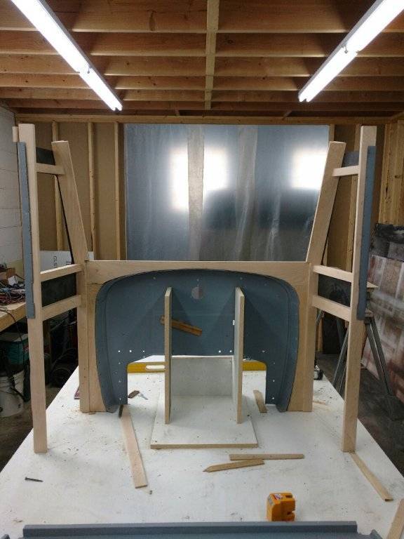

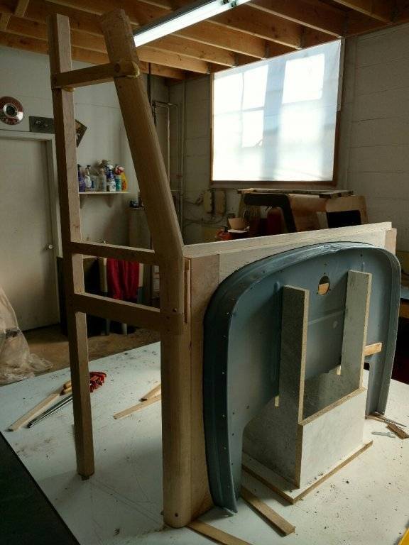

I had to buy 8/4 maple in the rough to achieve some of the pieces that were no less than 1 3/4" for its smaller dimension.

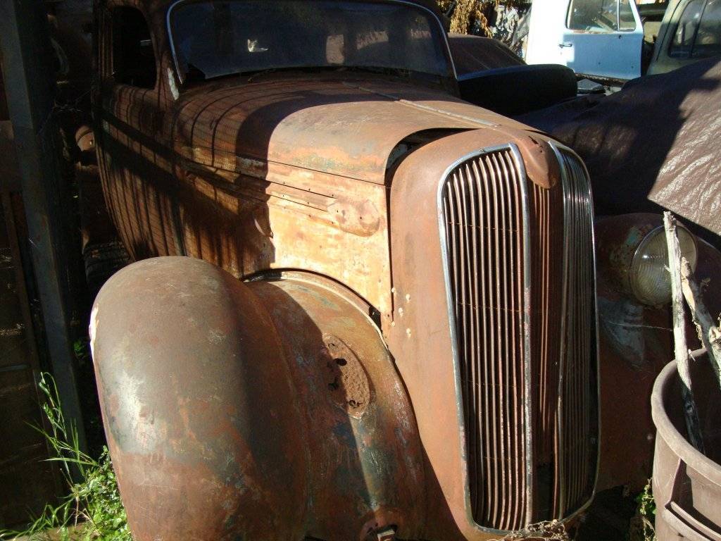

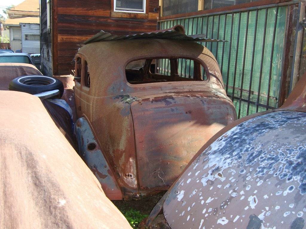

matt , ever build a woody wagon ? was thinking two door woody on my 36 plymouth . your making drawings of what your doing before cutting , right . or is it more off the cuff ?

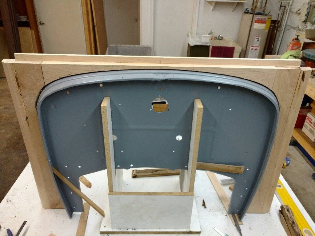

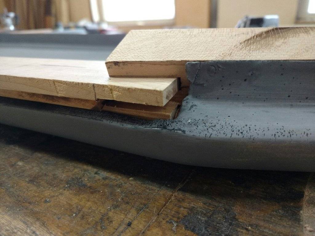

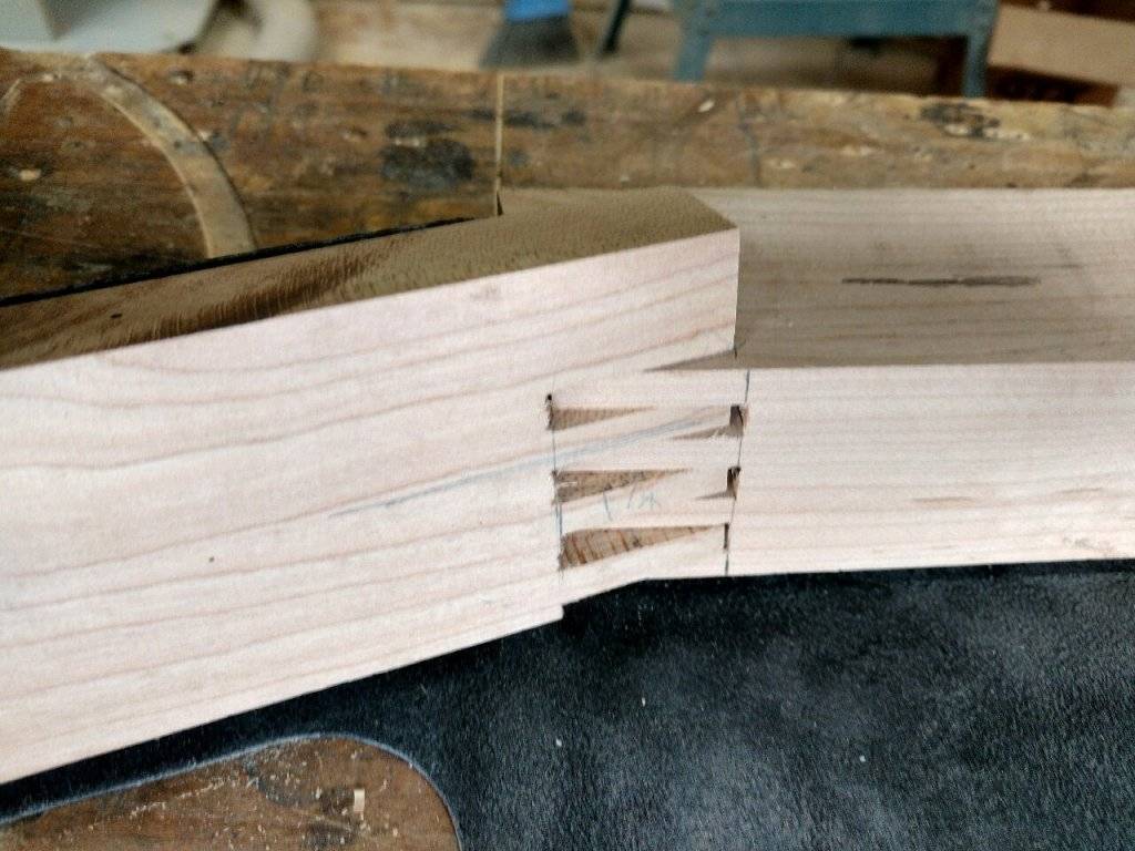

No drawings on this. I am 100% certain that this is the only vehicle that this lumber will fit. After these vertical assemblies I will move on to the front floor and then the bed and bed sides, all of which will be a piece of cake compared to phase 1. At this point the owner hasn't decided if the roof will match the pictures or maybe only cover the front seat. Also undecided as to whether it will even have doors, probably depends on budget. The joint below was fun, there is a left and a right at the base of the windshield A-pillar. There is one square edge between the 2 pieces being joined and I cut each one of the slots of the finger joint individually. They look like they were originally done with a high speed shaper but I don't have one and I could possibly have gained access to one but I enjoyed the challenge and it was only 2 joints.

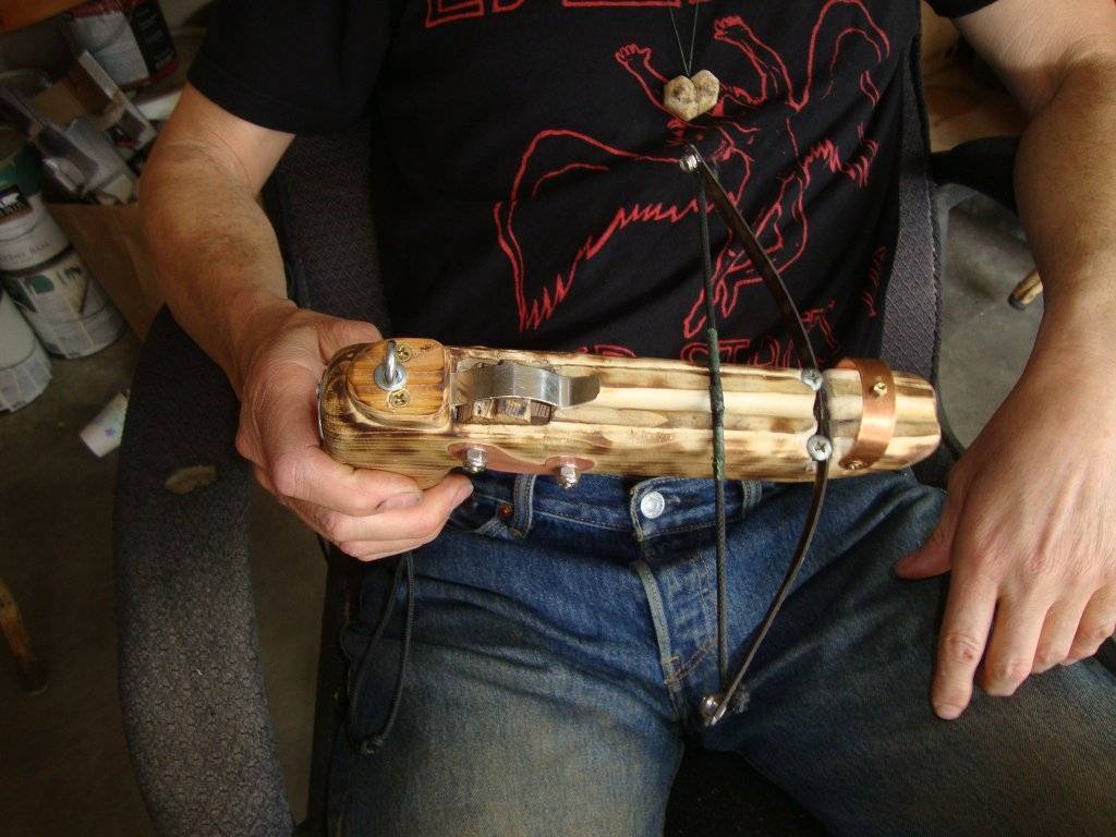

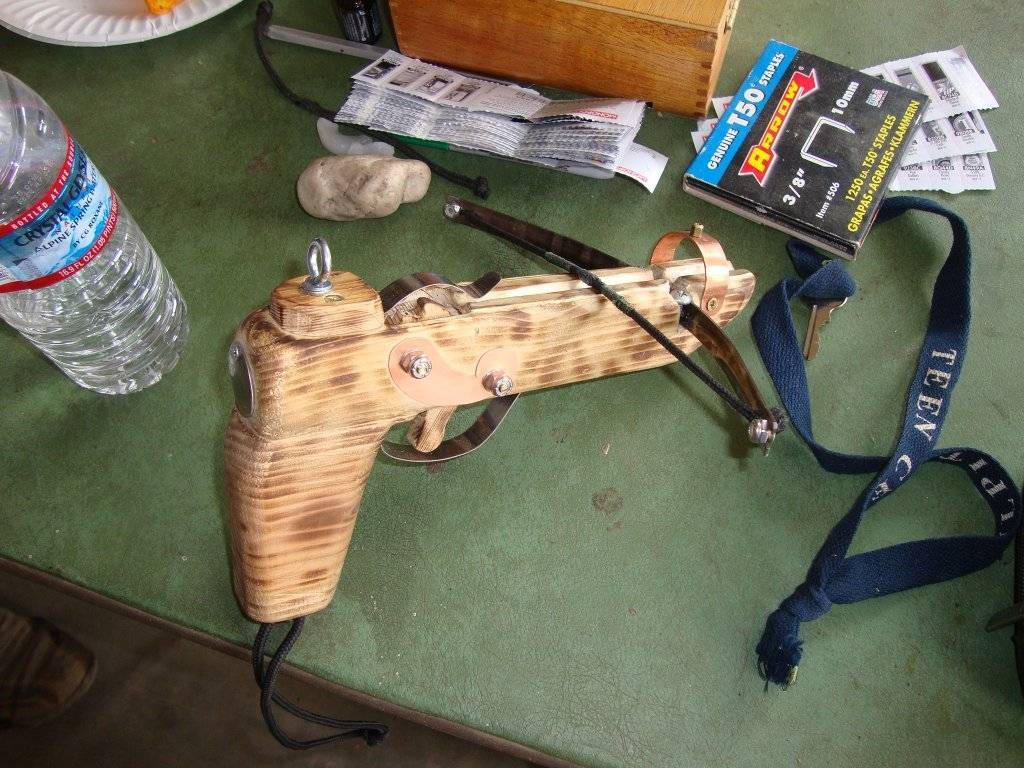

that guy is great , watch him . got me to build my own door casings and finish trim from wooden crate matl my grandfather collected in the garage of this old house i'm living in . but here a couple pics of a bud that is disabled . but can't say still . dremal cravings .
He does great work, my hat is off to him.
