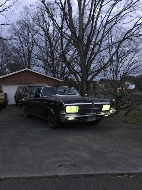

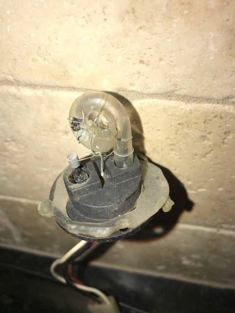

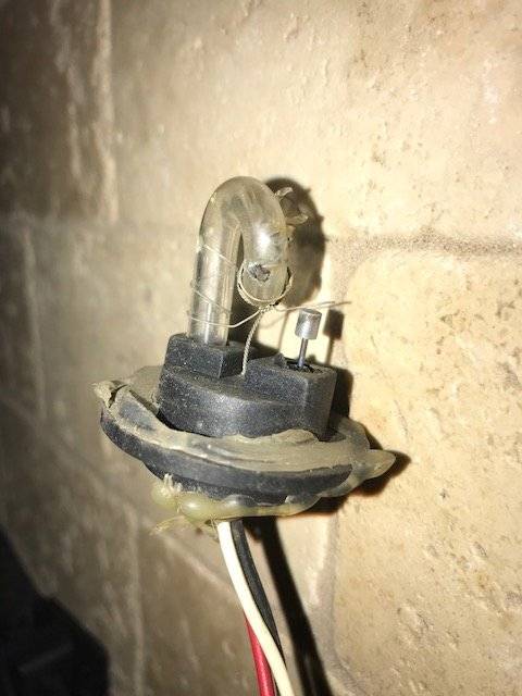

Does anyone know what kind of lights/bulbs these are?

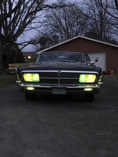

Its a curly neon looking type bulb. They are added on my green hornet imperial - and none of them are working. The original headlight bulbs are gone and aftermarket housings are in their place. Two of the headlight bulbs are HID. Then the other two headlights have these bulbs in them. They also added these bulbs in place of the reverse bulbs, and added two into the sides of the front parking light housings; six in total and none of them are working.

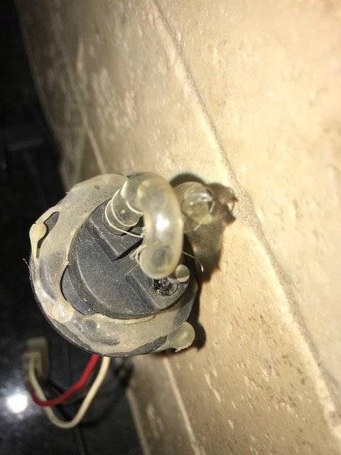

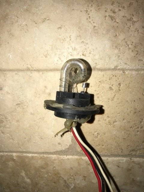

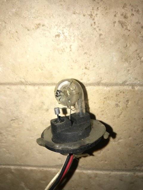

Here are some pictures of one that I broke:
I've never played with those, but you're likely right, some type of gas and the curled envelope will increase the gas volume and most likely the lumens. Just give Kato a call, eh??
The HID would probably be some kind of conversion kit Those 194-types might be similar, but the HIDs require some sort of high voltage converter, but that wiring doesn't seem to support that?
CBODY67

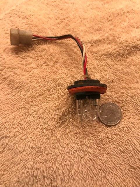

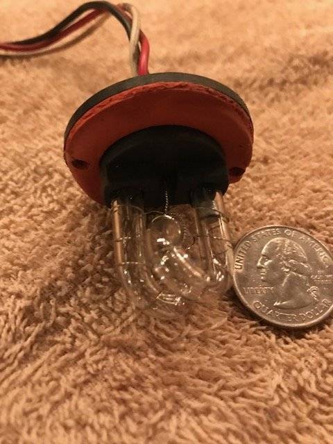

They're strobes. You would drill a hole in you factory light and install them. Used in LE, fire, construction vehicles, etc. They came in 2,4,6, and 8 light packages along with a control box.
So THAT means there should be a control box somewhere?
CBODY67
They won't work without one. Depending on the brand, Whelen, Federal, Code 3 to name a few. You had lots of options. Flash speeds, patterns, etc. LED's have made strobes obsolete.
