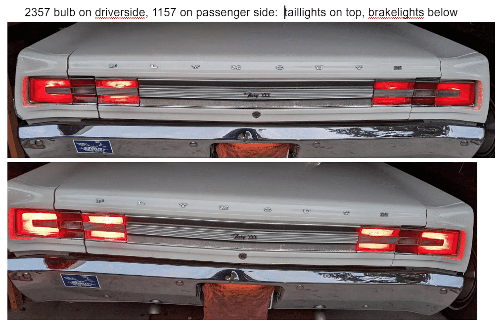

I discovered an incandescent upgrade bulb for the 1157s for our brake lights (and probably amber front turn signals too).
Bulb 2357 is a drop-in for the 1157.
It has the same candlepower for taillighting, but is brighter on brake lights. (although I think the taillight is a little brighter also)
LEDs would be a superior improvement, but trying to find a set that meets specs and is bright enough, and fills the light cavity without being spotty, well, it's a gamble.
Below is some light reading, pictures will follow.

There certainly could be some disparity in how the camera captures the difference in brightness from the rear, depending on the angles between the camera and all the fresnels in the lenses.
But the shot on the inside of the garage door seems pretty objective.
