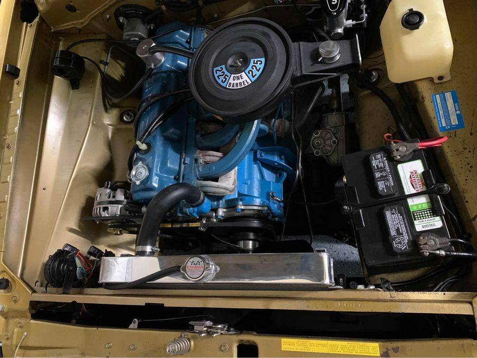

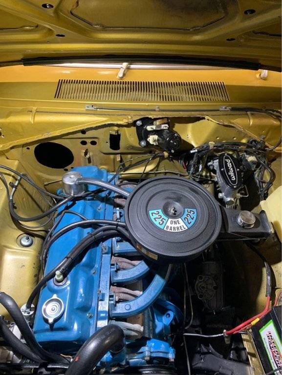

1971 slant 6 225 3.7L 3787cc w/ 1BBL Holley 1920 carb would like to sell the engine (air-cleaner to oil pan) and 904 trans to someone looking for a complete turn key setup. Can also consider throwing in the new 2.5” TTI exhaust system and new Aluminum Champion Radiator and other extras. OEM A/C system Drop it in your Mopar or hot rod rat rod

That’s a good deal! I wish that was available when I started this project. I’m slightly tempted but, no. Although this would be a great combo for someone.. my car and this engine.
