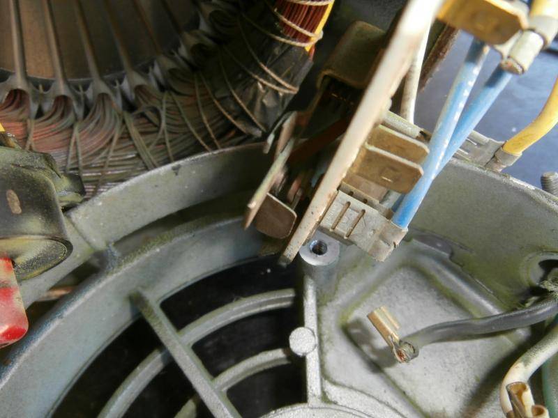

I may have found the problem. Looks like burnt points. compressor motor 001.jpg
From the photos it looks like an induction motor - centrifugal contacts may need burnished; did it to my 1965 Dayton sump pump motor after replacing the bearings.
I did clean up the contacts and put it back together. It seemed to work fine. We'll see how it works when I get the belts on. Thanks for the help all.
