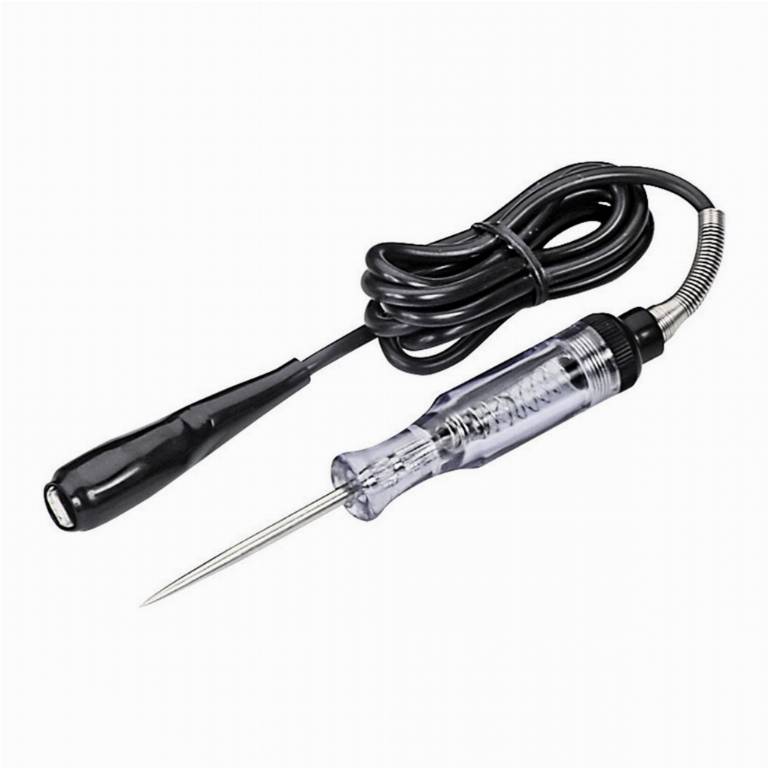

FIRSTLY...
Do you have one of these?
Apr 27, 2021
138
119
Minneapolis
I'm very disappointed at how this thread to going.
It literally takes 15 minutes to TS this. SMH.
FIRSTLY...
I do indeed. But like I said, I never even had to use it. When I removed the kick panel, it was obvious that all I had to do was reconnect the pigtail that had fallen off of the circuit breaker. Everything then worked as usual. It really was a stupid-easy fix.
