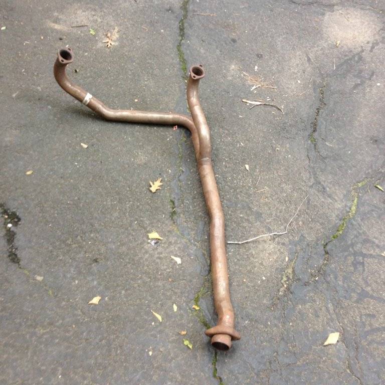

    I am doing a Y pipe for my 1971 Chrysler 300 with a standard performance 440 this coming week as well. I want to also keep it all stock. My 440HP cars get duals as the factory also did them.
    Like you, I just prefer stock.
    When I first got my car a couple years ago, I had the exhaust system replaced from the Y pipe back, with the guy copying the original system very well and I supplied the hanger that goes up in the rear wheel housing which was an NOS one. But after struggling with the original Y pipe and not being able to get the flanges to stop leaking, I am now having the Y pipe refabricated as original. The same guy is doing the work at an independent shop (not a chain) and he is an old timer who knows well how to do these systems. I can't recall what everything behind the Y pipe cost me the first time around, but it wasn't that much. He is doing my Y pipe up front as original for $180, although I have to leave the car with him for a day to get it made as he is a very busy guy and has to fit in other cars during the day too. So I believe a complete exact copy of your original system is doable nicely by an experienced older pro if you can find one in your area for around $500, and mine is being done in Southern California which usually isn't known for anything inexpensive.
