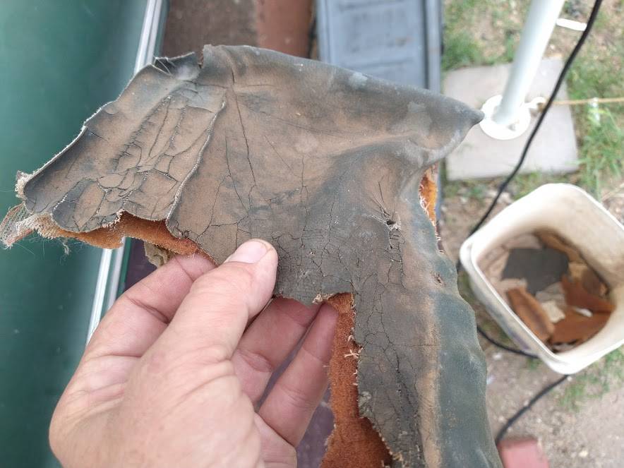

It fell apart when I sneezed on it. Tom cat piss, Arizona sunshine, winter freezing all combined to destroy the exposed green Naugahyde, thin masonite beneath that and the glue that once held it all together. I never concerned myself about this until one evening, when taking the family to church, a female cat poked her head through a speakerhole and the covering decayed stratum. The miserable ***** had nested in the trunk while I was working on the car earlier that day. After that incident, I knew the package tray persisted only by Newton's First Law. (inertia)

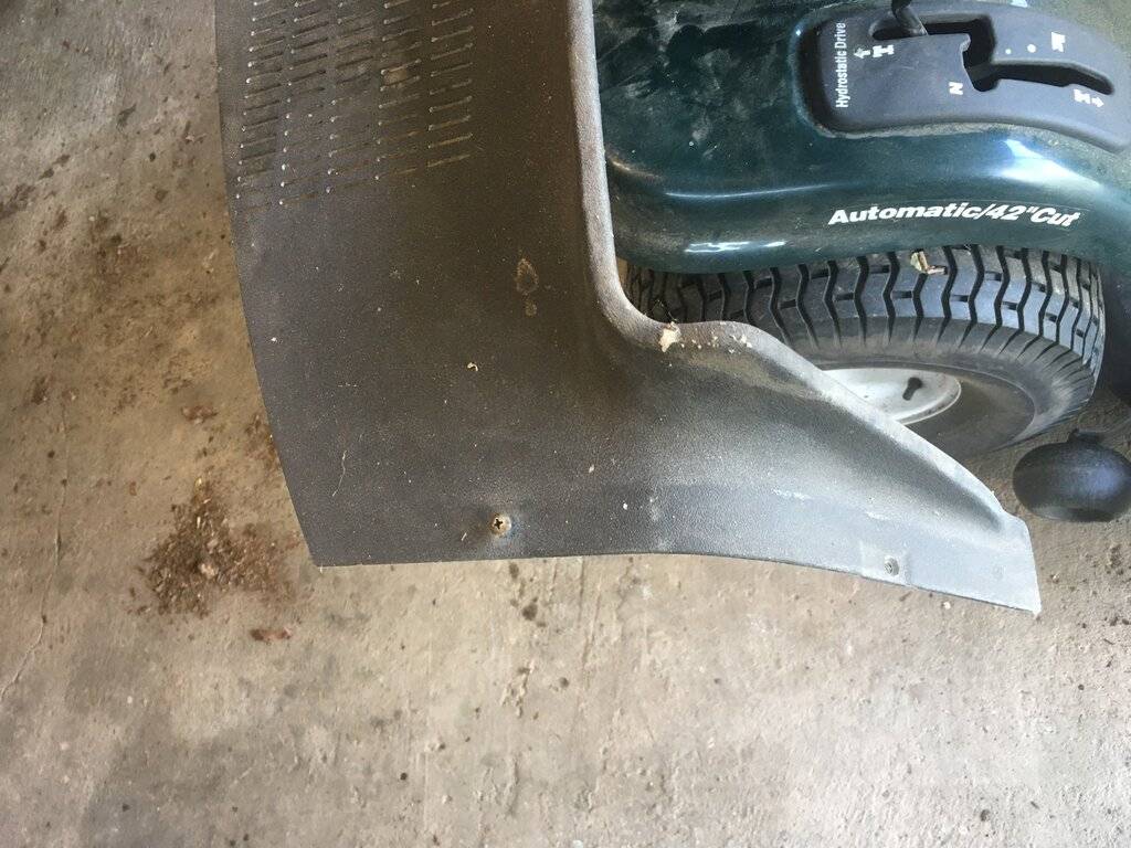

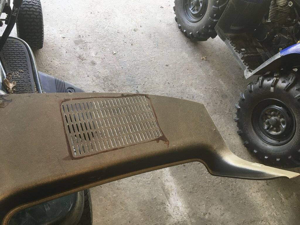

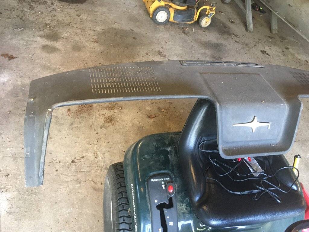

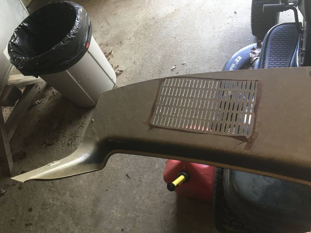

FYI . . . these shroud-style "molded" package trays came in two styles - the pressed fiberboard type, and a fiberglass type. I concur, the fiberboard type will turn to dust if you look at it wrong, but they CAN be repaired if you're VERY careful, and it's not too far gone to begin with. The fiberglass ones are far more durable, and do turn up from time to time. Neither is reproduced to me knowledge, and I'm guessing they never will be . . .
I believe that fiberboard was used in early cars, and then transitioned to fiberglass style, either late in the 65 MY, or early in the 66 MY run.

No doubt fiberglass is more durable than a layered board consisting of some THIN masonite (or the like) on the bottom, a thinn layer of foam rubber padding, then naugahyde. I must say, the naugahyde still looked fine where it had been rolled under the top of the rear bench seat, thus keeping it completely in the dark. I also discovered, once I progressed some in cleaning up the decayed mess up top, that my rear window isn't original to the car. Some time over the past 55 years, the rear window had to be replaced. The shoddy work on this doubtless exacerbated other weathering. I just thank the Lord that the damage stopped there. I suspect this work to be at least 30 yrs old.

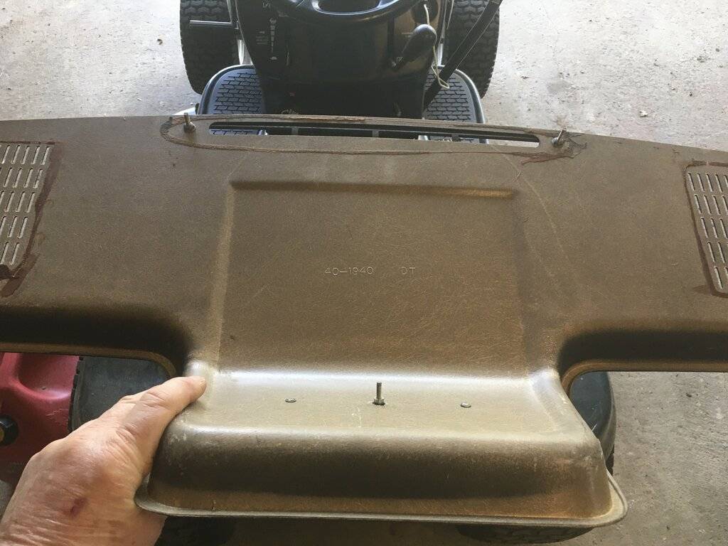

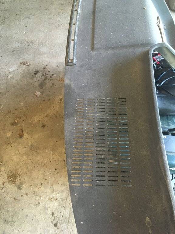

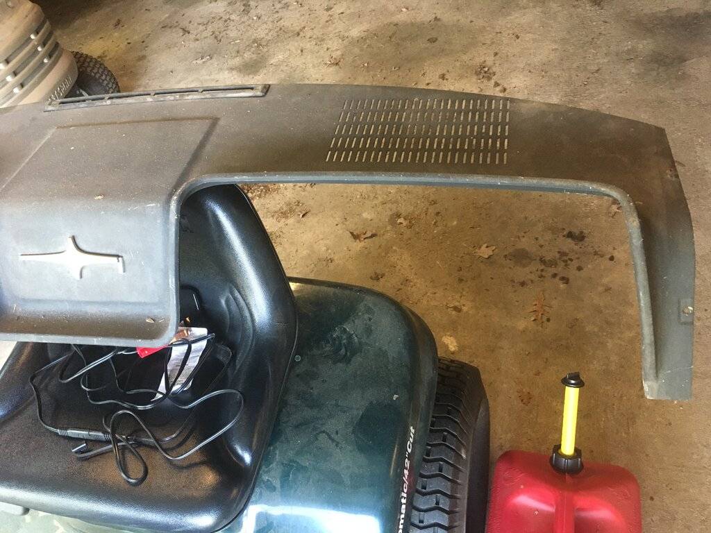

Here is a fiberglass package tray I just retrieved from my Arkansas stash. It is already spoken for, sorry, but I was reading your post with interest in learning what is hard to find, not being reproduced, etc. It makes me wonder how hard it would be to make a mold? Any ideas?
