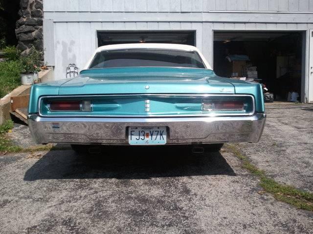

Well, it took longer than expected, but round 2 is finally complete. I must say, it has just been one thing after another. First, the converter had a different bolt pattern, so in came a new flexplate. Then, we found out the radiator core was cracked and almost unfixable, so I had to get a new radiator. Then, the temp gauge shot craps, so I had to have it warrantied. Finally, I discovered a split in the sidewall of one of my new tires, so I had a replacement shipped to me. Whew! Now that it's done though, the difference in driving is dramatic! The converter, shift kit, and gears really woke the car up. It is much quicker away from a stoplight even with less throttle. And with the Sure Grip, I can now blow through my tire budget twice as fast!:3gears: The new KYB shocks really firmed up the handling too, without adding any harshness. I also finally got those "frame tubing" tips changed out for some more subtle ones. In addition, I installed a trans cooler, got the windows tinted, added a proper side mirror, got some color matching (well, close anyway) floor mats, and added a cool vintage, "no name" tach I found on Ebay. It's been trying at times, but she's really starting to come together!:grin:
Awesome! Thanks for the updates .. hows about you get a friend with a camera and take us on a virtual ride along
KYB's are amazing shocks and a great suspension improvement!
x2 on the pictures request.

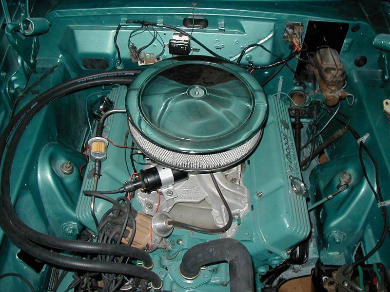

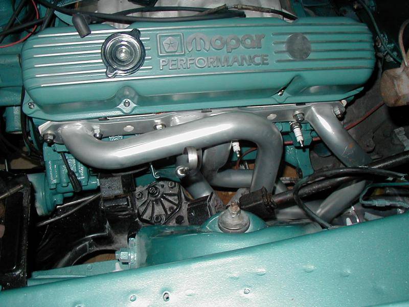

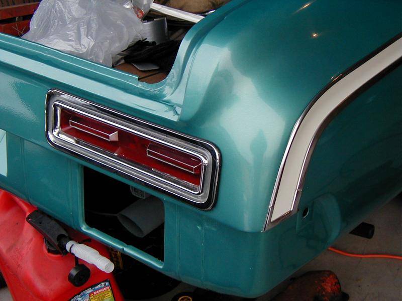

Well, I will fall somewhere in between those, but definitely closer to the first pic. So I guess that puts me in kind of semi-chub territory then? :laughing7: There is some chrome, but just a few bits to set off that beautiful turquoise! Here are some in progress pics so you can kind of see where I'm heading with this thing.
You could always consider something like this...this was the engine in my 63 Dodge 440.
