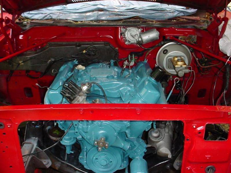

I didn't remove the engine, but stripped it to the block, heads, intake and removed the inner fenders after a through power wash.
I painted the red first, then the engine and lastly the black sub frame, and componants. Everything else got refinished befor reinstalling. The tubs I had sandblasted and then painted the engine side semi gloss black and the underside with rubberized undercoating. Bare metal parts got a rustolium crystal clear coating and the air filter housing was black wrinkle powder coated with a steel powder coated base plate.
Lots of masking tape and paper. Most everything was done with parts store rattle cans.

Let's see it.
x10...........WOW!!!
Wow is right. That's how you do it right there.

Nice, you have a lot less patina under the hood than I do. Damn......you have a thermoguard cover. Did you put in the heater hose flush valve?
But it needs a refill.:laughing4:
