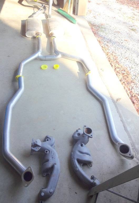

    There's really no difference between an X pipe and an H pipe. The X crossover will work better in a chose area. TTI offers an H pipe for C body's, I have one on my 69 300. The large factory style mufflers will best reduce the resonance normally heard in the 40-60 MPH range, especially in a convertible. Sound deadner under the carpet goes a long way to help also.
