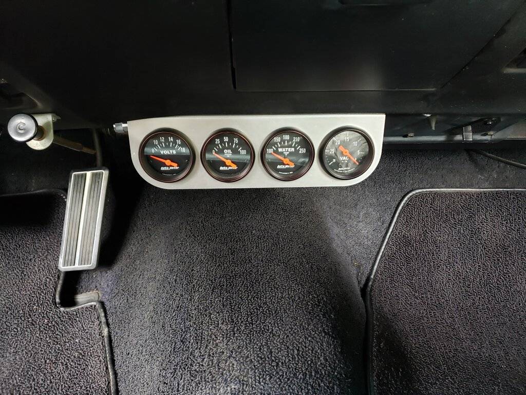

I’m currently installing an electric pressure gauge on top of the idiot light for peace of mind...

I have always worried about mechanical oil psi gauges and the possibility of a quick oil slick on my carpet ,under dash or hood. I do use a mechanical in my Omni and never had a problem but in my Fury I went to a good quality electric . My idiot oil pressure light works and between the two I can grasp if anything is really wrong.

I have used a mechanical oil pressure gauge and copper 1/8” tubing. I bent a nice ‘s’ shaped strain relief between the adapter and the interior fender liner to reduce the chance of tubing fracture.

I've always preferred the accuracy of mechanical over electrical, and don't want an oil spill on new carpet!
yeah I was actually planning on going a little different route and route on the exterior near cowl vent( a little unconventional but I've seen some nice set ups)
Mechanical gauges aren't much more accurate. Another old wive's tale.
If you don't believe me, I stumbled across this: https://www.chevyhardcore.com/tech-stories/other-tech/autometer-gauge-selection/#:~:text=“A typical AutoMeter electronic gauge,-world accuracy, very durable.
As he states in the article, the Autometer electric gauges are +/- 5% at full scale. From my 22 years in the world of gauge calibration, I'll tell you that's about the same as most aftermarket automotive bourdon tube "mechanical" gauges. The higher end Autometer gauges might be better, but most of the gauges you buy aren't.
