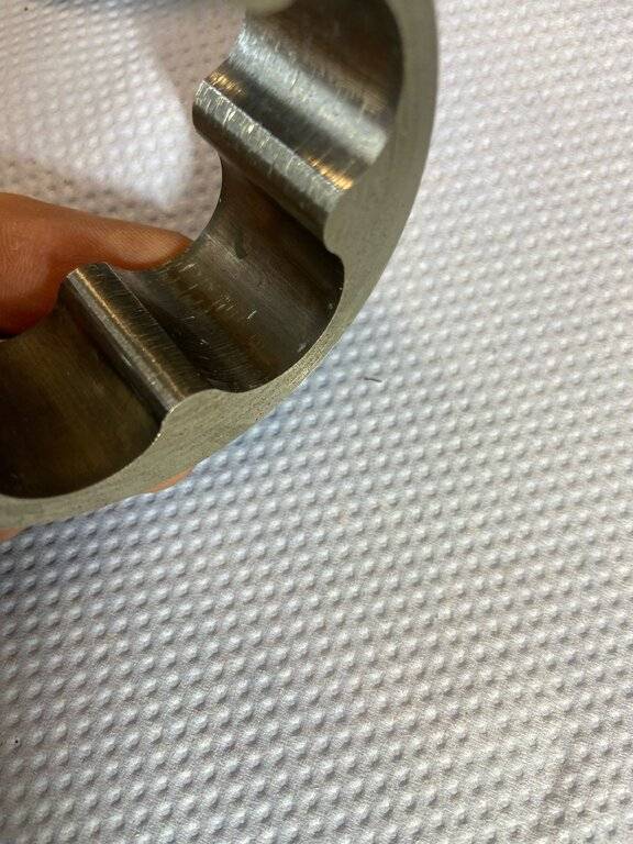

I think that could be the reason for low oil pressure

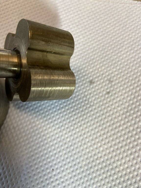

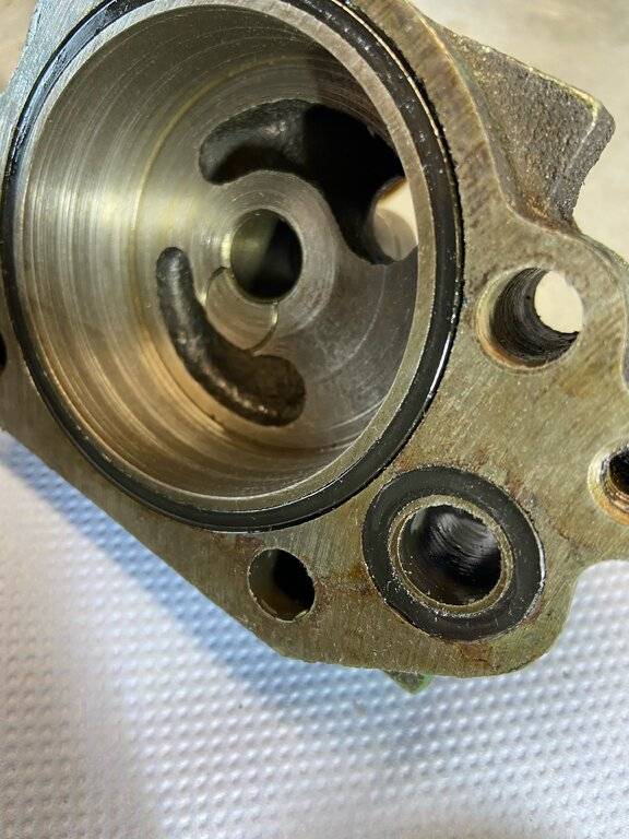

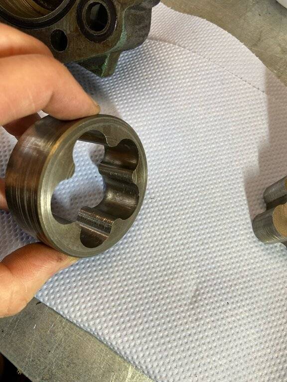

Yes, your oil pump is fukt, but WHY is it SO? That appears to be caused by a misaligned oil pump shaft. I just wonder what else is so badly skewed in your engine now. Get ready to replace some cast iron I say.
Oil pump looks to have been pulling hard metal from someplace, maybe itself. Unless something was very off from the installation, it is rare to see a pump that badly scored. I have seen this on race engines, usually because a cam shaft got wiped and lots of hard metal was thrown about. On a street engine I would suspect oil without the proper additives may started the process of making the cam go flat. Replace this pump for sure, but I suspect there is more trouble down the road. Drain the oil filter and check for metal shavings.

I had low pressure already since a few years. Therefore running SAE-50 oil which is for the worst case. (I drive the car in the summer only).

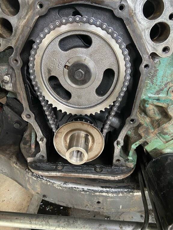

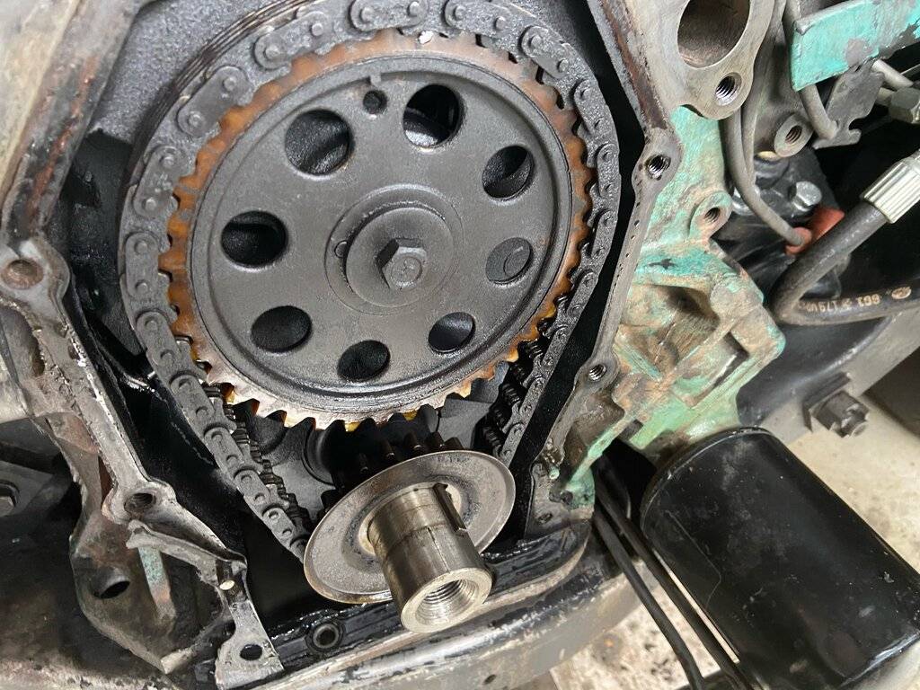

I had a time when I did not know better I ran standard 20W50 with low ZZDP content for a few years, but still very low mileage. Cam lobes still look good. I hope the loose particles where catched by the filter. Replaced the pump. Filter is still in the bin in my garage. I will open it up, but I bet it is clean (1300 mls. Since previous oil change). I will not open the pandora box. Just changed timing gear set.
Was still the first set with polymer gear, but not looking that bad. I will continue driving it, until it will fail. Running a bit two stroke oil in the fuel to support valve guides an pistons lubrication.
