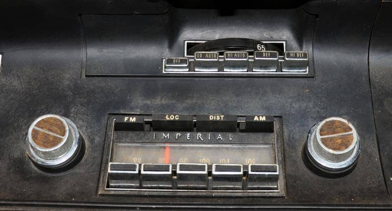

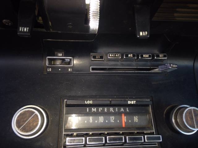

69-70 have auto temp I? Pic of a 70 unit looks the same as an A body controls, IDK?
Have chosen a plan on your 69? Seems like you take the same risk with the cheaper unit...
I have the Autotemp I on my car. A/C is one of the last things I'll do on my car but I'm gonna fix it someday. No conversion to manual here.
That's the ATC controls
