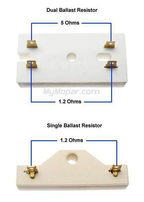

Thanks.
Just have to make sure the dual one isn't mounted upside down.
Notch faces passenger side. Got it.
Thanks.

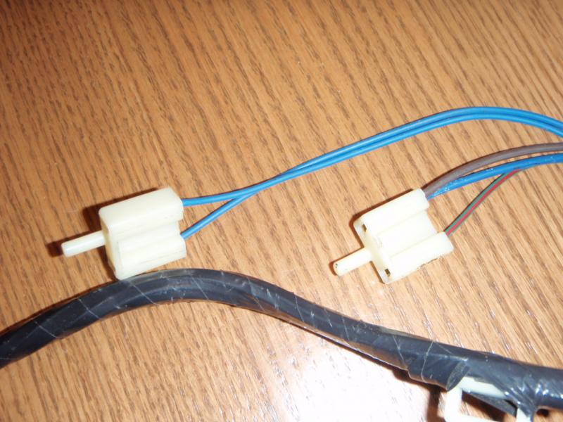

The factory insulators for the wires should have a post sticking out that indexes into the slots.
20120211_1001-jpg.57357
