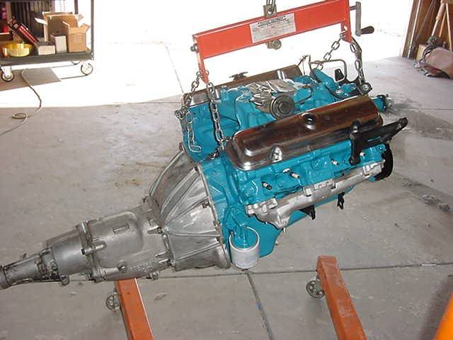

If you want to remove the trans at the same time, just remove the driveshaft, speedo cable, cooler lines and back off the torsion bars. Put the hoist in place and place a floor jack under the trans. Remove the rear mount/crossmember. Place an old driveshaft yoke in the trans or, if you don't have one, put a plastic bag and rubber bands around the tailshaft. This will keep trans fluid from making a mess on the floor when you pull it out.
Take up the tension on the hoist and remove the motor mount bolts and pull the engine. The leveler will let you angle the engine so the trans can get by the firewall. Watch the tailshaft of the trans once it's out. It gets swinging and can take a windshield out or dent a cowl up.

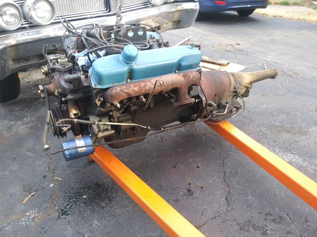

Got it pulled out today...removed the hood and it came right out with little issue. cleaning it next, then the work begins.
