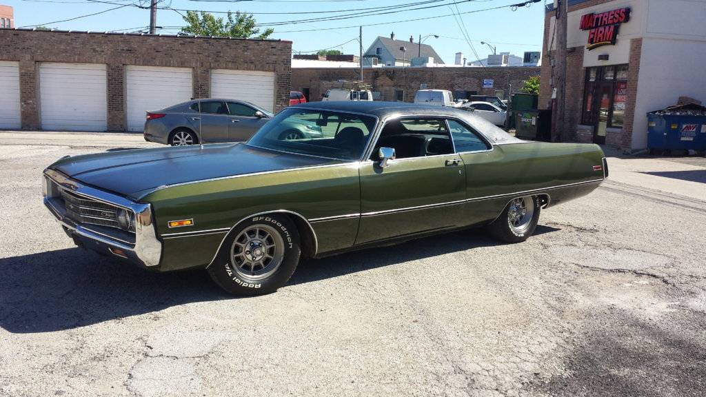

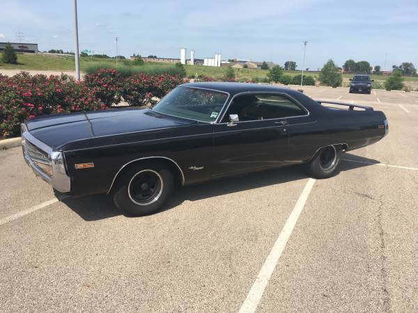

Here is a picture of My 71' Chrysler Newport Custom.
'71 Newports are road machines. You need to be a couple feet shorter to be a "street machine". On top of that your car was designed as a "luxury" car with severely low, overhanging quarter panels. 15x10s won't fit ( possibly with low profiles ) but how ridiculous would that look? Deep dishes aren't going to work either. Do yourself and your car a favor and find a good set of 15x7's and 235/75R15's, and call it a day. In your defense, these cars did drag their butts in stock set-up, an extra leaf slid into place with the others often remedies the problem. My '70 Newport convertible underwent the full '80's rocker transformation, torsion bars jacked up as far as possible and ten leafs per side and coil overs on the rear -
Hello Pablo and welcome. A very nice looking Newport, you should be proud! It would be fun to see it in person at the Volo C body gathering.
@Pablo I honestly do think that is a very nice ride as it is. Something I’d love to daily. But ultimately it is your car. You’re the one who turns the wrenches on it. Although it’s not what Chrysler intended at all - it is possible to do it tastefully and suttely to give it a more Muscle look. One the other gear heads and even C Body guys could appreciate. It’s a 2 door and a fusie so you at least checked off those 2 boxes. These are the only 2 71’s I know off the top of my head with the look but I’m sure there’s more. One of which belongs to a member here.
Well truthfully I did go abit down that path with my 69 Fury Pablo. I was a kid once and remember the extremes that these cars went through in looks ,good and bad. In the rear of my Fury I felt the 235 70 15's on the car looked like a girl in a skirt with too skinny legs. I went to a 15/8 steel wheel with 275/60/15 in the rear. The front I kept to 235/70/15s to keep the same outside diameter if I remember correctly. I also lowered the front end a tad.
