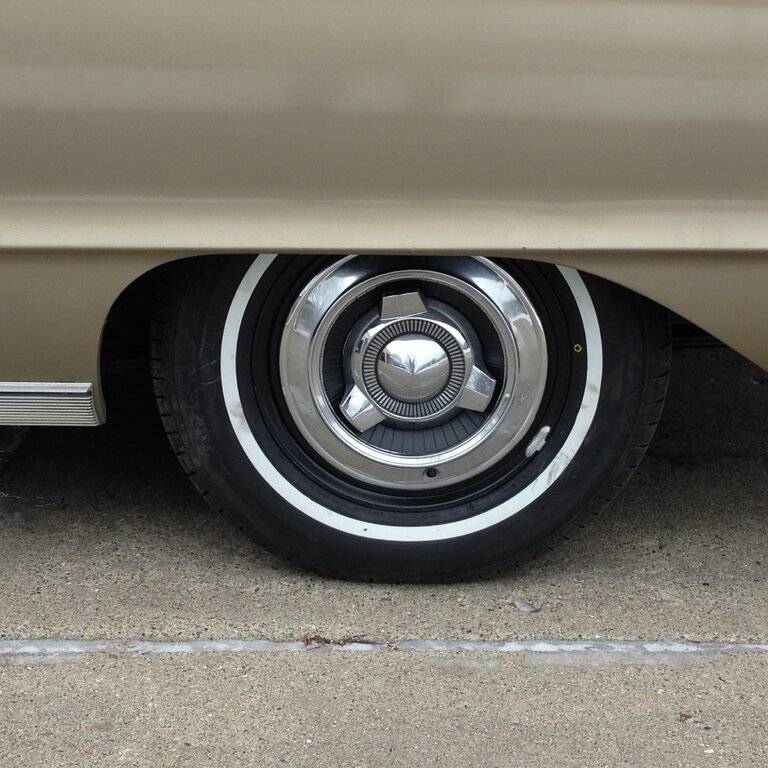

What is the secret to painting flat black backgrounds on hubcaps.
I imagine the factory used some template of some kind?
What have you guys used?
Careful application of masking tape.
I outline the black first with thin vinyl pinstripe type tape. 1/8” seems to handle the tight curves pretty well. From there I use regular masking tape and newspaper. Krylon Satin Black gave it a nice factory looking dull sheen.
Those were anodized originally, IIRC. Masking and painting with a satin black would look great.
Here is my first cover painted. Note the crappy masking job I did on the outer edge. Taping curves with regular masking tape is difficult. I tried the thin tape on the rest with much better results.
The center spinner is removable making painting the background easier.
As for paint adherence I had no problem with just a degreaser type prepaint cleaner. I used an old can of Prep Solve I had laying around. Paint holds just fine as I’m painting over the old paint and bare stainless or anodizing.

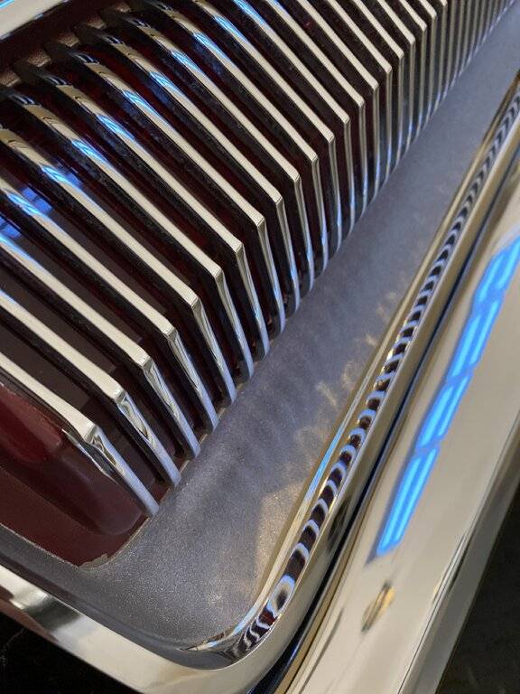

Here is a link. A little more complicated on the tail light panel. Had to do three different tapings. Once to spray the argent, and then tape up everything thing but what was going to be red. I started to tape each strip, but didn’t have the patience. So sprayed it all red and wiped with acetone with a rag wrapped around cardboard to just hit the higher spots. Spray wipe, Spray-wipe, until I had the coverage I wanted.

What do you guys use for the textured silver-gray areas? I think the bumpy shaker hood stuff might be a bit too bumpy.
Silver Argent. A little texture but not over the top.
This is what I used on my taillight and front bumper. Probably some use on wheels and hubcaps.
