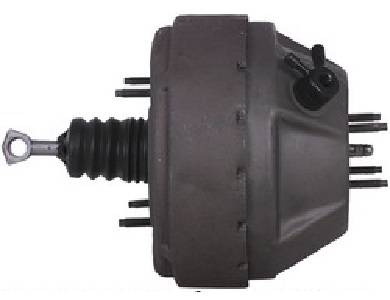

I may have gotten lucky but for my previous power drum 69 fury I got the booster + MC a few years ago from rock auto. Was a A-1 CARDONE 50-3600. No longer in stock but searching that number shows some available. I guess its true. But here is the kicker what I received from RA was a different booster. Part 54-73309. The booster is rounded and for 1975+ various models. It fits fine with some widening of the mounting plate hole that bolts to the firewall. The actual firewall hole is bigger and fits fine. The rubber bellows was too big/wide. Anyway it works great. Bolts line up. Pedal rod slightly longer but put the pedal at a better position then my worn out single diaphragm. It does stick out further into the engine bay - a little closer to the headers - but no issues for me.
According to this well known article it sure looks like they are using the same booster I have - C-Body Disc Brake Conversion - Mopar Muscle Magazine

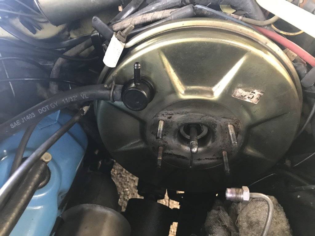

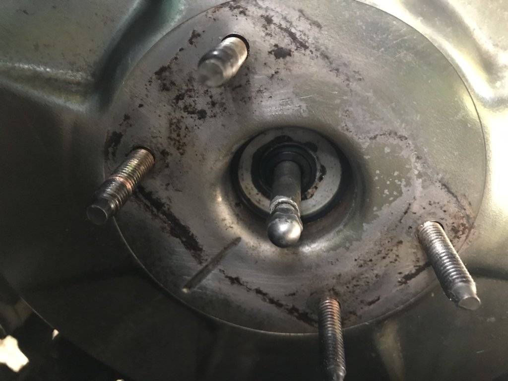

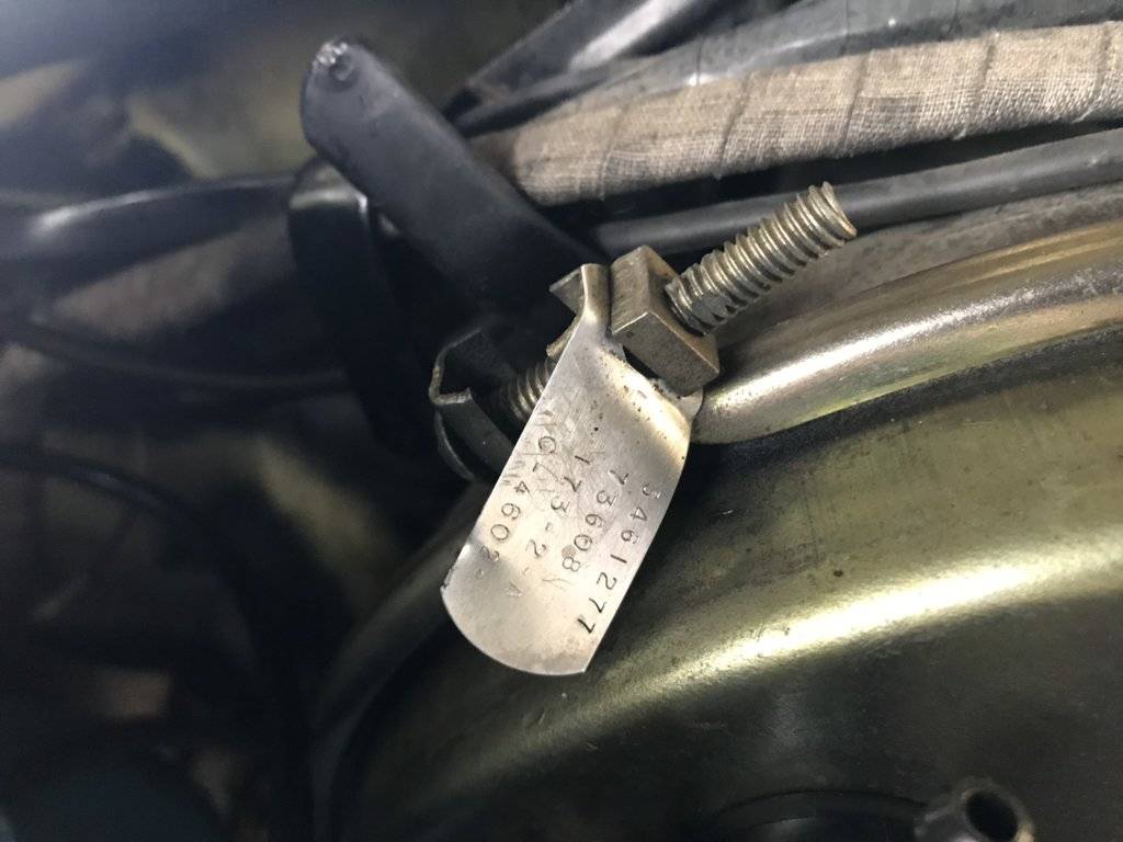

Here's my booster. The guy at Karps said it's a Midland unit, CD1. Overall it looks great, this is the original factory unit. I can't speak for the rubber internals, though.
