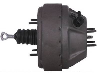

I believe it looks like this

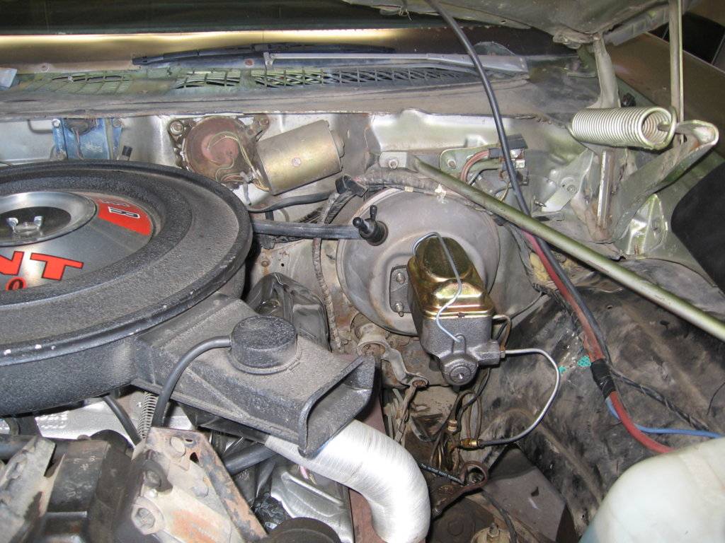

The mount flange for the '72 and later boosters is the same, main issue on a big block car that is '71 or older will be if the larger diameter later booster will clear the brace rod from the firewall to the front fender and the engine valve cover. The fire wall is a different design from '72 on that has more clearance.
