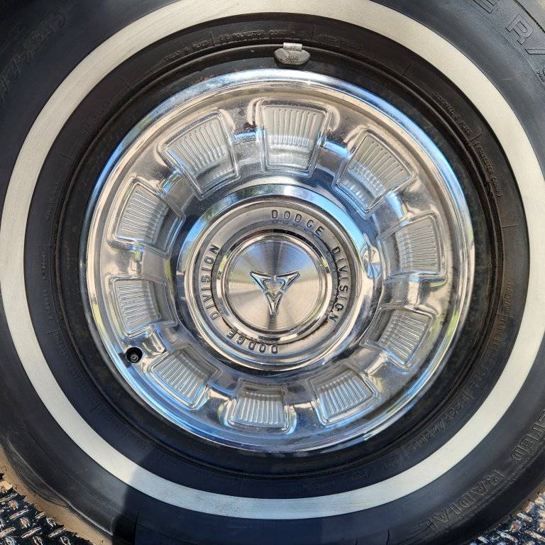

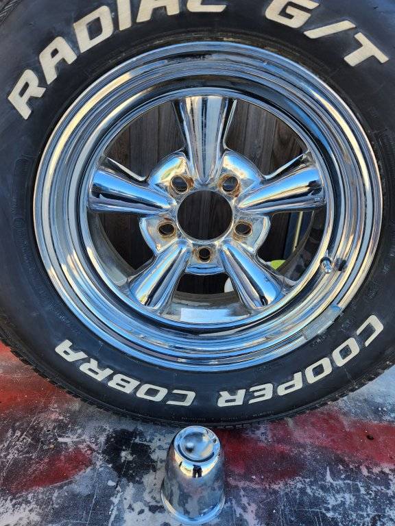

Ok, I have to buy tires for it and need to decide what rims to use. Stock Steel rims with wheel covers or I have a set of road wheels and a set of chrome wheels. If I stick with the wheel covers I need to find one more so if anyone has one they will sell let me know. What do you think?

I know a lot of our cars have them, but road wheels are hard to beat.

I prefer the 8 hole wheel covers but you don't have those.

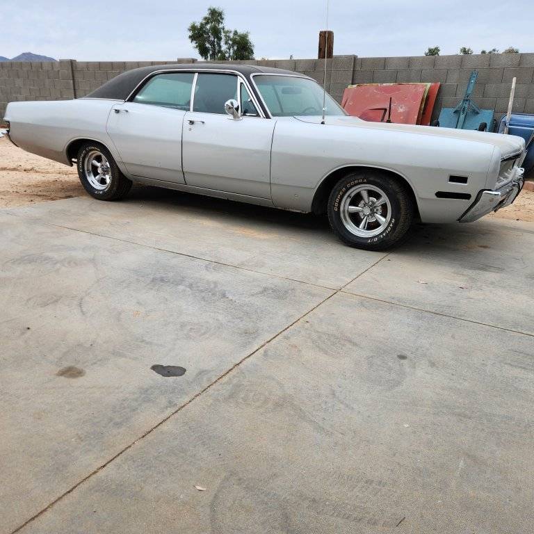

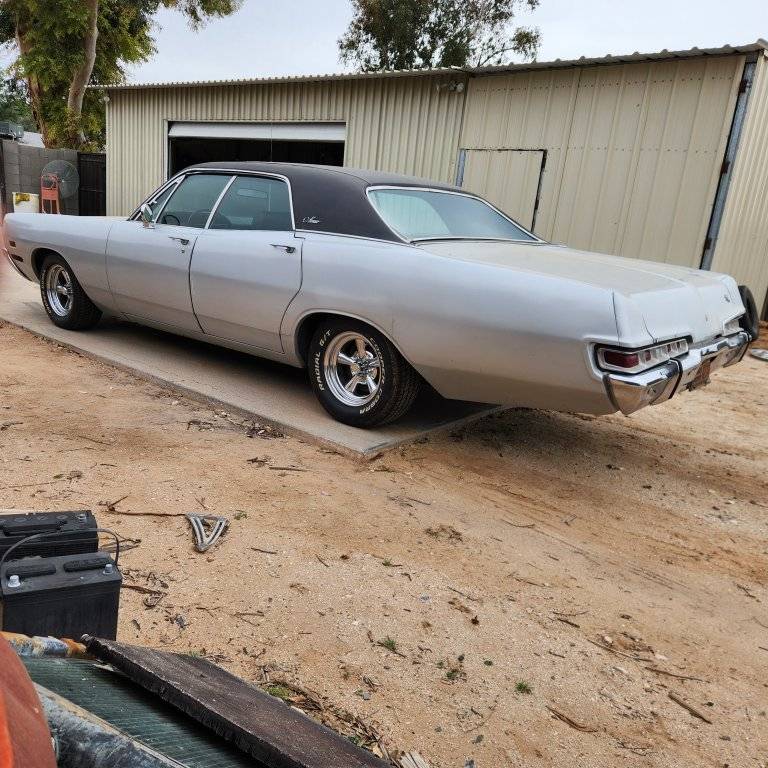

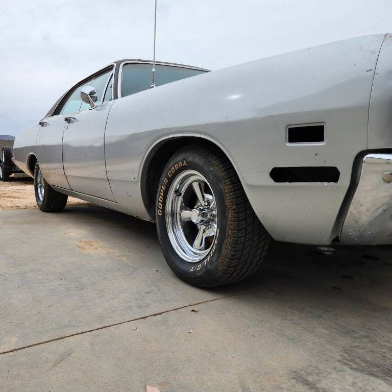

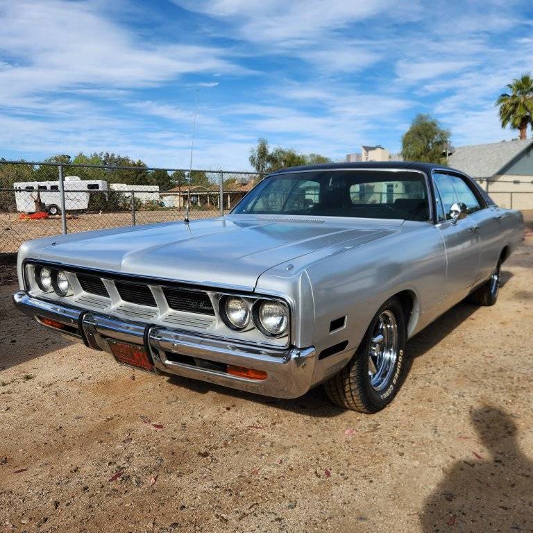

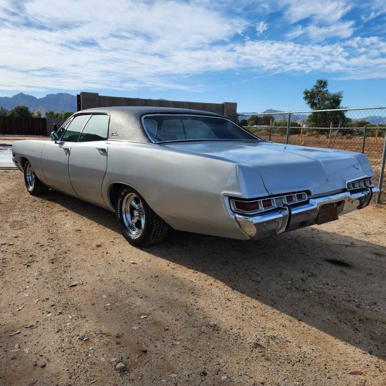

Well I figured since the tires on the chrome rims are good enough to run around town on I'd throw them on. Ran into a problem I hadn't even thought about, both left front and rear still have lefthand studs and so no lugnuts for them. Always something.
Lugnuts ordered. I decided to go with the chrome wheels because I like them but mostly because the rear tires are good so I only have to replace the two fronts since they are out of date and have a little bit of cracking. Fine around town but I'm not taking them on the freeway.
Definitely concur! Are you committed to going back to original color?
Will look great either way.
Yes as long as I can find the time. The silver paint job is horrible so it needs to be painted or else it makes me look bad! I could live with the silver if it was nice, but it's not.

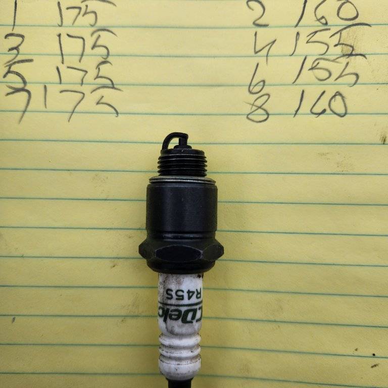

Was running a little rough so I figured I'd pull the plugs for a compression check. Well found the number 7 plug had no gap. So a new set of plugs and wires should do it. Compression was good.

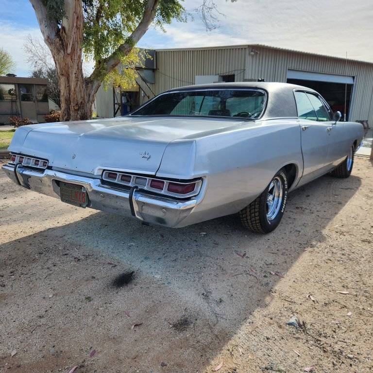

It got a little hot on yesterday's test drive so I picked up a thermostat thinking it was stuck. Nope, not stuck, not even there! Runs nice and cool now. Even washed it. Cleaned up well!

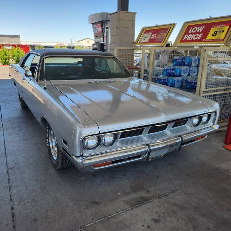

Well it's officially a driver now! Registered and insured (Haggerty) Drove to the gas station to put some fuel in. Was about 100 degrees out and it did get a little hot. I guess I better find me a shroud for it as it's missing. I will be posting a want ad but if someone has one let me know.
Found me a shroud. A buddy had one. I'll throw it on in the morning and see if it runs at a good temperature. Supposed to be 110 tomorrow so I'll know for sure.
