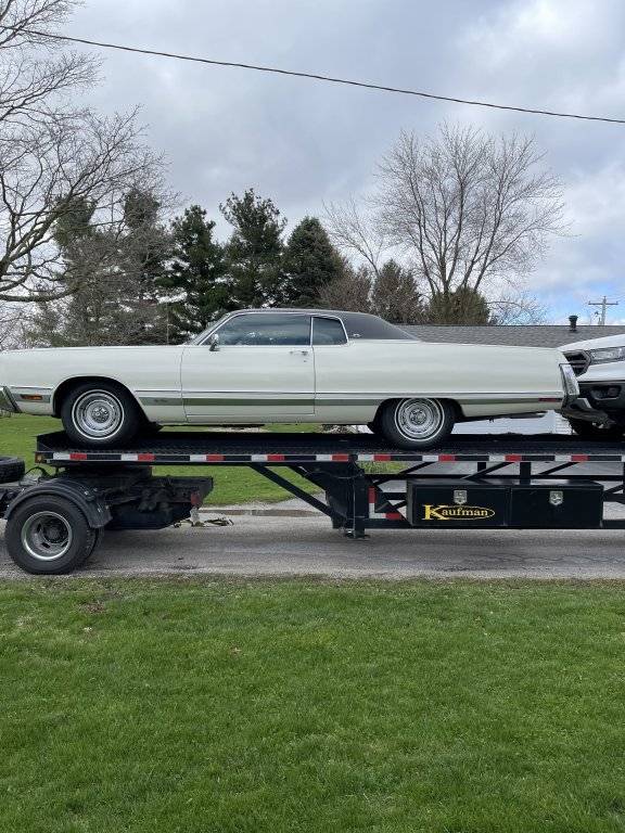

I am new to car restoration. I purchased my car a month ago with the agreement that my local mechanic would teach/help me to make upgrades.
Unfortunately the needs of the car quickly out ran his availability so I’m left hiring another shop to do all of my upgrades.
I would very much like to learn but currently have no one to learn from, YouTube videos are not enough in my case.
I live in Central Illinois and I was wondering if there was a network of people with C body cars anywhere near me that would be willing to teach a beginner a few things. Thank you

Welcome! So you purchased that good looking car with the intent of "changing it", but need help? What changes are you desiring? Just curious.

I would love to see more photos of your car.
I found your link just after purchase.
Nice NewYorker.
If the photos on Barn finds are current condition, you have a lot of great original parts under the hood.
Just come on here and describe your problem, you will get great feed back on how to deal with it. I found these low comp 440s need lots of initial timing, then curve the distributor to a 34/36 total mechanical and a working vacuum advance. This alone will give you quicker starting and bottom end power increase.
Nice NewYorker.
Streetside Classics in North Carolina is where I bought it from, It’s still listed on their website under the sold section they have about 75 pictures of it.
