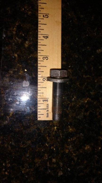

I have have a bolt that will work for now it is a 1/2" shorter but with the thinner washer and the unthreaded end I will work fine for now. Just want the Mopar bolt more than anything, for me. :)

I installed a grade 8 so I should be good.
Grade 8 bolts are significantly harder than grade five bolts, that also makes the grade eight bolts more brittle. Suggest you go with the grade five as they will stand up better under conditions of flexing and be less likely to cold work and break.
Dave
Dave
Good information thanks
How many marks on the top of the other bolts?
