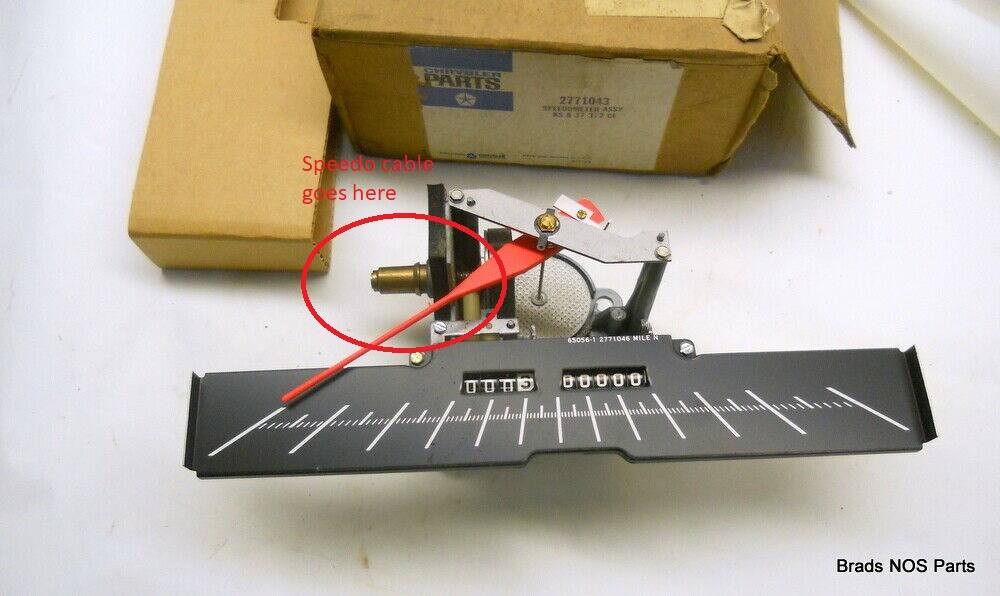

I have had a terrible time since the day I made the mistake of tossing the original speedo cable for the 68 Town and Country, but what am I missing here? I have looked at many instrument heads online and they all have the same 3/8" OD threaded fitting, while all the cables I try come with 5/8". Nothing fits, and not the clip-on variety. Did I inadvertently remove an adapter when I pulled the original cable off the instruments, and that's why it is proving so difficult to find a cable that fits?

I believe, in your image, that would be where the trip odometer cable goes. Speedo would be clip on.

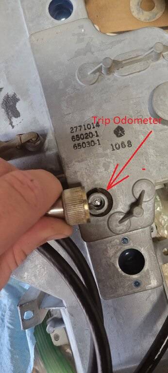

Trip odometer fitting.

Awesome, I was completely turned around and thinking the odometer reset went up top. I am extremely thankful for you guys helping me figure this one out. :thumbsup:
